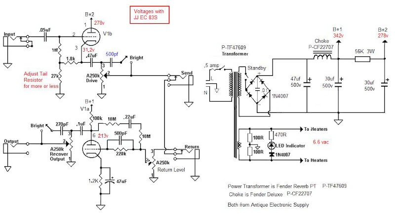

I'm building this active fx loop and am confused by the schematic. The power string is labeled A B C and the connections  to the board are labeled C and D. Thanks for your help.

« Reply #16 on: October 06, 2012, 04:51:22 am »
Yes, I think that was a "cut and paste" error.
"A" is not used, "C" board connection is actually the second node (B) , and "D" board connect is the third node (C).......at least that worked for me.
HTH, G
Re: Active FX loop
« Reply #17 on: October 06, 2012, 06:09:57 am »
Sorry Geezer, I don't think so, the error (if there is one) to me seems to be one other
In the schematic you can see V1a is at 262v and V1b is at 196v
so no accordance with the voltage on the A - B - C points
A = 367v (I agree with you that this isn't used)
B = 295v
C = 262v
So if C = 262v is connected to V1a, to have 196v to be connected to V1b you must have a further "D" point on the supply (that actually is missing)
That only if the voltage reported on V1a & V1b are corrected

Re: Active FX loop
« Reply #18 on: October 06, 2012, 11:20:28 am »
I'm looking at tubenits gutshot and it appears to be as geezer said . Will wait for tubenit to verify. Thanks
Re: Active FX loop
« Reply #19 on: October 06, 2012, 12:34:20 pm »
I agree with you, the only person that can clarify this thing is of course Tubenit
Offline Geezer
  • Posts: 3680
Re: Active FX loop
« Reply #20 on: October 06, 2012, 01:30:04 pm »
The 196v is NOT @ node "C"....it is @ pin 6 (after the 82k plate resistor)
G
Re: Active FX loop
« Reply #21 on: October 06, 2012, 02:06:28 pm »
OK that has sense
Thanks Geezer

  • Posts: 10328
Re: Active FX loop
« Reply #23 on: October 08, 2012, 04:47:26 am »
Geezer's reply 16 is correct.   with respect, Tubenit
