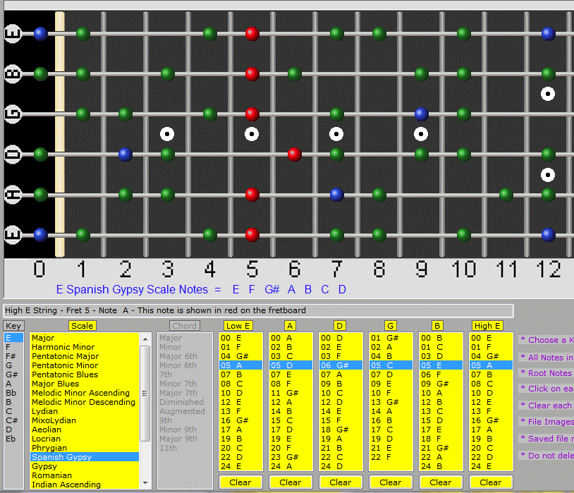

I wrote this Windows program for me personally, but I thought I would share it.
It shows all the notes for scales and chords on a 24 fret guitar neck
You can pick a key, then pick a scale or a chord and the notes show up on the fretboard.
You can then click on any string position and see the notes appear in red on the fretboard.
I added several scales and chords, but I am open to add more of each if they are useful.
Anyone want to give it a whirl?

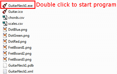

Once you have extracted the file you will see a folder named GuitarNeck1 on your desktop (or where ever you extracted it)
Look in the GuitarNeck1 folder
Double click on GuitarNeck1.exe to start the program
There is an icon file in there also with the same icon as the .exe file (you want the .exe file)

Here's a screen shot showing that I selected the Key of E, Spanish Gypsy scale and then I clicked on the notes you see in red
The blue notes are the Root notes of the Key, which is E in this example

OK,,,I was being a mental midget....
I had the "views' set to large thumbnail, and I was seeing what I thought were just icon files, inside the uncompressed folder
DUH :huh: :embarrassed: :cry:
Got it now  :icon_biggrin:
Thanks again......very cool
  • Posts: 10661
Re: Test my Guitar Scales and Chords program
« Reply #8 on: January 09, 2013, 02:41:51 pm »
Ah ok
You have your file views set so it does not show the extention
.exe, gif, .xls, etc
You can change that easily

From what I believe the E minor(natural) scale to be,,,,this one looks incorrect to me
I think the Eb should be a D
  • Posts: 10661
« Reply #12 on: January 10, 2013, 06:55:34 pm »
I figured out that I needed to rename the minor key to harmonic minor and then it was correct
Try melodic minor descending for the minor key you are thinking of
I am posting a new version in post 1
Changed the minor key name and now the root notes of scales and chords show up as blue dots
Here's a shot of melodic minor descending

The format for each line is
Name of the Chord or Scale.0.1.2.3.4.5.6.7.8.9.10.11
Scale example:
Spanish Gypsy.0.1.4.5.7.8.10
Just think about one string on the guitar
The numbers always start at the root note of 0
Then if the next note in the scale is one fret higher, the next number would be 1
The next fret up is 4 away from the E and so on 5.7.8.10
So for the Spanish Gypsy scale in the key of E the notes would be
0.1.4.5.7.8.10
E, F, G#, A, B, C, D
