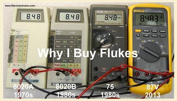

Re: Fluke Meters
« Reply #15 on: September 08, 2013, 02:46:05 pm »

« Reply #16 on: September 09, 2013, 01:24:55 am »
Yup.
I buy Fluke meters because I KNOW I'll never wish I had bought something else.
