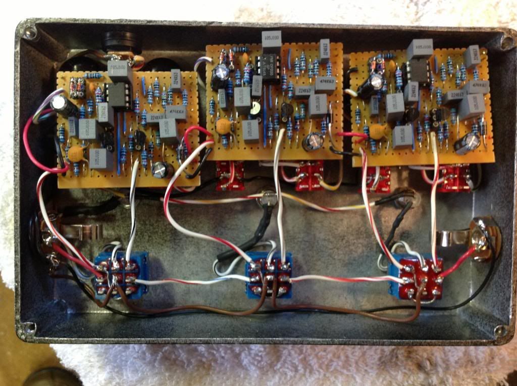

Wanted to try some new pedals, the Paisley Drive being one, but at $200+ each, they're a bit out of my price range. Besides, just ONE of anything (guitar related) is never enough for me.
This video really impressed me, especially starting around 4:00
http://youtube.com/#/watch?feature=related&v=yHmuujRl6OM

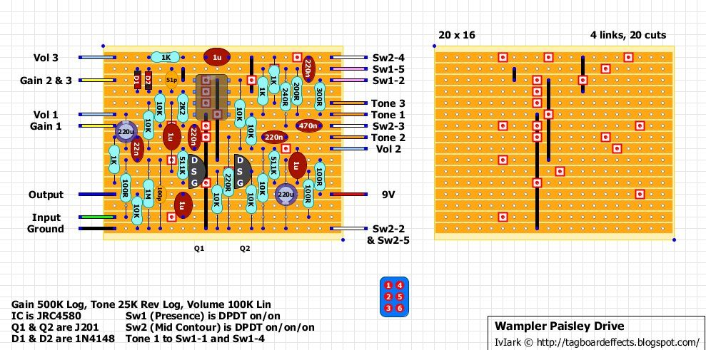

So I found the schematic and vero (stripboard) layout online and built one, or rather, three in one box (1590DD). I had some of the parts already, so out of pocket was only around 60 to 70 bucks (probably even less)
Sounds really, really good...very transparent, and sustains for days. Best OD I've ever used. Doesn't "stack" very well though, so I only use one at a time, but that's all that's needed. I set each one up to be progressively more overdriven, so there are 3 different levels of OD, plus the clean, plus the 2x OD channels on my amp, plus the guitar volume pot, so I have a wide selection of tones and range of overdrive levels to choose from.
Another thing it's really good for is taste testing op-amps (and diodes)....you can load 3x different types, set the controls the same, and immediately hear the difference between them. I have an OP200 in one, an AD712JN in the next, and a JRC4558D in the third. They each give slightly different tones, clarity and touch sensitivity.
Next step is to try different clipping diode types and symmetrical / asymmetrical arrangements.
In the works is a triple ”Timmy"-type OD and a triple Wampler Ecstacy/Euphoria. I really enjoy building these things....it keeps my mind sharp and me out of trouble.  :icon_biggrin:

A few notes if you are going to build one of these:
Use sockets on the clipping diodes (D1/D2), the op amp, and also on the C4 cap.
Being able to sub different types and arrangements of diodes is nice, and the op amps are also good to try....the stock JRC4580 is my least favorite, so I'm glad I had a bunch of other op amps I had picked up off of eBay for cheap to try.
C4 controls the amount of bass/low end/fatness in the OD. The stock 220n (0.22uf) sounded good, but 320n (0.32uf) sounded even better to me, so I paralleled a 0.1uf with the stock 0.22uf cap.

Rather than having three identical pedals in one box, why not try a few different ones ?
If I like a pedal, I like to be able to have "presets" for live performance (so I don't have to reset all the time for different effects), so several of the same effect allows me to do that, plus do individual tweaks to each board for slightly different tones at the stomp of a switch.
If I don't like the pedal after living with it a while, I just gut it & build something else, but I listen to alot of demos of each one I'm considering, so I'm usually right when I think I'll like one and decide to build it.
