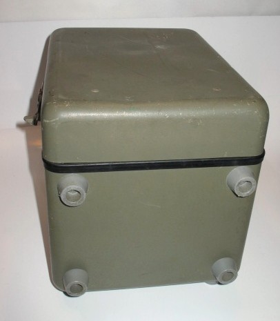

the first is I've an old HP Psophometer instrument I would like to use as cabinet
there the space is reduct, so I was wondering to avoid an excessive heat on it and to use the smaller component I can
My intention will be to try to don't use a fan, use the window of the instrument as a ventilation window and to add some ventilation holes on the bottom of the front panel (the front panel however will be totally or partially rebuild)
so the use of the el95 tubes that are underrated if compared with 6aq5 and can use smaller PT & OT
more, I have a bounch of 6aq5 & 6005W but I've also 4 x el95 tubes in my stock
If the original project can be fit in that cab (at the moment I haven't under hand the exact measure, but I can post it) without heat problems I would like to go with the original plan, only maybe I'll omit the 6x4 rectifir (or not dependings on the PT I can find)

today I opened the instrument as to verify better the disposable space
and I ended that it will be very nice to use a low profile toroidal transformer (those for U1 units) for the PS, if I can find one adequate in voltage
if I use the 0-200v toroidal and a mixed rectifier (2 x 1N4007 diodes + 1 x 6x4 tube) I think the B+ voltage will be in order of 250-260v B+ (don't understand why the simulation kindly done by Pete says 320v ??? may be is due to the disposable current that in this transformer is 100mA against a request of I think 70mA of the circuit with el95 tubes)
more I would like to avoid further heat and so I would prefer not to use the tube rectifier, so a lower AC transformer must be found, I think a 170v will be fine (but difficult to flush out)
