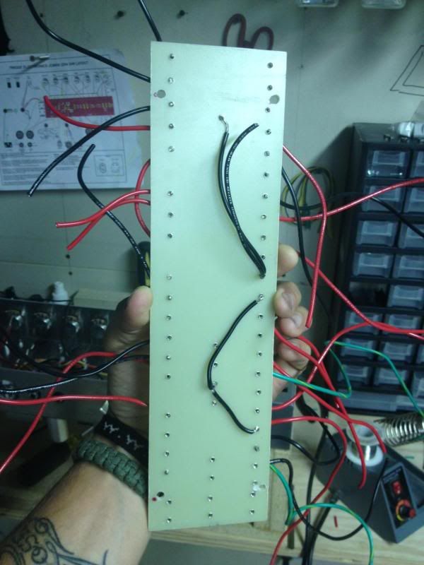

Hi guys. I was hoping to get some thoughts, comments, concerns, critiques, ect. on my first amp build here :)
First off here is my board. A handful of things that I will do different from here on. Since I am a very DIY guy I laid out my board myself. I spaced the turrets too far apart in width on the board. Some of my components BARELY reached from lug to lug. Also I will drill my holes for mounting the board FIRST thing. Before I do any wiring. The turret lugs seem pretty small to me. I got the larger ones from Hoffman. But there is no way I could get some of the wires to go into the tiny hole in the back of the lugs so I had to mount my wires on top of the board instead  :dontknow:
And the hidden wires that are under the board from component to component..... same way. Except one of the wires I mounted on top under the components. So I am definitely looking for ideas to clean up my next board. I mean the 10K 2 watt resistor has THREE wires going into it. I mean I guess I could have put one small wire lead and then soldered the three to it and used heat shrink around that connection. Anyway...here is the board.

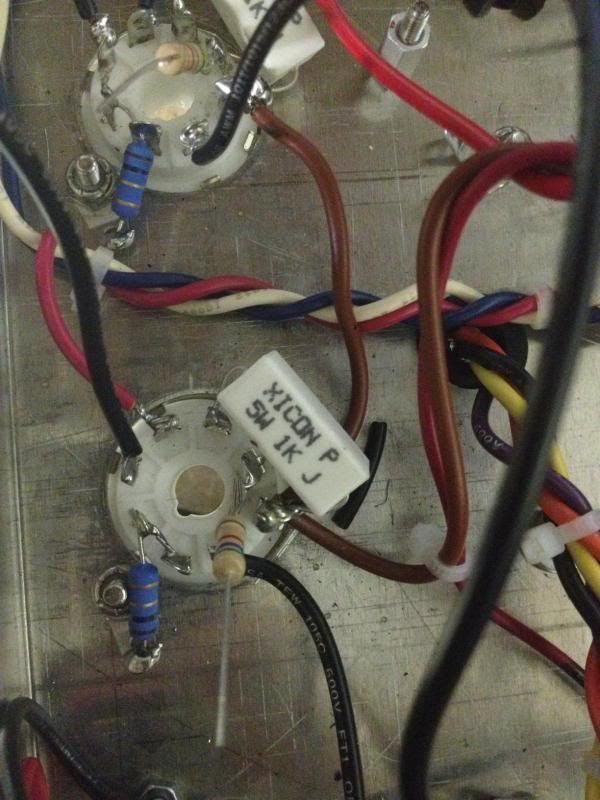

Here is a shot of my power tube wiring. A bit dodgy on some of the soldering leads. I have a broken soldering iron. Need to buy a new one ASAP. But i just have leads on the heater filaments that are not tied in yet. Heater wiring is next. Ill twist the holy crap out out of these  :icon_biggrin:

Some thoughts:

If you want the bends in the res leads to look good, they have to be pre-bent before they drop into the board, and the bends have to be made w/a needlenose pliers (or, a lead-bending tool, an inexpensive plastic thing you can buy if you wish. Point being...there can't be any lead manipulation or bending ON the board....it has to be "pre-bent"...elsewhere, and has to include the radius of the bend. If I make this sound easy, to get a consistent look of the leads...it isn't. There is always some darn thing that makes you depart from the ideal you start with---either 3 resistors going to one turret...or one lead is too thick to poke into the hole, or you have too many leads to fit into the hole.
When soldering, a clean tip is your holy grail. Damp sponge wipe after every few connections, damp sponge wipe if the iron has been sitting for a while in the base. If you really want clean looking joints...it's good to tin the wire and tin the turret before you solder to it. Some will criticize this comment. A solder connection is a capillary event, it is a chemical reaction, and it has mechanical properties. If the wire and turret are pre-tinned, then the chemical reaction (overcoming the oxides on the metals) has already occurred. Try also not to handle the leads of the resistors with your fingers. Sure, the flux in the solder can and will and is meant to overcome that, and it will. But if you want the super shiny look....
Another part is the distance from a joint that your insulation is stripped back. I don't know any shortcut other than massive practice.
You mentioned you were going to install the heater wires...most of us would do this first. Unless of course you are going to do "up in the air" like a Fender. You don't have to go medieval twisting them tightly, in fact, I reco against it. Twist, yes, but if they are too tight, those wires will not look very good when you unravel them to solder to the tube base.
None of this, by the way, affects how the final amp works or even looks from the outside. So...you shouldn't drive yourself nuts, but as you are doing, look to improve. Your first few builds will look like crap.

Turret spacing: about 3/8 inch works well. There is also a spacing grid that you can print out
http://www.el34world.com/Forum/index.php?topic=12317.0
The thread is there.

What gauge is your wire? Seems like you could use a slightly smaller gauge. I'd check all those solder joints. Some look like they could be cold. Hit them with a soldering iron until they are nice and shiny.
