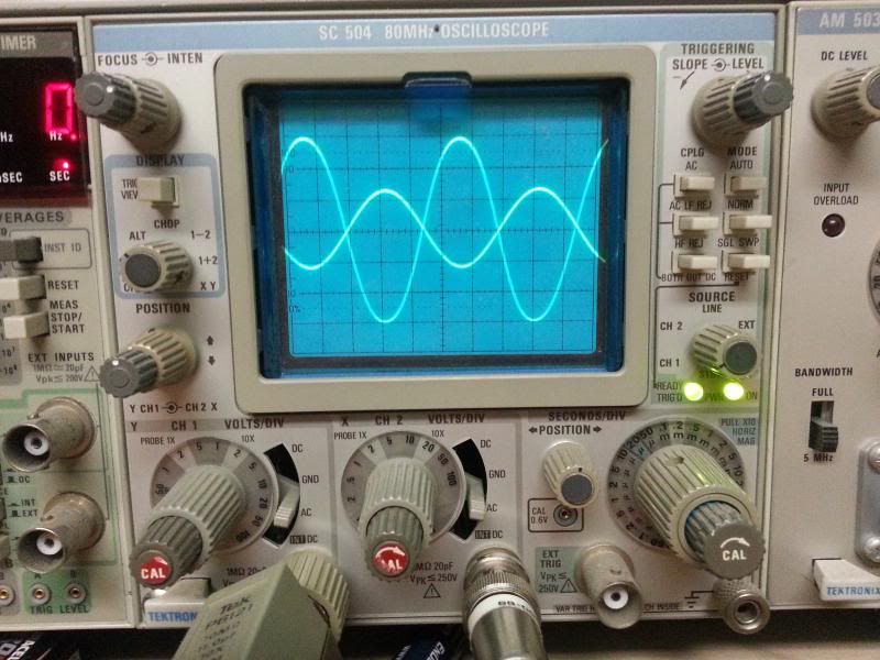

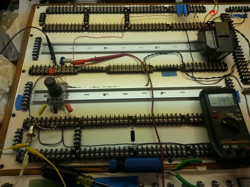

OK, sulzer PI does work with the 6SJ7; kinda_sort_of... the phases are 180o out as expected, however, the output level symmetry is WAaaaY off - about 1:3.2 - the screen output is MUCH hotter then the plate output.
built with the following components & values:
6SJ7 - NOS DuMont.
Ra = 220K
Rsg = 100K
Rgleak = 1M
Rk = 560R
Rtail = 22K
Cbyp = 47uF @ 63V
Cin .1uF @ 200V
Cc .022uF 400V
all measurements referenced to ground at idle and no input signal:
Line 110V
B+ ~ 335V
vk ~ 52V
va ~ 315V
vsg ~ 115V
vr-k ~ 1.31V
Vin is 1Vpk to CH1 of the scope (lower trace) CH1 is the triggering source for CH2.
Vout screen ~8Vpk
Vout anode ~2.5Vpk
anode output - using 10X probe 1V/div:
screen grid output - using 10X probe 2V/div:
as built:
perhaps what we are needing is a higher gm tube after all. i suspect the higher slope valve probably has a larger space charge for the plate to draw from so the outputs would have greater symmetry than what i'm observing with the 6SJ7. sulzer mentions in his article that the symmetry is tuned by adjustments to the anode resistor value and not the screen resistor value since altering the screen resistor changes the symmetry of both outputs. oh well...the road to hell...

Your anode signal is in phase with the control grid signal??? Man, that's messing me up. You don't have an invert button pushed somewhere do you?    :w2:
Re: unusual phase invertor?
« Reply #52 on: August 10, 2013, 08:06:44 am »
IN THE NORMAL METHOD of operation a single-stage amplifier will produce a phase reversal between the input and output voltages. Pentodes when operated in this way have a screen-grid voltage supplied by a source with a very low internal impedance. It is known that the screen-grid supply impedance will produce a degenerative effect, decreasing the gain of the amplifier.'  Further study has indicated that this effect might be increased to the point where the amplifier gain would he zero, and that a still greater increase in screen-supply impedance would cause the amplifier gain to increase from zero, but with opposite phase.
so what mr. sulzer is saying is: if you move the supressor grid and connect it to ground, add enough impedance to the screen supply, you've manipulated the behavior of the space charge between the elements so that the plate phase will follow the phase of the control-grid and the screen grid will then act similar to a conventional amplifier and invert phase. so now one has a single tube phase-inverter with gain...OK, so what's so wrong with a CC stage coupled to a concertina? it's a single tube PI with gain... in fact, more gain than the pentode PI mr. sulzer presents.
                 Brad      :dontknow:

Yeah, it's backwards alright. I think your right if it was a good PI it would have been used years ago in production.
More than 1 way to skin a cat but some are much easer than others. I think it's a throw away, like you said round file can.
Cool. I also like your board setup.
That's what the 1948 article claimed. With a way-negative G3, and substantial resistance to G2, *part* of the plate curve runs backward. See image from 1948 article, attached. Red-arrow is the range over which the plate "works backward".
Article says to trim the plate resistor. Trimming Rg2 upsets the backward action and you'll get messed-up. Plate voltage should have nearly no effect on current division, so a larger plate resistor should directly give larger plate output.
Though also, because plate curve is so curved, a lesser G1 bias (higher cathode current) looks-like it will shift the action into a steeper plate slope. Repeating the point that this seems to be mighty sensitve to bias.

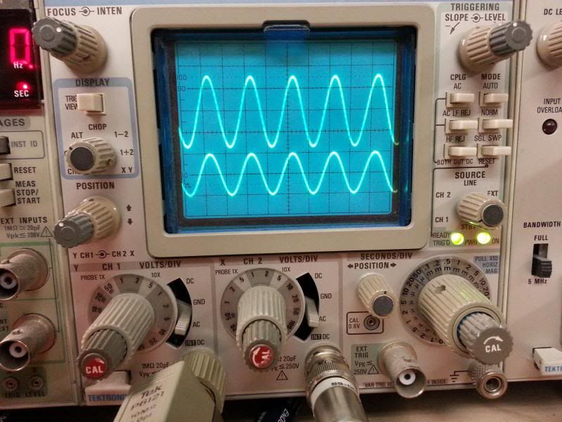

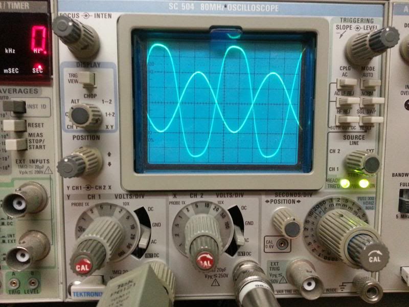

ok, so 6SJ7 can be made to work... not one to throw it all in so easily, i decided to give our lovable 6SJ7 another shot at the "will work as weirdest PI" title. he shone like a diamond; here's what you have to do:
Ra = Rg2 = 220K
Rk = 330R
Rtail = 22K
Rgridleak = 1M
Cc = .022uF
Cin = .1uF
all measurements ref. to ground @ 110V line, except vr-k measurement:
B+ = 345V
va = 275V
vg2 = 77V
vk = 34.1V
vr-k = .51V
so then AV ~ 15. not too shabby i guess. with this new information, it would seem that with lower gm tubes the source impedance of the screen supply needs to be raised. does that make sense?
i have not over-driven it or seen what the outputs will look like loaded [there are no load resistors attached to the output coupling caps; Rload is basically infinity]. that's next.
10x probe in CH1 (1Vpk in); 10X probe in CH2; CH2 trigger source is CH1.
this pic - Va out is upper trace @ 5V/div:
this pic - Vsg out is upper trace @ 5V/div

The 6SJ7 works much better than the 6AC7, but not with the values that DL used, in fact, they are no where close... The most notable change is the cathode bypass capacitor, it has to be eliminated, otherwise the plate and screen voltages are always in phase - it also results in a much lower gain for the PI.
I am using Steve Bench's code for the suppressor, with his caveat: "Suppressor grid effect is a rough approximation only!", so WYSIWYG... The whole exercise merely shows that the Sulzer PI works, but I doubt many would use it...
Vin=8Vpk, pentode: v(6), screen: v(7)

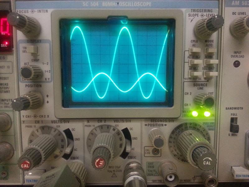

a pentode long-tail phase inverter... not exactly an unusual topology, but unusual for me to hack on a pentode version.
2 x 6SJ7 pentodes. why? because we can...as if we need a reason.   :icon_biggrin:

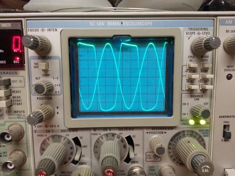

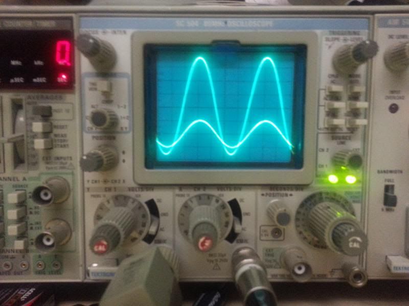

had some time to fiddle with the pentode LTPI. pics below. swept it from 20Hz to 15KHz - reasonably flat.
pic of inv. output right at onset of distortion.
CH1 is 10x probe 2V/div; CH2 is 10x probe 20V/div. input freq. is 1KHz
CH2 triggered off CH1
~118Vpk out  with ~4.8Vpk in
pic of non-inv. output at onset of distortion.
~112Vpk out with 4.8Vpk in
pic of inv. output driven to moderate distortion.
same scope settings.
pic of non-inv. output also driven to moderate distortion.
pic of inv. output driven to heavy distortion.
same scope settings - notice max output is well over 150Vpk at this point...
pic of non-inv. output driven to heavy distortion.
not too shabby driving a 100K load...next i need to tune out the imbalance - it's worse than i originally estimated; shooting from the hip and counting graticules on thumbs - around 5%
moving on to building something around this... on the breadboard for now, of course! :-)

Nice breadboard DummyLoad.
  • Posts: 4459
« Reply #75 on: August 14, 2013, 04:59:08 am »
Have you tried it with unbypassed screens?
« Reply #76 on: August 14, 2013, 11:56:56 am »
bill, thank you.
« Reply #77 on: August 14, 2013, 12:03:43 pm »
i have not. why would we want to run with screens not bypassed?
  • Posts: 4459
« Reply #78 on: August 14, 2013, 01:14:17 pm »
To explore the effect of screen compression in a pentode LTP
Offline printer2
  • Posts: 243
« Reply #79 on: August 14, 2013, 05:19:11 pm »
I recall someone saying with both screens tied together you may not need a capacitor or much of one for AC. Either way, a dual pot may be fun.
« Reply #80 on: August 14, 2013, 10:31:43 pm »
Pentode LTP should have common screen resistor, unbypassed.
If that's not balanced enuff, add a pentode current-source for the tail.
« Reply #81 on: August 14, 2013, 10:45:07 pm »
is there a reason why? improved performance? seems to work well as i have designed.
thought about using a triode CCS... just to counter-point.
« Reply #82 on: August 14, 2013, 11:41:40 pm »
> reason why?
Cheaper/cleaner.
No LF pole.
Improves balance.
« Reply #83 on: August 15, 2013, 02:21:20 am »
> reason why?
Cheaper/cleaner.
No LF pole.
Improves balance.
cheaper - absolutely.
cleaner - didn't run disto analyzer. i can't see 2% thd much less 5% thd on scope and you haven't steered us wrong yet.
no LF pole as you state. won't large(r) bypass caps negate effects of LF pole?
balance is better - SWAG with tired eyes, i'd say well within 2% just correlating the traces.
around 15-20% less gain though. with 4Vpk input yields about 80Vpk output and that is right at the edge where i can see the wave starting to distort on my scope.
maximum output with gross distortion is about 110Vpk.
as always, thank you for sharing your knowledge and time!
recorded results are with the following values:
i took pics but too tired to post them. it's been a loooong day at work.
Ra1 100K
Ra2 100K
Rsg  470K
Rk  560R
Rtail 22K
Cc .047u
Cin .022u
B+ 380V
Va1 262V
Va2 280V
Vtail 58V
Vk 59.4V
Vsg 102V
