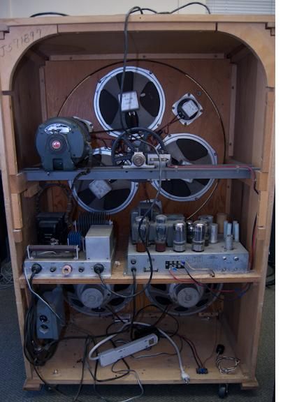

And here is today's victim.
This is a rotary speaker, but not a Leslie. I have never seen this one before. Note how there is a spinning disk with three actual speakers mounted on it (!!)
Well, unless I miss my guess, the amp on the right, at 3 o'clock has a pair of 5U4 bowling pins, meaning, it is prolly a 100-watter, like an early Twin. And then I see 2 qty 6550's, with those metal bases. And they are flat sided, so they are prolly newer than the device itself. Not only that, but the claim is that the amp is a Webster something or other, which is a semi-desirable item, and with those tubes, pretty easily salable for $350 on fleabay. So the asking price is $200 which is worth it on its face, but if I can snag it for $175 or $180, then ....???
Anybody know what this is in terms of manufacturer?
Ed: and YES I WILL ask the owner if he has the old 6550's!

What the heck?     :laugh:
Look at the size of the motor that spins the speakers. What are the cab measurements?  ~4"x4"x5"?
What size are the 5 speakers, 12"?
What's the motor say for horse power and RPM?
How about a picture of the front face?

Did a search on flea bay and found 1 that's a different model. Must be a SS as it has no tubes and only 2 speakers that spin. $750.
Do a search for this on flea bay:
Circa 1972 Allen Organ Rotary Speaker Cabinet
         Brad     :icon_biggrin:

Gawd help you if the speakers become unbalanced...it'd walk across the room like a washing machine. (Very good grunge rock effect)  :l2:
Well, anyone can ask any price for anything. I just know the asking price is below the parts value. it's prolly about as big as a normal Leslie. I say, once you're gonna blow 30 bucks worth of gas in the truck to buy something completely silly, you might as well get yer money's worth!
The 1 I posted a search for already is unbalanced courtesy of the factory.   :laugh:
If you eat some of those funny mushrooms right before you go to a grunge show you'd think the thing was coming to kill you with all that noisy/ratty distortion and screaming going on.    :l2:
You'd think he would have weighed 1 of the speakers and glued or bolted a weight where the 3rd speaker should be to keep it balanced.
Let us know how it sounds when you get it.
On a real Leslie, the 15" baffle and also the cab itself, with the slits in it have a big impact on the sound. Lots of sound bouncing around in there, acts like a multi filter at different frequencies.
I wonder how this other design compares in sound to the Leslie?
I also wonder how their controlling the speed and what the speed(s) are?
And yeah, sounds like a good deal for your friend if he goes close to that area anyway.
