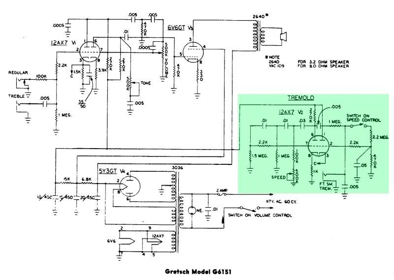

I have an old Gretsch 6150T in my shop. Re-tubing. Couple little small things. I think I'm going to clone this thing just for the hell of it. Its small and incredibly simple. I just had a question. I don't think I need the Tremolo. But I'm not sure how to cut it out. Is the whole 12ax7 being used by the tremolo or do we have some additional tone shaping going on in this 12ax7 unrelated to tremolo.

You should be able to eliminate everything highlighted in green. Since you have the amp in hand, just pull V2 to check it out. Pulling V2 will simulate removing everything that is highlighted.

Maybe I'm experiencing a form of cognitive blindness, but I can't find an output from the LFO that goes anywhere useful.  Unless it's just making B+ sag for V1.  What am I missing?

I had to look, too. Sneaky. The left hook "C" coming off pin 3, 2nd K of the LFO, goes back to a cathode on the preamp, pin 3 of V1.

Ah, see it now.  Thanks.  Agree with other posters that eliding everything in green should do the trick.

I have a feeling the trem buffer leaks DC current through path "C" into V1a, and is a part of V1A's bias. Rough guess is that the "1.5K" under V1a could be changed to 2.2K or 2.7K for a better copy. If you have a working amp in hand, note V1a voltages (including the B+ node, since relative ratios are more important than exact voltages) and fiddle the clone for similar bias.
Ah, and the trem tube loads the 15K in the B+ filter, so without it the 15K might better be 22K or so.
But I don't think it will make-or-break the clone to use the 1.5K/15K values.
