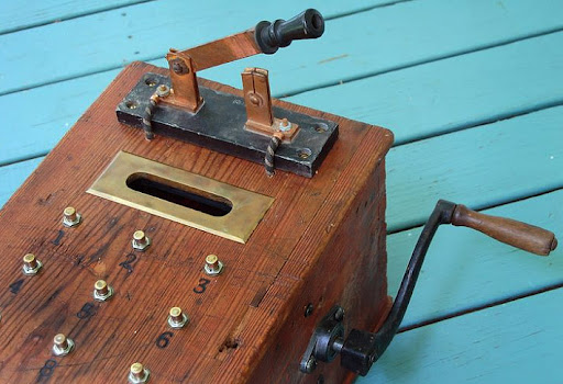

A pair of years ago, for my job, I visited an old house
well, in the garret there was (and was still connected to the line) a switch like this
and you must pay a lot of attention when in the darkness you want to turn on the light  :icon_biggrin:
