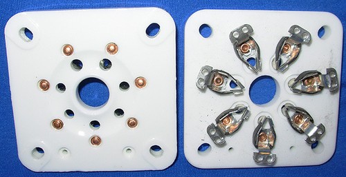

Not so far from GU50 Tank Sockets  :icon_biggrin:

These big SE amps are fun to think about. A couple of guys here actually built one on the breadboard. One is a professional house/factory Electrician, knows the dangers and how to reduce the risk of electrocution and fire. However I think "Real Life" got in the way of finishing the work.
http://el34world.com/Forum/index.php?topic=10262.msg93751
« Last Edit: May 08, 2014, 12:30:05 am by PRR »
  • Posts: 7953
Hi PRR  :thumbsup: :thumbsup: :thumbsup:
just a curiosity, which is the socket type name ?
it is similar to UX7 (that fits 1625)
but seems much more larger
EDIT: Is an U7G socket ?
« Last Edit: May 08, 2014, 10:29:24 pm by kagliostro »
