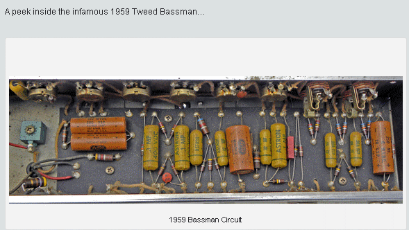

Hi ,
Did Fender use Allen Bradley resistors in 1960?
I have a Vibrasonic that looks like its had ALL the resistors replaced with ABs. The joints look reworked and one of the Rs has the wrong value, 4k7 instead of 470k, which resulted in excessive chuffing on the output from the vibrato mix circuit.
Cheers, VB

Allen Bradley was only one brand who made carbon comp resistors when that amp was made.
I'm not familiar enough with carbon comp resistors to be able to distinguish between various brands made in the old days (new Xicon carbon comps are visibly different). Fender likely used whatever was cheapest in big quantity.
I know there used to be an electronics wholesaler near me when I lived in Nashville. They had open bins full of a given value of resistor, and all varieties of carbon comps might end up in the "100kΩ carbon comp bin".
Using "Allen Bradley" probably confers no special advantage, except that the leads might be longer than new carbon comps, and the background brown color on the resistor body is darker. A-B also had these in production until 1997, so they might have been easier to source.

« Reply #2 on: April 23, 2014, 10:11:01 am »
Hello again HBP,
Take your point about whatever was cheap....  :wink:
NOS ABs that I bought recently are identical in every way to the ones in this amp. size, body colour, paint colours. One other reason to think that all the resistors had been replaced.
Cheers, VB
What else would they use?
Yes, there were other brands. But A-B was very dominant in development, marketing, advertising, distribution, and military qualification. Their volume meant low costs. So other brands had to be significantly cheaper (in price and quality). You find these in $9.98 radios. Maybe in some Fenders? But it would not take much trouble with "the other brand" to make Leo go to all A-B. (CBS days may be different.)
