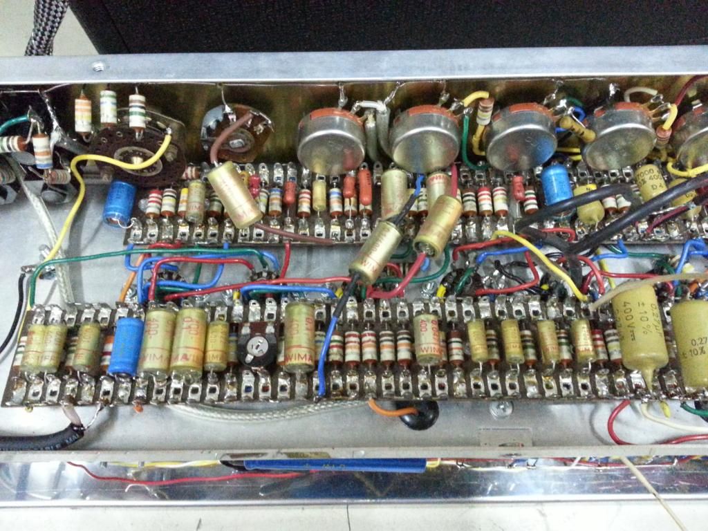

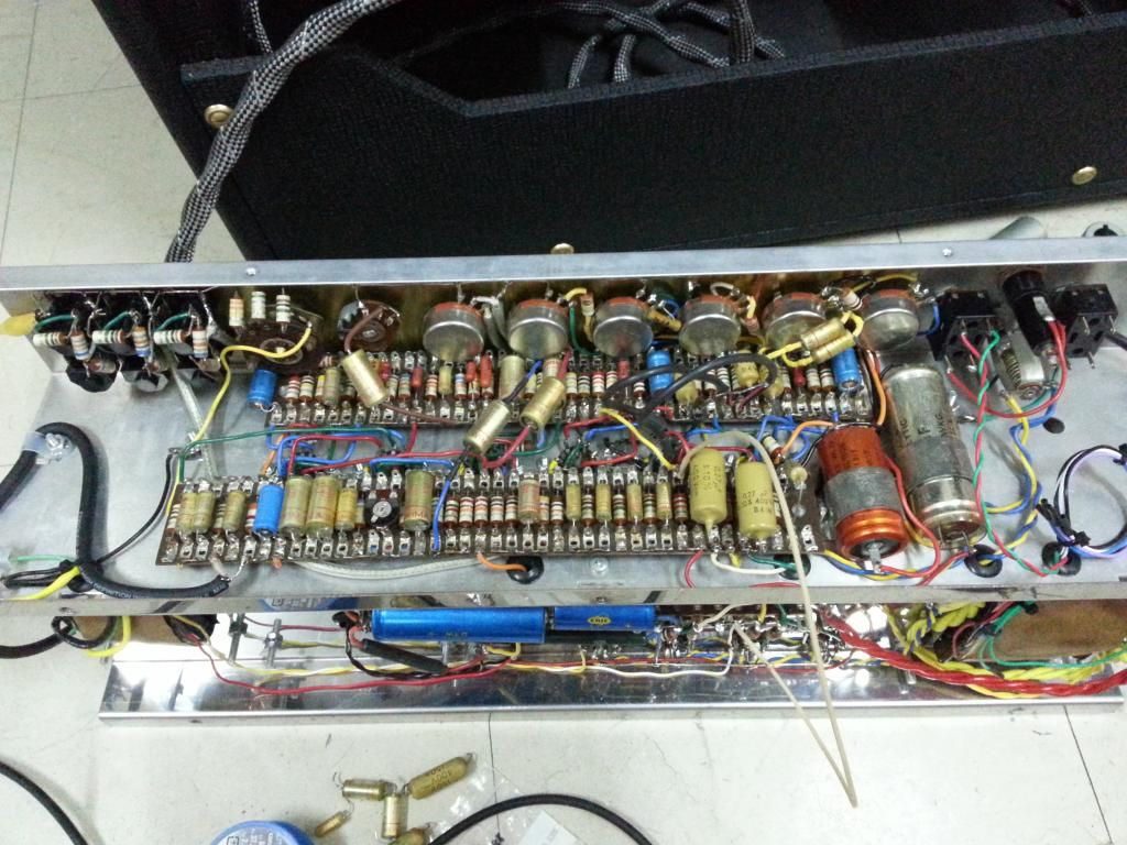

« Reply #74 on: November 18, 2014, 09:11:06 am »
HI
i spent whole day to fix my ac30 today.
i did follow
1. add shield cable to PI tube grid pin.
2. try another wire for cut control.
3. changed PI capacitor
4. changed 47ohm bias resistor to 100ohm
5. add shield wire for brilliant pot to top boost tube pin2
6. try to increase main filter cap from 16+16uf to 32+32uf
7. try to change all filter cap.
but all don't help. how should i do ?
i just want to fix (if i turn the brilliant vol pot over 2:00 or 3:00, will have hum). i think it is 50hz hum.
i try to pull PI tube. so it is no hum even i turn brilliant vol pot to max. and i pull top boost tube. it is also no hum even i turn brilliant vol pot to max. when i try to pull other preamp tube. all have hum .
