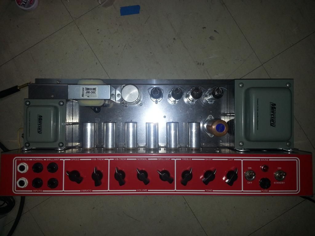

i plan to build ac30. i bought the weber 6v30 kit. but i am confuse. weber layout look like little different with vintage ac30. and ac30 have many version. some is 5 preamp tube, some is 6 preamp tube.
and i want to build top boost version. but it seem have few top boost version. i just find 2 ac30 layout only.
can anyone give me some suggestion?
and i want to know where can i buy the ac30 trem and speed pots. it look like special.
thanks

i built fender and marshall amp. but this ac30 is very difficult for me. very difficult to find the parts and layout
and i don't understand why weber ac30 layout is quit different. for example, weber suggest use 1M pot for speed and vib, but i can't find any pot 1M with switch.

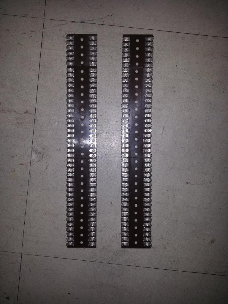

i don't need 1M pot with switch if i follow the layout which you sent to me, right?
and i really don't understand , even the ac30 ptp board, i can't find it.
i just find this small piece board, and i cut it and glue it.
and i am still finding correct ac30 inductor light, resistor etc........... do anyone know where can i buy it?
« Last Edit: June 09, 2014, 01:29:32 pm by EL34 »

my wrong. the top boost treble and bass pot must 1MA, i see a wrong thing in your file. the file say it is 500k for the trimmer which on the board.
and weber don't have any instruction , just layout and schematic. but i compare weber layout and the vintage ac30. it looks different .
do you mind to take a look. i am newbie of ac30. ac30 looks like have a lot of version.
  • Posts: 7907
Re: ac30 layout
« Reply #25 on: June 11, 2014, 02:40:02 am »
Hi kwm488
I think EL34 would like to have an answer to the question he put
As I told, some years ago, I compared the AC30 schematic with the 6v30 schematic and they were pretty close if not the same
however Weber layout is a bit different from Vox layout, I don't know if Weber do that for particular reasons, but so it is

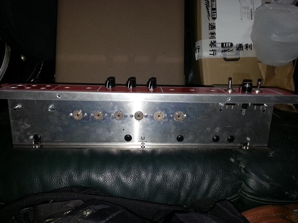

honestly, i have big problem about building ac30 now. i need to order a ac30 combo cab. do you know who can make a raw ac30 combo cab?
the worse case will be, i make it by myself. do you have any instruction or information about ac30 cab? vintage ac30 use Baltic Birch Plywood , right?
thanks
  • Posts: 7907
Re: ac30 layout
« Reply #27 on: June 19, 2014, 02:06:55 am »
I'm not a wood expert, however

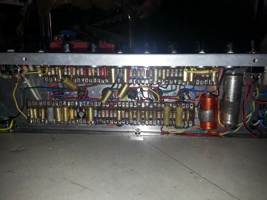

hi
do anyone can teach me?
why ac30 heater is short to the ground.
please see the photo
  • Posts: 7907
Re: ac30 layout
« Reply #39 on: August 25, 2014, 05:27:08 pm »
Don't look to that layout, a guy in an italian forum build an amp following that layout and found some mistakes on it that must be corrected
May be (you must control it) version 7 is correct, but version 5 isn't
EDIT: I revised that connection with the layout draw by Stephen Grosvenor in 2005 and effectively seems correct, however my council is to don't
use that connection at all
« Last Edit: August 25, 2014, 06:21:32 pm by kagliostro »

hi
my amp is almost finish.
just need to wire the rest of power section wire and double check. hope no any error

hi
thank you for your suggestion.
btw, i wired my amp all wire. and the amp is sound great.
my MM PT have heater CT. i try to remove the pin 4 5 to ground, and ground PT heater CT. but sound changed after i do it. i don't like it. so i use back the vintage vox method.
about capacitor , i try to use sozo for my marshall superlead. and i change it to vintage mustard finally. i can say vintage capacitor sound much much more better.
btw, do anyone have vintage wima TFF 0.047uf 400v and durolit 0.15uf 630v for sell? i want to buy it
thanks

hi
i finished my ac30 clone. i think it is perfect. but when i dial the brilliant over half level, i get white noise.
is this normal? because i never own vintage ac30. and some people said that vintage ac30 have a lot of hum because their design have problem.
i don't sure , do anyone mind to help me?
and i 100% follow vintage ac30 to clone it. i used vintage wima caps, vintage erie resistor, vintage made in england filter caps. vintage made in england wire.
  i finish my ac30 clone. but i have white noise, is it normal Post height=9by kwm488 on Wed Sep 03, 2014 3:28 am
hi
and the video link is here.
http://youtu.be/L33txJtSDtw
thanks

Re: ac30 layout
« Reply #48 on: September 02, 2014, 04:11:51 pm »
I cannot seem to find the actual schematic you used posted.  Did you use shielded wire for the wiper of the Brilliance pot and ground on lug 3 of the pot?  Does it change when chopsticking?  If it does, you can do something about it.  I can't really tell how loud it is, but I usually go by the simple rule on floor noise.
The Brilliance circuit is different in your build than my AC15 and I cannot seem to find a readable schematic, but I would simply turn it up and poke around to see if I can find something that makes it change and address this if you find something.
BTW, great looking build!

« Reply #49 on: September 03, 2014, 02:02:56 am »
For the electrolytic caps, did you use new ones or vintage ones? Using used electrolytic caps isn't a good idea as those type of caps go bad with time, and go bad even quicker if they are not used. Using bad electrolytics could cause possible problems with the amp.
AC30's do not use a negative feedback loop so as the volume is turned up they will be louder than a typical Fender amp in comparison when considering the background noise and hiss. An AC30 wired like the vintage ones as far as the heater connection will also exhibit more background hum than an amp wired with an artificial center tap on the heaters.
Greg
