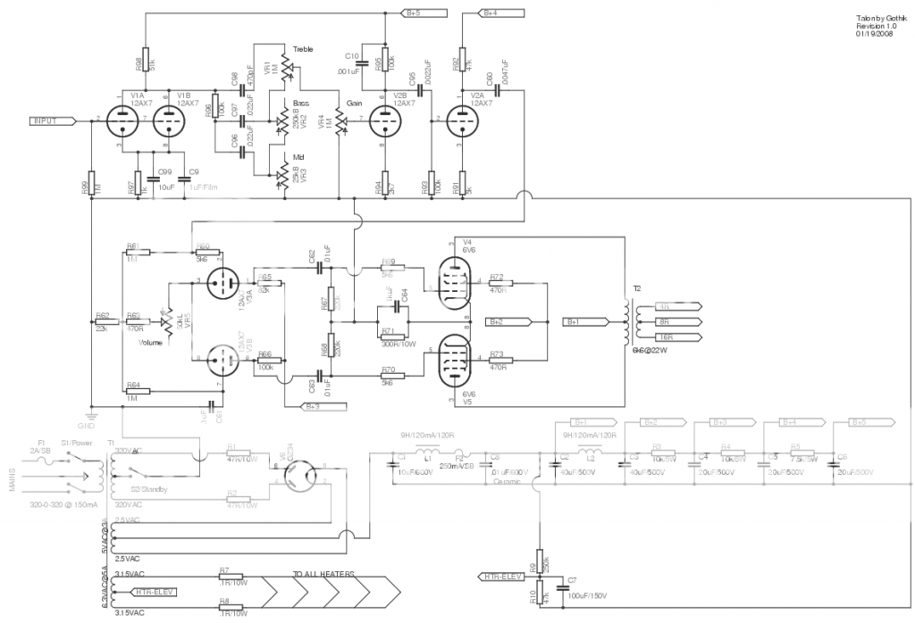

Here's the schematic and tranny layout of the amp where I first saw the problem:
I saw a 120Hz ripple start to appear on the scope at just over half power into a resistive load. You can hear the hum start to develop pretty easily if you crank it through an attenuator.
The heaters are elevated 70V in this design (with 120V AC mains input).
It went away completely when I substituted a small shielded Hammond 6.3VAC/4ACT filament tranny, so that's what I've done on all my amps since.
My newest 2x6V6 amp is using a 372FX PT, and it is cool and quiet.
