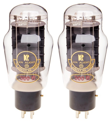

I would definitely suggest against making 300B monoblocks. Those tubes are way overpriced:
