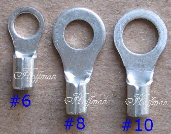

Use these ring terminals
#8's for most tranny bolts
They are on this page
http://hoffmanamps.com/MyStore/catalog/parts19.htm

Any bolt through chassis with Doug's ring terminals can work well. I put a lock washer between chassis and ring terminal and on the opposite side of chassis. Sand around holes in chassis, both sides, and clean with alcohol. Can't have too good a ground connection.
