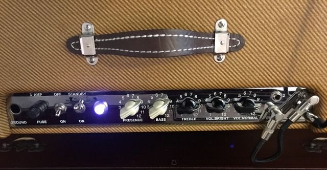

Anyone have a good idea on what I can use the usless ground switch for? I'm Having a faceplate made after I measure it all out and I have two choices, just not have hole made for new plate or add a mod and have it labeled for that
Offline supro66
  • Posts: 525
Re: Spin Off of 2015 list (5E9-A) Im gonna build the 5G9 instead
« Reply #229 on: March 17, 2015, 12:29:26 pm »
A stand by switch for the high voltage shut off save the tubes  :dontknow:

« Reply #230 on: March 17, 2015, 12:31:31 pm »
i already have that.I am using the 5E5A chassis from mojo

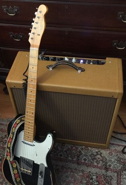

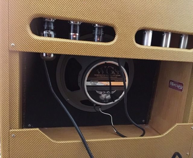

« Reply #231 on: March 17, 2015, 04:22:33 pm »
Last night I had to work and assist the signage company with all our FDNY signs and the owner turned out to be a cool dude from my old neighborhood. All his equipment is state of the art CAD, CNC laser, UV.......... You get my point. I started talking about music and told him I was building another amp but needed a faceplate. I showed him the amp, I showed him Sluckey's AC 15 faceplate and the rest is history. I just need to do all measures and give him the drawing, pick my material and if I want engraving or laser jet printing. I'm hoping it turns out nice and maybe give you guys a option on faceplates, if he's willing to do the service
« Reply #232 on: March 17, 2015, 04:36:04 pm »
Cool.   :icon_biggrin:

« Reply #238 on: October 15, 2015, 07:17:22 pm »
Here she is at 98% finished. tons of head room so I might go with a smaller wattage speaker to break up earlier, this on is rated around 60watts. I will put the foot switch in where the ground switch goes, I used two creme chicken heads where the speed & depth are cause I ran out of black ones but I kind a like it. Where can I get those paper tube charts from so I can make it offcial :icon_biggrin:
