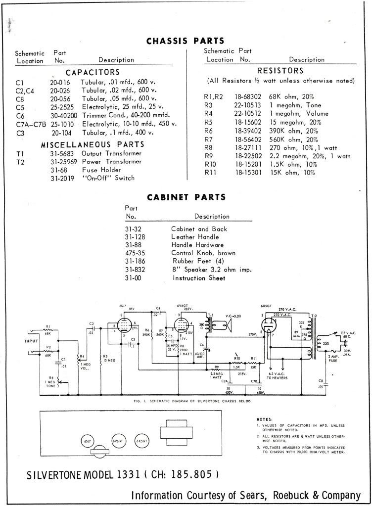

I've got a Silvertone 1391 that just has no power and sounds really distorted.   I've basically replaced everything but about 3 resistors because it was so roached on the inside.  However it still has no power and really distorted.
To top it off there isn't really any schematics for the thing.  The closest you can get is the attached 1431 which is very close, but not exact.  It does however have the same tube configuration.  I've tried  a different 6V6 but not the other tubes because i don't have any replacements to try.  It's almost has to be a tube since virtually everything except the pots and a couple resistors have been swapped, rite?

I found a thread about this amp with pics  http://www.thegearpage.net/board/showthread.php?t=344845
and they say the 1331 is very similar to this amp.
  • Posts: 3226
Re: Silvertone 1391 w/no power
« Reply #7 on: March 12, 2015, 11:29:08 am »
BTW Doug - it would be nice to replace the blurry Silvertone 1331 image in the schematics library with a copy of this one.

> Are you sure the plate resistor for the 6AU6 is supposed to be 330K? That seems awfully high.
It has to be high. You can barely get enough gain with one pentode into a power tube. If we need 8V rms at the 6V6 grid, and pentode gave gain of 100, this is 80mV input sensitivity. We want closer to 20mV. So the impedances are raised until stray capacitance sucks-off the treble.
Read the Resistance-Coupled Amplifier Charts (500KB PDF). 6AU6 is Chart 2. It shows plate-loads up to 1Meg. We are really limited by 6V6 G1 resistor must be under 500K. Using 180V with 0.47Meg and 0.47Meg, we can get gain about 190. Note that restricted to 0.5Meg on 6V65 G1, gain falls a trace from Rp=0.22Meg to Rp=0.47Meg. Actual results will differ because Silvertone used grid-leak bias (which may be why they used a different Rg2), and our voltage is not on the table (and in this case it matters somewhat). 330Meg is certainly in-the-zone.
> 6AU6 plate voltage is extremely low.
1.2V is certainly wrong.
Pull the 6AU6 and see that plate voltage shoots up near B+. If not, replace that 330K or inspect solder joints. Then replace 6AU6-- it is still cheap.
