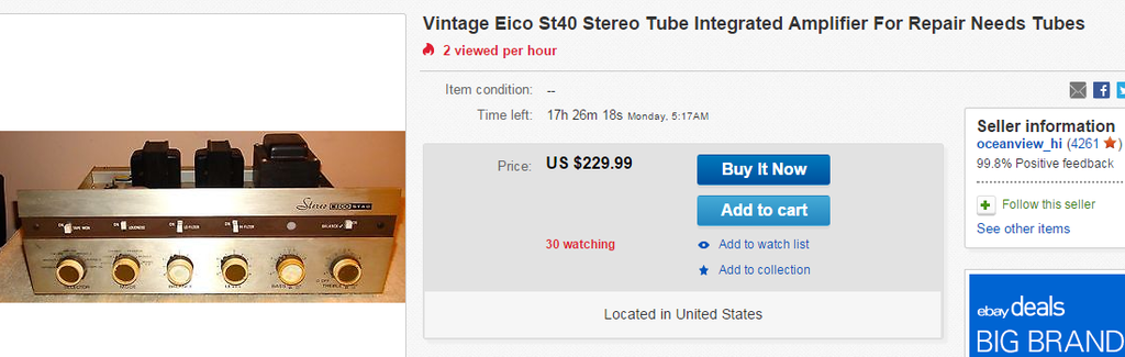

Re: HiFi for some dudes at work
« Reply #8 on: March 22, 2015, 02:02:38 pm »
Very decent, you could hardly buy the trannies for that much. That's not to say you couldn't get such a thing for $25 at a garage sale, too.
That particular seller, oceanview_hi has loads of these things all the time. In a lesser-desired brand than EICO, you might do better.
Link: (which will expire at some point) http://www.ebay.com/itm/Vintage-Eico-St40-Stereo-Tube-Integrated-Amplifier-For-Repair-Needs-Tubes/161609691506?_trksid=p2047675.c100009.m1982&_trkparms=aid%3D777000%26algo%3DABA.MBE%26ao%3D1%26asc%3D20131227121020%26meid%3Da6663118cc724ce3989dbc03f4187841%26pid%3D100009%26rk%3D1%26rkt%3D1%26sd%3D121593424630
