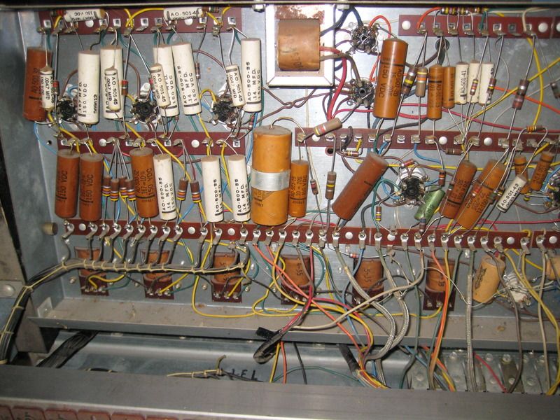

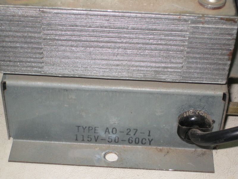

There isn't a Major AO designation, the separate sub-assemblies have AO designations. The power pack is AO-27-1. The Generator Assy. is AO-30-1, and the Oscillator Assy. is AO-20-2. that's what I've located so far. The whole organ designation is S-C-6ELA.  Some pics of internals. The first pic is inside the osc. assy., the next are of the generator internals. It's funny the organ is rated at 117V, but the power transformer has 115V stamped on it.

What I like is that Hammond has left the lead length nice and long on the majority of the resistors, making them easy to reuse if in spec.

My thought is if the resistors are AB's then they might be good for something. They sure are colorful. LOL The tube complement is:

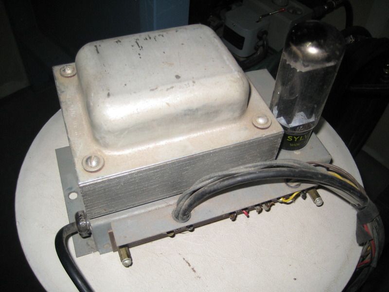

Here's the power pack.  It's pretty much just the PT and 5U4 rectifier. It appears that at some time in the past someone replaced the power cord.

You'll most likely find that those caps are all rated 200 volts (I seem to see 150 volts on many of them) and thus should not be used in anything Fenderish. I see the 12AU7 organ curse is in effect.
