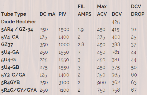

5R4GA drops 17-23 volts more than a 5U4,   and to me that is considerable when running 20-30 volts over what 6V6's like to see. I'm concerned with the power tube longevity. Some people aren't.

Thanks, but I'm still confused about the choice for rectifier tube.  :w2:
So I've done some research....
The Hoffman PR design calls for a 5U4G,
The Fender 1964 design for the AA1164 called for a 5U4GB,
but then they replaced it with a GZ34/5AR4 using the same power transformer.  :dontknow:
Would you guys agree with this quote? - " Any amp that uses a 5U4GB as OEM, can easily go to the 5AR4/GZ34. It's a drop-in replacement. Now, which rectifier is "better," depends on amp, speaker(s), and what tone you are after. The GZ34/5AR4 has a higher B+ potential and less forward voltage drop (10-15VDC) = stiffer tone. Better bass, better transients.
The 5U4GB usually has 10-20VDC less final B+ in the same amp. Much more forward voltage drop (30-40VDC). Makes for more sag in the tone. A bit more "slow quality" to the transients. Some ppl like this in certain amps. Esp those with very efficient speakers, who are looking of a more Bluesy tone.
Then, there is this guy who says the GZ34 is better and should not be swapped with a 5U4 ...

As Uncle Doug says, the AA764 (july 1964) had a GZ34 in it. That predates the AA1164 circuit. And according to Doug and many others I've read the PR used either tube until '69' or '70.  My 1979 Fender PR uses a 5U4GB in it from the factory.
I think it's important to pay attention to plate voltages on the 6V6's. If you pop a GZ34 in there and the result is 500V of plate voltage it is not a good thing.
A lot of people will tell you that modern tubes can take that abuse, but is it really a good idea? That's why I was talking about tube longevity. Even though a modern 6V6 , or a vintage one for that matter, can take the high plate voltage, it comes at a cost. And that cost is how long it lasts.
Of course cork sniffers might say that the tube will sound better and have much more headroom for certain types of music genres. Well that's OK. Run it like that and replace your tubes more often, if you got the bux it ain't a biggie.
On the other hand, I feel that the 6V6 tube is more suited for plate voltages of 390-430. I like the sound and feel of them at this level. Especially in my PRs.
Will any of these rectifiers work, and work well. Yes.   So it really is personal preference.

I am running an old Amprex 5AR4 in my PR (Hoffman).... 410v on the plates, no issues what so ever.

Some PR AA1164s call for a 5U4...
http://el34world.com/charts/Schematics/files/fender/Fender_PRINCETON_REVERB_AA1164.pdf
Some PR AA1164s called for 5AR4/GZ34...
http://el34world.com/charts/Schematics/files/fender/Fender_princeton_rev_gz34_aa1164.pdf
If your PT 5VAC winding is rated for 3A (or more) you can use either a 5U4 or a 5AR4 (or any other 5V rectifier tube).
If your PT 5VAC winding is only rated for 2A you cannot safely use a 5U4.

OK... then someone please correct me if I'm reading this wrong. It looks like the 125P1B power transformer is only rated at 2 amps, and therefore should NOT be used with the 5U4G ...?
« Last Edit: October 05, 2015, 11:14:48 pm by rhodco »

correct. you should not use a 5U4Gx with that transformer. it will work, but will reduce transformer life, it will run hotter than it already does, it will sag, and IMO sounds like crap. use a GZ34.
if you must use a 5U4Gx, then use one of these. it's beefed up a bit and has a recto winding rated at 3A.
personally, i prefer SSR and better filtering, IMO sounds more like a twin reverb in smaller, manageable package. < flame on :p >

Why does this Hoffman Princeton Reverb kit, design, and parts list, specify a 5AUG rectifier with a 125P1B power transformer when the PT is only rated at 2 amps on the 5V winding?
« Last Edit: October 06, 2015, 09:37:18 am by rhodco »
The difference in B+ voltage between the two types is not harmful to your PR. Use whichever you prefer as long as you honor the current rating of your PT's 5V winding. My preference is the 5AR4 for all the reasons Uncle Doug stated on that video.

A 5U4 wants 5V@3A. The 125P1B transformer you have listed in the PR BOM is only rated for 5V@2A (according to your transformer data table). Maybe the 125P1B that Fender used in the '60s was really rated for 3A. Probably was. Classic Tones and AES both list their 125P1B rated for 5V@3A. Maybe yours is rated for 3A also. Could you check?
With the PR becoming so popular lately this issue/non-issue? is bound to pop up again.
Maybe you could just reference this schematic instead...

I can change my parts list to a GZ34 no problem
Maybe someone can actually measure the current draw from the rectifier and see what it is in real life?

I have sold 100's of those 125P1B trannies over the last 15+ years I have been stocking them
No issues so far
I would say the evidence (real world, in use) shows that the PT you sell is underrated and really has a 3A/5v rectifier heater wind.
Perfect solution. Maybe change your Visio/PDF schematic too? Everybody be happy! Until someone comes along and says "but I want to use a 5U4".      :icon_biggrin:

I would think that if a winding is rated right at 2 amps exactly and you run it at 3amps, there would be a voltage drop?
Is there a voltage drop running a 5U4GB?
I wonder. That same PT is used in the blackface Champ with a 5Y3.
Just out of curiosity I'd like to know for sure what the manufacturer's rating of Doug's transformer is. It could be that Doug's spec table is wrong.

Ok, I connected a meter in line with the 5 volt winding on the 125P1B transformer and tried 4 different rectifier tubes
I measured AC amps and AC voltage on the 5 volt winding
5V4 - 1.94 amps - 5.26 vac
5Y3 - 1.99 amps - 5.25 vac
5AR4 - 2 amps - 5.24 vac
5U4GB - 3 amps - 5.07 vac
I would say the 5 volt winding is not rated at 2 amps max
It looks to me like there is some cush built into that winding

Thanks guys for all the helpful input. I decided to go with a Tung Sol 5AR4 and biased the amp at 25mv after warm up.
Just out of curiosity, I measured the temp of the power transformer after running it for a while to see how hot it would get. It rose slowly and leveled off at just under 118 degrees F. This was on the bench, not mounted in the cab.
I didn't want to go back to the 5U4G to see how hot it would run the PT. Maybe someone else would like to try that sometime.
