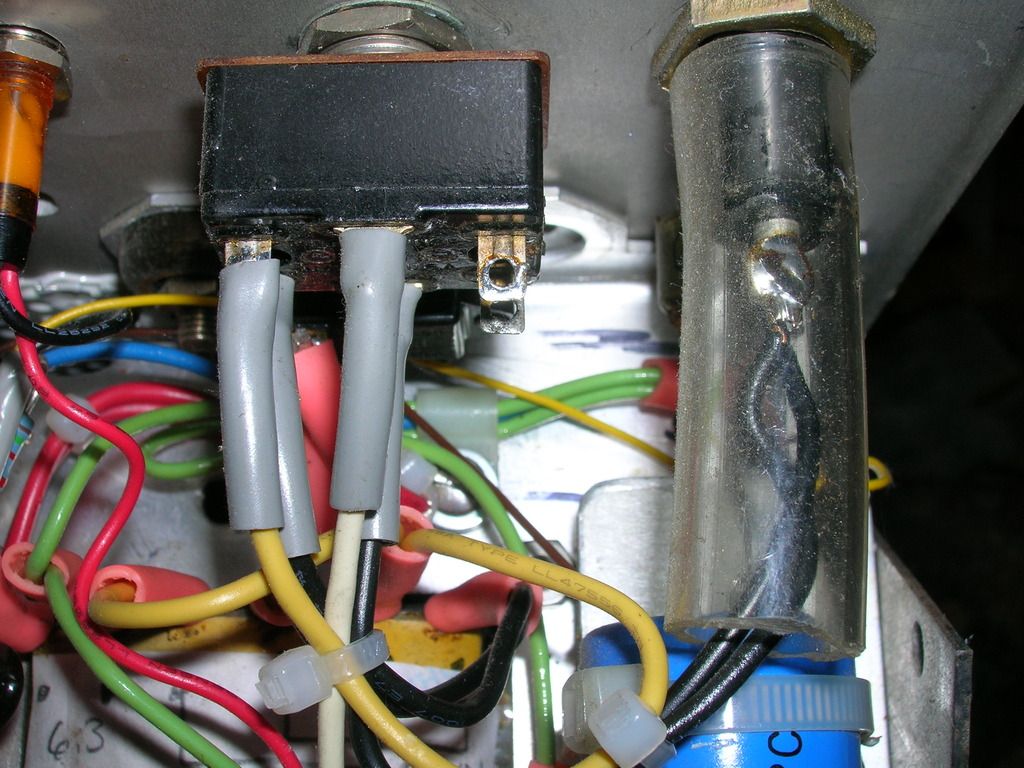

What I like to do is: At Home Depot, you can buy clear plastic tubing, 1/2" ID inner diameter. It fits perfectly over a fuse post. Or, if you have a piece of fat multiconductor cable, some of those fit over the fusepost nicely. Or, heatshrink would be the truly proper way to go, but I kind of like the clear tubing as it is more rugged, and the threads really hold it well. I use jacketing stripped from various cables to insulate such thing as switch terminals. Still like that better than heatshrink because it can be removed and replaced and has more gripping elasticity. And it is thicker than heatshrink. Another use for jacketing is (save those cuttings, kids!) if you have two fattish wires you are trying to solder to a terminal, I like to pre-solder and feed those wires thru the tubing, because if you carefully get the two wires even with each other in terms of how much of THEIR insulation is stripped off, it makes the lead-in to the soldered terminal much neater. By the way, CAT5 cable is useful for this, the type that is used in conduit, and most installations throw out tens of feet of it. The jacketing of that cable is very useful, all over the place. And free.
[/URL]
So if you cover up the whole fusepost AND the terminals on the power switch, then leaving the amp plugged in to the AC Line while you work on it, there is no way you can shocked by the line. There are plenty of ways you can shocked other ways, let there be no doubt.
The thing about having the hot "sneak" through the transformer primary (which occurs when you place the switch in the neutral AC feed, is just that---it's sneaky. Yes, if you insulate it, then there are no exposed anythings.
But again....if you ask...."best practice" is to place the sw in the hot lead!
