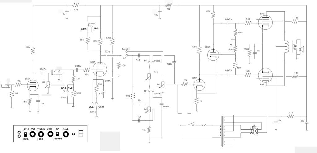

Talk about project creep. Started out as a Champ with reverb. Late night back of a napkin idea, not too up on FETs so don't know if there is something obvious I am not seeing. Think the reverb tank has an 800 ohm input. Not too concerned about the power supply values yet. Also think I may have to put a resistor in series with the tank to limit current along with adjust the coupling capacitor to limit the low frequencies.
Re: Cathode Follower Reverb Circuit
« Reply #1 on: October 24, 2015, 08:09:03 pm »
I *think* you want the reverb "a" point coming off after your tone stack, and then the "b" point being injected before your PI, not after. With a resistor in between points "a" and "b".
Others on here know lots more about reverb than I do though.

The name of the thread is bit mis-leading, since the FET's are doing the actual work, perhaps calling this a "source follower" reverb circuit is more appropriate. Also the FET is so easy to drive, there is no reason why you couldn't just use the plate output before the cathode follower (or the output of the T/S as suggested above) as the input for the reverb circuit, just me 2c...
Yes, "source follower reverb" is technically correct. Could make it a bit easier(?) or traditional by switching V1 to a 12ax, at, or ay and utilizing the extra stage for the reverb circuit?

Sorry to mislead you guys, have not been thinking about amplifiers for a year or two and brain is not up to speed yet I guess. Originally I was going to drive it directly from the cathode follower and changed to a MOSFET as I was curious as to how well it would work if I wanted to use it on different amps that are limited in the number of tubes available. My original schematic had a FET instead of the input triode, changed it on a whim. Also went back and forth as far as the PI, was thinking of a cathodyne with a MOSFET as the splitter and in place of the triode of the cathode follower. With a bass and treble stack you could shoehorn it into a Champ chassis. Like I said this sort of grew from being a simple Champ.
Thought of where to take the signal from, wanted to try the pre-EQ signal as it might have more mids and less bass and highs as after. Also did not want to do the mixing thing with a resistor as I did not want to reduce the main signal. The reverb return point that I am using can be used as another input to the PI to mix the signals. So you can just hang the MOSFET of the volume control? I'll have to try that. OK, almost looks nothing like the previous circuit but an option I am thinking of, nothing cast in stone. Maybe even use a 6U8 with the pentode in one triode position and the triode in the other. Going to have to do some breadboarding on this one, too complicated to just wing it in a chassis. Kind of funny, just want a little amp which will give me a Tweed or Blackface sound with reverb.

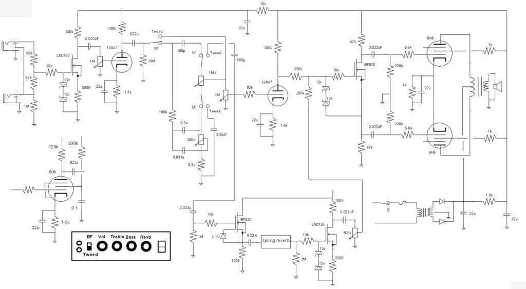

You can't adequately drive an 800 ohm load with a source-follower that has a 100K source resister.  You will get a very small, severely clipped signal into a resistive load and a very small, mangled signal into the inductive load of a reverb tank.  BTW, a tank with 800 ohms at 1KHz is 400 ohms at 500Hz which makes matters even worse.
The ideal source resistor for an 800 ohm load would be 800 ohms.  Let's say that the 10/24 schematic has 100V DC on the cathode of the cathode-follower which would also be 100V DC on the gate of the IRF820.  The IRF820 is going to allow enough DS current to flow so that the voltage across the source resistor biases the device to an equilibrium.  This voltage is going to be a little bit different than 100V, but for ease in this example, let's call it 100V.  Now you have 100V across 800 ohms which is 125ma.  Nobody is going to want to set aside 125ma for a reverb driver.  The datasheet makes it look like 125ma would be no problem, but I'll bet that it will get real hot and requires a good heatsink.
I don't know if you have played with this kind of MOSFET packaging before, but the drain is connected to the part with the hole in it, so watch out.
+1.
In this case, because we have hundreds of volts of power and only need a few volts in the tank, we "could" cheat-up quite a bit.
The real deal is to figure out how much *current* the tank wants for good drive. I suspect 6mA peak will be ample.
We also have the "800r" tank driven with a 0.22u cap. On the face of it, bass below 900Hz is cut-off. It is actually more complicated: we may have a big resonance in the 500-900Hz range. Best look at any transformerless tube drivers you can find.
There's a reason we like transformers for tubes driving electromechanical stuff. (However the readily-available RTs are scaled for low-Ohm tanks.)
Note that the new plan in Reply #4 shows gate biased to ground. On most MOSFETs this will give dead-zero current flow. (Which does help with the heat problem.) The LND150 in the recovery stage is different; and may be a convenient choice for the driver?)
That's about double the current and power that the two 6K6 will draw. PT almost 3X bigger than needed for output.
I also see the reverb recovery coming off a grounded reverb level pot, but fed into a point (call it V1b plate) with high DC.
I have doubt that the reverb recovery level will be strong enough to flog the output stage vigorously.
I also predict that V1b plate will sit at 70% of supply voltage. Cathodyne (Source-odyne?)) wants grid (gate) sitting a lot closer to 1/4 of supply voltage.
GE data suggests 2*6K6 use a 400r cathode resistor, not 1K. Sure the tubes will "work" but the optimum load should rise from 12KCT to around 30KCT (and max power output down near 4 Watt). With 1K bias and available 10K-12K loads, power output could be a couple Watts.

Yeah, know that a cathode follower would not be an efficient method of power transfer but thought of it more like a current source rather than having the source and load matched. Also realized that I do not need hundreds of volts to drive the coil. Not that you want constant power at all frequencies, need to roll off the lows so things do not get muddy. Did not realize they rate the coil at 1 kHz, oh well.
I knew the second circuit was not workable and could work with a LND150 driving it, have a circuit somewhere in my files. I was showing the rest of the amp as a jump from a Champ, to P-P then to the first schematic. Nothing really nailed down other than the power transformer and the output tubes.
Used 480R for a couple of 6K6's before, seemed to work fine. Now where is that thread?
We could put a sizable resistor in front of the tank and a proportionately sized source resistor.  We can tolerate a lot of voltage drop across the resistor portion of the resistor/tank voltage divider because we have a large signal available.  Now we have a much more constant current situation because the voltage rises at the tank as the impedance rises with frequency while the voltage of the signal at the source remains about constant.
That's a pretty good estimate.  My Accutronics 8E is dead-on 900Hz with a 0.22uf cap.  It moves down to about 300Hz with a 2.2uf cap.  It takes 22uf to get it low enough that it doesn't cause any trouble.
The LND150 is too wimpy for a direct driver.  The things will barely do 1ma at 500V.  They will do a real impressive job of driving a transformer, however.

Changed again. Did an amalgamation of some past ideas. In tweed position of the first switch you get a 5E3 type input and the second switch goes between a Tremolux 5E9A (paraphase PI) or 5G9 (Long Tail Pair fixed bias). Aren't four pole switches wonderful? The other position for the first switch would be for a Blackface amp, LTP for a cleaner sound, Paraphase for a little unbalance. Power supply values need to be worked out, originally was going to go 6W6GT for the power tube but may do a 6K6GT. Guessing the reverb as shown might be a problem for the Tweed position and anticipate putting it across the 1M resistor between the two switches for BF mode. A little more complicated amp than I originally was going to do, I wanted to replace the BF/Tweed Champ I gave to my brother and have reverb added.

As shown, S2 will "pop".
6V6 can be run in the same conditions as 6W6 or 6BK5, at a small fraction of the heater power. (The 6W6 family shines for high cathode current with low supply voltage.) But if you have an oversupply of heater power and hungry-heater tubes, that's fine.

Thanks, forgot to put the resistor in, I usually use a 4.7 M for it. I have taken to switching power supplies for the heaters. I usually find old laptop ones for $3 at thrift stores. Like you say these tubes are current pigs, without the bricks it would be harder to use them. I have some 6W6's but only two 6V switchers that are capable of feeding them and a few preamp tubes, the number of them may be asking too much of it. Using the PS makes for a quieter amp and frees up some VA's from the power transformer. I have used 120V:120V/120V:240V isolation transformers for a few amps, usually a 30 VA Hammond with SS rectification. Helps to make for a lightweight amp.

simulation says "FET_A_DYNE" will work better with 10K for Rs and Rd as opposed 47K for Rs and Rd you show.

« Reply #44 on: January 13, 2016, 09:16:47 pm »
Finished schematic. Am going to remove the Big Muff tone control and add the NFB switch to give the amp a more cleaner mode. Otherwise the amp works well with the parts as updated. Again, the amp run on 250V, it sounds fine but the weak point I think is the output transformer. I am sure it would sound better with an OT that was really designed to be one. I did move some parts on the board. Moved the output cathode resistor and cap under the filter caps, put the rectifiers in its place.
 I put 400V caps on the board, who knows, maybe one day I will change out the output transformer, flip the power transformer around and feed it to a doubler. Did that in another amp and puts out about 400V into a pair of 12AB5's, a 9-pin version of the 6V6. Maybe change the power supply resistors though.

Next amp build, this one.
The current one I am building was brought to the top of the heap when some guys sparked up the $100 amp thread. Thought it would be a quick build and I wanted to see how viable an amp it was. I did not anticipate some health problems that have plagued me the last couple of months. A week could go by with me not getting into my basement to work on a project. I think I would like to build a Telecaster before I start on the above amp. I have had the body and the neck cut out for a couple of years but got sidetracked with acoustical guitars. Going to go 12V6GT in the above amp rather than 6K6. I have some chassis and cabinets already built, hopefully it won't take too long. I want to stay pretty close to the respective circuits for this amp, the only place that will need experimenting with is the reverb. Hope it goes well.

« Reply #47 on: January 16, 2016, 06:33:47 pm »
Not a 100% physical layout but easy enough to make one from it.

« Reply #49 on: January 17, 2016, 01:52:14 pm »
The fine folk at music-electronics-forum came through with a SF suggestion.
another interesting picture.
