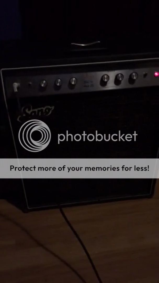

I will check out that resistor once i get moving this morning.  and check voltages.  I was tining of building a limiter, saw one in a video.  Ill look for some plans for one.
Dave
If R19 or R20 are the problem all you need is a 330K resistor to replace the burnt one.  If that fixes the output issue you won't even need to check any voltages.  ;^)
Here ya go, from Sluckey's web site;
http://home.comcast.net/~seluckey/amps/misc/Amp_Scrapbook.pdf

  • Posts: 5377
R19 and R20 are used to couple the tremolo signal to the grids of the output tubes. The trem signal varies the grid bias of the output tubes at a slow rate in order to produce the tremolo effect. You could totally cut R19 and/or R20 completely out of that circuit without affecting the amp. Well, except you will affect the trem if you only cut one resistor, or you will have no trem at all if you cut both resistors.
Offline Paul1453
  • Posts: 1085
So where did my analysis break down?  I realize this is the insertion point for the tremolo signal, but wouldn't a significant mismatch in those resistor values possibly cause different signal levels to be felt on the grids of the PP output tube pair?  I would also expect that to be the case if R23 and R24 were significantly mismatched.   :w2:
Isn't this point also indirectly connected to the NFB loop from the secondary of the OT?

  • Posts: 5377
Not even close.
Maybe that resistor was just dirty and not burnt to begin with?
That's what I thought. But either way, it ain't causing the symptoms we've been given. Maybe highlux could check that resistor for you.
BTW, there's an error on that schematic. The junction of R36, R37, and R43 should have a ground symbol.

> if one of these (R19, R20) were open or burnt enough to be of considerably different value than the other that the output tubes might be fighting each other or just not able to produce expected level of output.
V2b outputs as 47K impedances.
The input of (say) V6 is 330k||1Meg, or 248K.
47K driving 248K is essentially 50K driving 250K, a light load. The 248K could be any larger value and not have much effect. (20% difference in push-pull drive is nearly no effect until you get out the fine test equipment.)
If the 330K went _down_, say to 50K, it would have some real effect. I have not looked at the pictures. But if you see "burnt", *usually* the value goes *high*. (And not always.)
> make the gear operational as quickly and efficiently as I possibly can
Some of us have been there. I know a guy here maintained airport flight guidance, and you can't tell a 747 to come back Tuesday. I did a lot of live PA, and the show must go on. I think someone here had the same training and duty as you.
My first semi-mentor said "Is it plugged in? Is it turned on?" To which I add "Is it really plugged-in and getting power, is signal really going where it's gotta go?" Obvious mistakes are rampant. Connectors have the worst job, yet are often low-cost.
And when it is really not-on, a sniff is part of the trip.
But in wide-open classic tube audio, voltage-checks are a very reasonable 2nd step in the process. It will find (or rule-out) about 2/3 of the parts (tube, resistors, shorted-caps). It isn't much work. For 85% of stages you don't really need a voltage-table. Grid at 0.0V (with exceptions). Cathode a few volts. Plate should be at 1/3rd to 2/3rd of its B+ node. (Though here, V2 is an exception.)
BTW: Sniffs can go wrong. I got a trashed power supply with a meter. Someone had slit the sleeve over the fuse to check it (OK). When I looked the other way, I saw a "toasted" thin wire on the back of the meter. Yup, toasted right through. And so thin and so long-ago that any smell was long gone. (For more fun: when the shunt let go, the tiny meter tried to take the full 2A load, and burst a hair-spring. You can't get these no more.)
I jumpered the burnt stuff, it worked, and then it didn't work. After much swearing, I discovered an assembly mistake. The voltmeter PCB hit a chassis screw (maybe they changed meter vendors). Someone had snipped the corner off the PCB so it would "clear". Well it did or it didn't depending how you set the upper/lower chassis halves. But because of the current-limit, there was no POW from the short, no stink, it just shut-down.
> Owner says the volume dropped one day and stayed low.
Do you believe him?
My eye sees that V2 *must* be a 12AU7. Unlike most tube stages which can take 12AX7 12AT7 12AU7 with acceptable but declining gain, the direct connection from V2a to V2b suggests a very critical circuit, which will shift to a non-working bias if a 12AT7 or 12AX7 is in that socket.
Voltage checks would be suggestive. Please do not get a shock!!
What are heaters?? These are vacuum tubes. Electricity will not go through a vacuum. Electrons can carry electricity through a vacuum, but electrons are tightly-bound in atoms. But if we heat atoms about white-hot some electrons are liberated. We get this heat any convenient way, which is invariably a "light bulb filament" and a power supply (DC or AC, generally low voltage, invariably 6.3VAC in classic tube amps).
But you probably do not need to check heater supply if the tubes light or get warm. (Say you are blind, but you want light for a friend who is coming. If the bulb gets warm/hot, you don't need a light-meter or a volt-meter to be pretty-sure it is working.)
6CS7 (reverb driver) is an odd old duck. Fortunately it is unlikely to be the immediate problem.
And yes, well-spotted: Rev and Trem Int pots go to a ground, also the stopper off the Trem Speed pot.

Well....good news.  Its working. Plays beautifully.    I am totally serious!   I will get a short video once I get the work area picked up.
Not a single thing mentioned here was the cause either.....my diligence and perseverance was what saved the day.
That is great, but of course nothing mentioned was the problem.  The reason I say that is with the info provided everyone was just guessing.
What exactly did you find to be the issue?
Also, hang around so you can help those who  know less than you and in a short while you too will say post your voltages.  I am in no way poking you, but with tube repair knowing voltages can sometimes immediately tell me what is the issue.
I am not good at looking a photos, but Silvergun is.  Others are too and I can see obvious things, but there is nothing like a meter closely followed by a scope.
Glad you got it going.   :icon_biggrin:
highlux
  • Guest
Well....I thought it was a bad power tube.   I just happen to pull a couple 3l34eh out of a peavy classic 30...and i thought to myself...I know these are good....so I popped them in the amp.   Fired it up. Worked.
BUT
I knew the owner had just bought the 2 new jj 3l34's that were in the amp. They were "new" and "matched".
I couldn't accept it was just the tubes....so....you think most people would be ok...new tubes...it good to go now.  Then I remembered....those EH tubes are not mine...lol.
So I put the old jj's back in.  Put the EH's back in the Peavey.   Well....the amp still worked.
So...to be honest....I have no idea....what made the amp start working. Jiggling stuff?   Cleaning pots/jacks?
I think it was my mojo.   Karma fixed the amp despite professor grump amp.
I'm playing it on and off all evening to attempt to reproduce the issue.  So far so good.
Now to mop up the cord...and talk to owner about these 50 year old pre amp tubes and upgrading the speaker to a Celestion.

Here is a little video...I'm a terrible guitar player...but I keep trying...lol
Very little clean headroom.  breaks up quick, like 9am on the dial.
What power tubes are in the amp?  You wrote 3l34.  Is it EL84?  The amp sounds fine, but have you checked to see how old the filter caps are?  I mean, a general service on the amp before returning it to the owner is what I usually will do.
That is sort of like making sure all contacts are clean, like burnishing the input jack(s) if switchcraft, I will remove the pots and clean oxidation and make sure you have good contact.  I usually will replace plate resistors and bypass caps if old and electrolytic.  Maybe measure the old ones to see if they have drifted by drying up.  You know, a general service.  Checking solder joints and re-flowing any questionable joints.
Doing these things are not absolutely necessary, but if someone gave you the amp to repair these things will usually make the amp quieter and tighten up the bottom end.
Who is the amp tech you refer to as Karma. :icon_biggrin:
