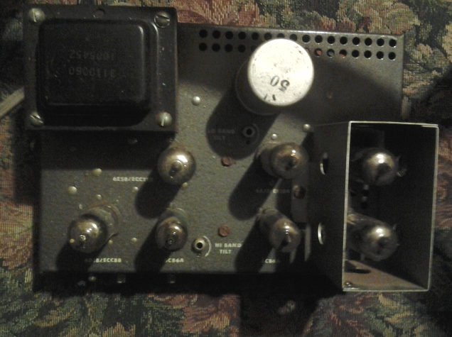

The Silvertone R-R is now a bedroom Champ!
Troubleshooting terrible hum started at the rectifier.  Should have +280 V coming out pin 8, got +200.
OK, swap in a different 6X5 still +200.
Only the cap can before the 1st resistor to be dropping that V.  Change out the cap can.
It had a 40-40-40uf 300V can, I only had a 40-40uf 450V can.
OK so I just leave out the last 40uf cap to see if she's gonna work.  Work???
She sounds great with only slight barely noticeable hum.
She's not very loud, but when I add my 12" 8 ohm speaker to the output jack she does much better on volume.
Put in a distortion pedal and add some gain and she's a Rockin!
Less than $25 in parts total, and my time to fix her.
Not a bad deal.  Pretty sure I can get $75 for her locally the way she is now.
