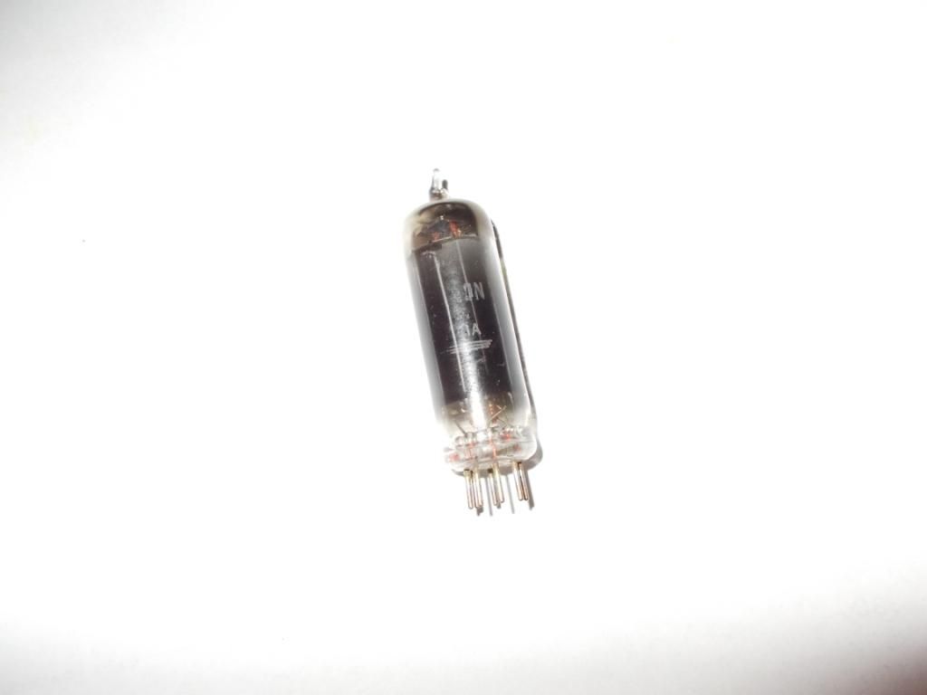

OK, There may be some issues :cussing:
The bypass resistor is 250ohm/5w and with it disconnected I can't get a reading, there is no signs of heating, so i'll take it as OPEN.
A close look at the 6AQ5 has some black coating on the inside of the glass, ummmmmmmmmm
Where to go from here???

Cute amp!
To clarify . Is the amp working? Your first post would seem to suggest it is
Personally I have no problem with ditching old caps and making amps safe (3 prong plugs and fuses) if it's going to be an amp you actually use, unless it has huge amounts of collector value I guess.
I don't think that black coating necessarily implies a bad tube. especially if the amp is working. There are many tubes with smoked glass coatings
Still, cute little amp! what fun
new caps, new power cord, new cathode resistor, new 6AQ5/6005. play amp. grin like a cheshire cat.

« Reply #13 on: November 29, 2015, 10:03:22 am »
if that tube works fine, it is fine.
i think if that cathode resistor was open the amp wouldn't have worked.
