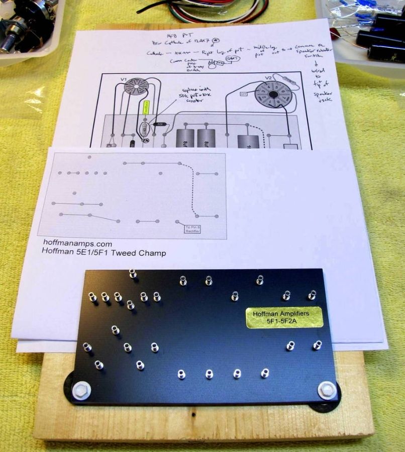

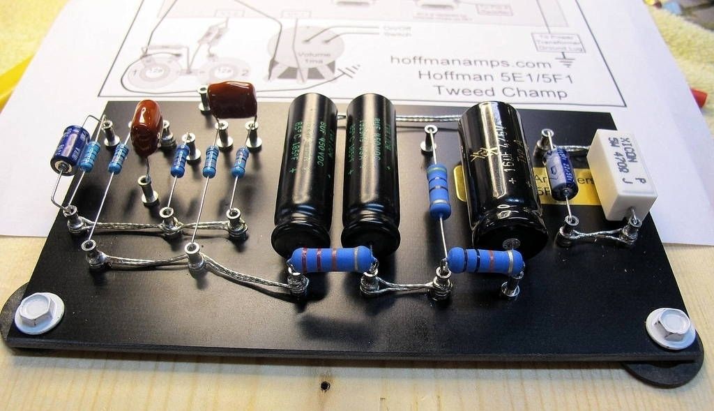

So I guess I'll document my first build here, not because I think anyone is really interested in seeing another 5F1 build.
I guess these are close to the simplest Tinker Toy one can do for tube amps, and most will find it boring, but....
My incentive is self-preservation, in that hopefully someone can spot my mistakes and point them out before I burn my house down.
Goal is to build the 5F1 with 2 mods: a variable pot in the NFB loop, and a 4/8/16ohm speaker switch.
Still trying to locate some ClassicTone transformers in stock.
I called Triode USA yesterday to see if they were in stock, and I got shunted to a recording that said "Customer Service is not available".
On the whole, that was a somewhat discouraging statement, I thought...

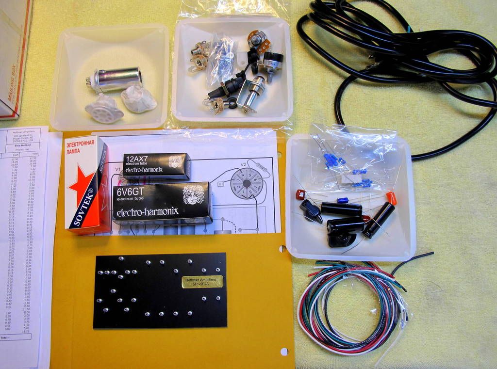

Anyway, the Hoffman kit arrived very quickly.  Nice service !

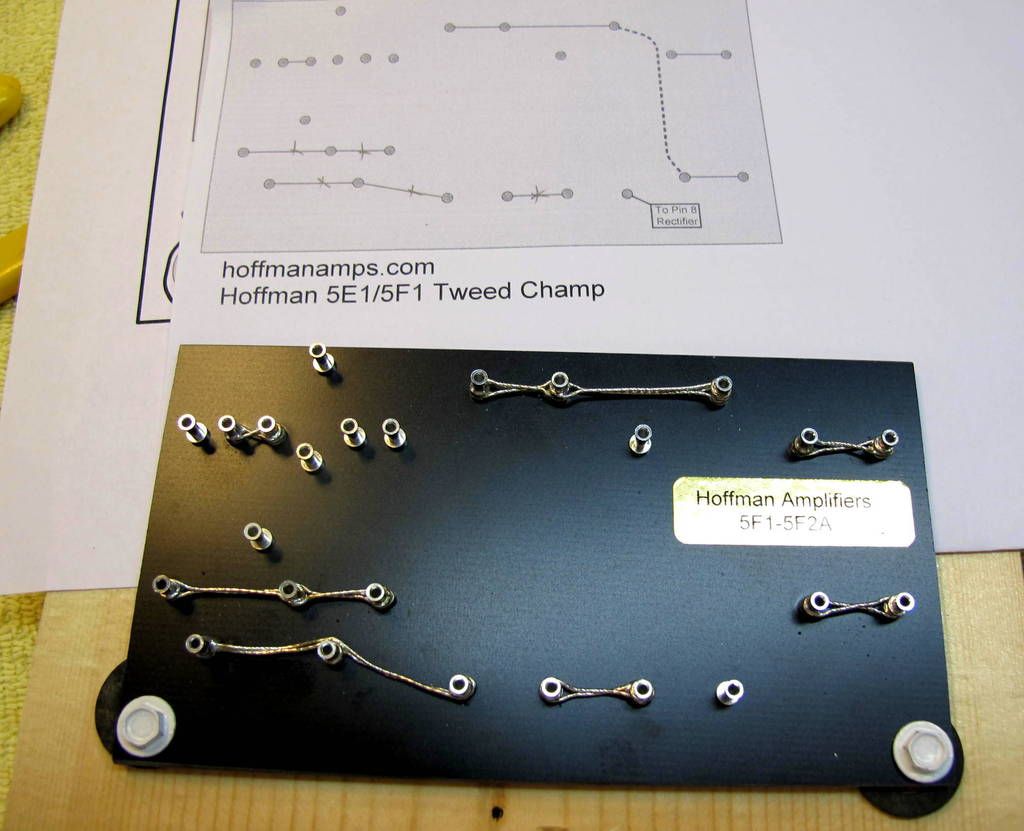

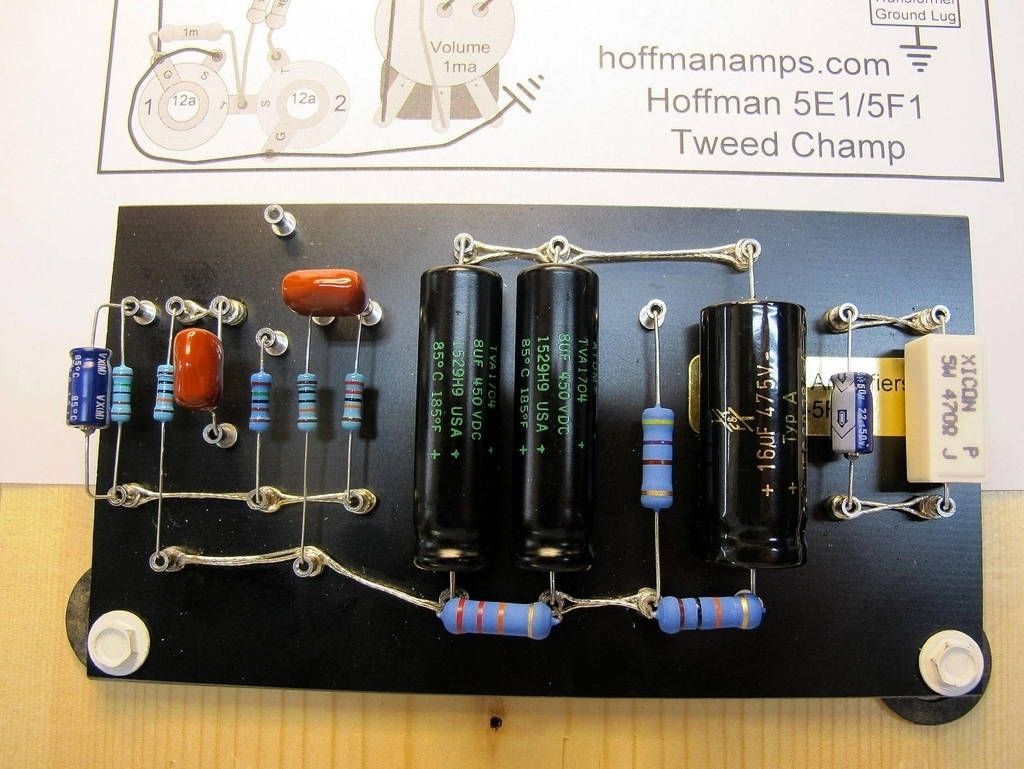

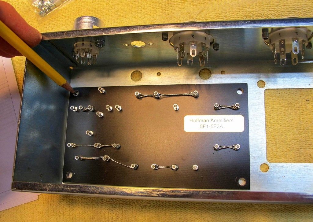

I watched a few videos, did some reading, screwed down the board, and did the lacing.
Then spent last night ID'ing and dry fitting the board components.
The resistor color codes didnt seem to match what I was googling up as a guide, but I used my multimeter to correctly ID them all.
Not forgetting the underboard jumper wire.
So if anyone sees anything amiss so far, please yell at me using as many 4-letter words as appropriate.
My intention for the negative feedback circuit is to replace the normal 22K resistor with a 10K resistor on the turrets and run a wire off the 10K to the pot which will be in a to-be-determined spot on the chassis.
Would 18 or 20 gauge wiring be good for that ?
something like this:
I know most of you could build this in your sleep.
/mike
« Last Edit: March 01, 2016, 01:26:00 pm by Meteorman »

« Reply #1 on: March 01, 2016, 12:50:32 pm »
The pics all look good but I have no idea what you're trying to say.
Re: 5F1 Build thread - by a first timer.
« Reply #2 on: March 01, 2016, 01:24:33 pm »
Your board looks good. 22AWG is plenty sufficient for the NFB wire. 18AWG is overkill. Looking forward to seeing the entire project so please post more.
Here's a suggestion about that underboard jumper. Put it on top of the board just like all your other jumpers. Or, if you must have it underneath then insert the end of the wire completely thru the top of the turret and bend it over so it cannot possibly fall out when you begin soldering. Here's a pic showing what I mean...

« Reply #3 on: March 01, 2016, 01:57:48 pm »
We really are interested...we were all new builders at one point.
Welcome to Builders Anonymous!
Doug is a consistently fast shipper...tell your friends.

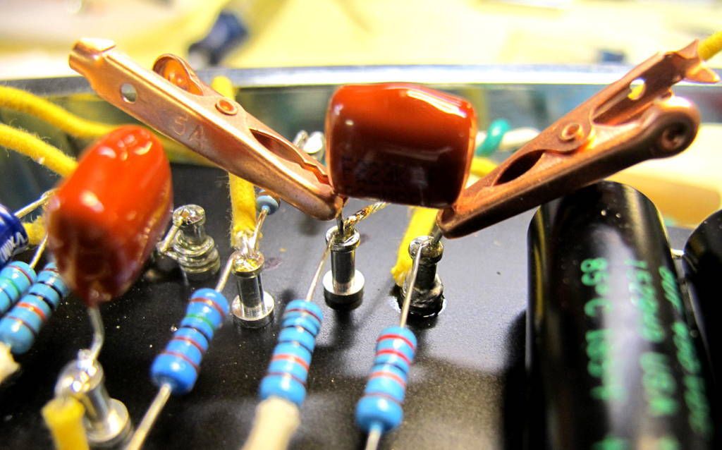

One thing I would suggest would be to use good heat sink technique during soldering...you don't want to damage those pretty new caps with all the heat it takes to get them down.
« Last Edit: March 01, 2016, 02:08:32 pm by SILVERGUN »

can you elaborate on heat sink technique? And yes.....Doug has sent me everything ive ordered within like 4 working days tops , and even personally thanks you .....awesome

Thanks gents.
I intend to place little alligator clips on the leads between the cap body and the solder point.  Thats the only thing I know to do for heat sinks.  is there something better I oughta consider?
I think I need to sleeve those resistor leads that pass over the lacings, too.
Thanks for the jumper tip, Sluckey.
/mike
Nope that's good..
I like to use aluminum clips, so when you have to get close they don't get accidently soldered to the joint.
Sometimes I'll use 2 clips, one at the joint and the other up near the cap (or diode) body
+1

Honestly I wish everyone was posting progressive updates. They're great! And completely unobtrusive to those that aren't into them. Hmmmm?mit just occurred to me that maybe there's a board in the forum already set up. Beyond that, great work and thanks for taking the time to do this
« Reply #11 on: March 02, 2016, 06:44:11 am »

Don't worry, Be Happy!!!
As a 1st time builder you have gone the best way.
You've purchased a proven design/layout, and components from Doug.   :worthy1:
You've started a thread to document your progress, so you now have multiple eyes proofing your work.
You are off to a great start, and your work looks good to me.   :icon_biggrin:
You will be very happy when you finally hear the results of your work.
They always sound better when you built it yourself.   :icon_biggrin:

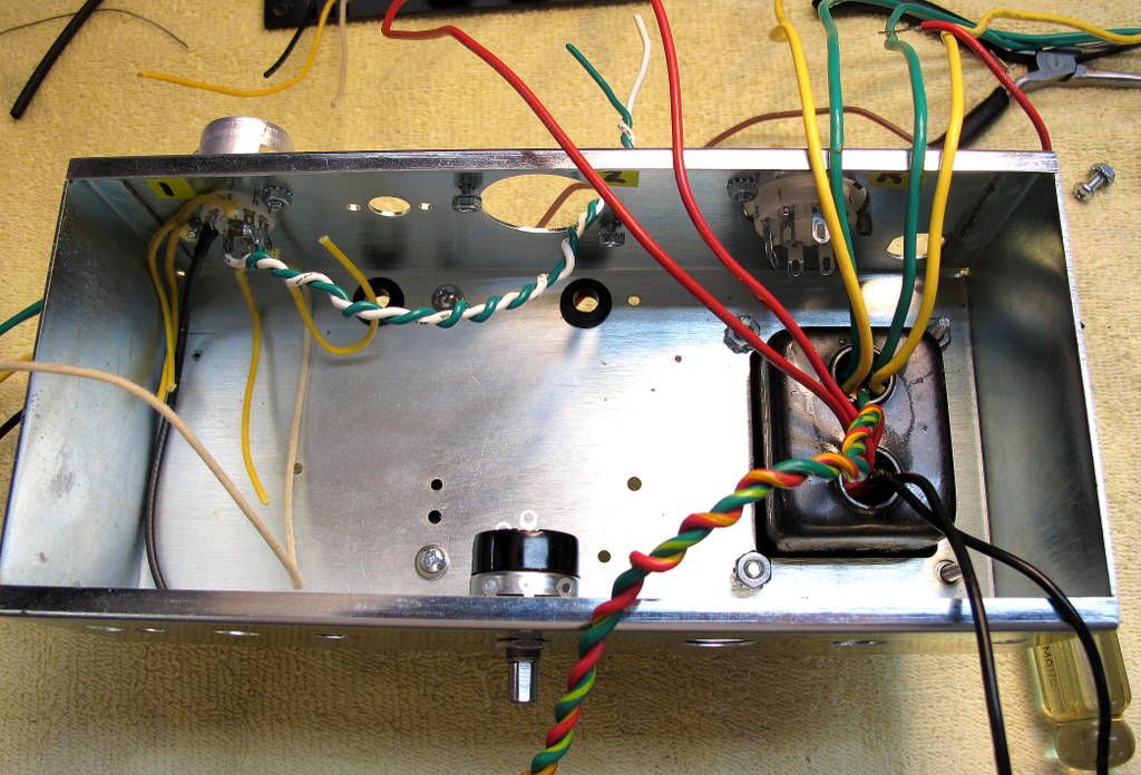

« Reply #13 on: March 03, 2016, 07:35:45 am »

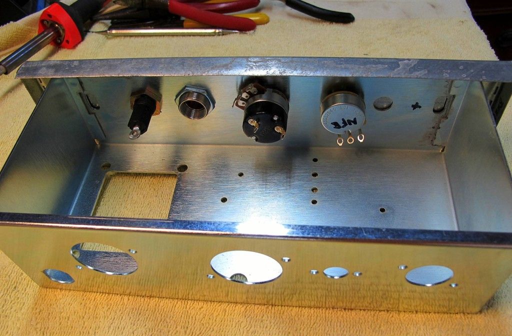

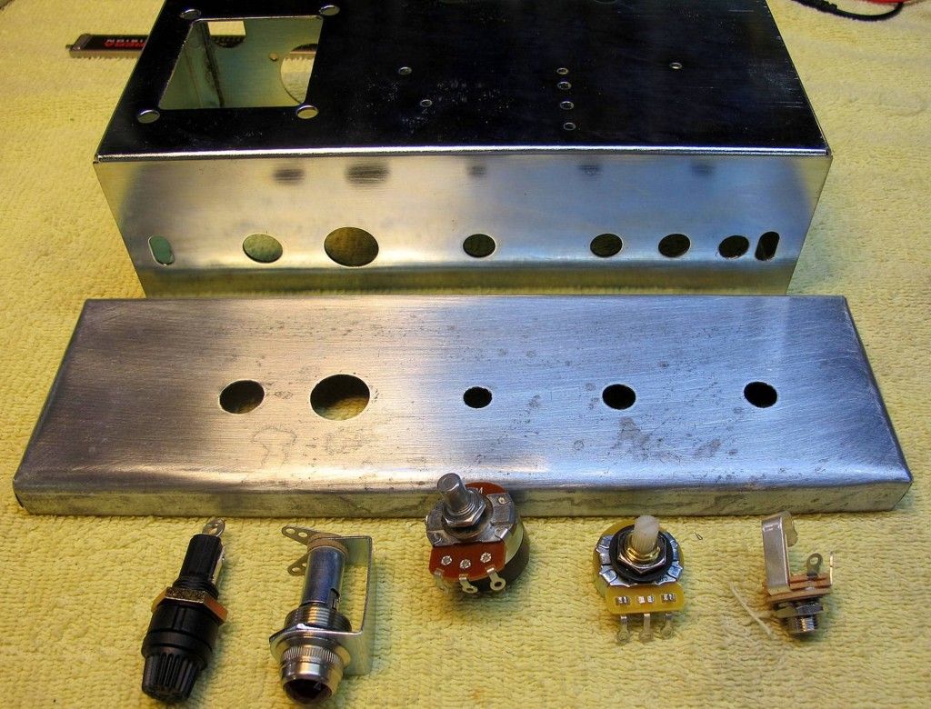

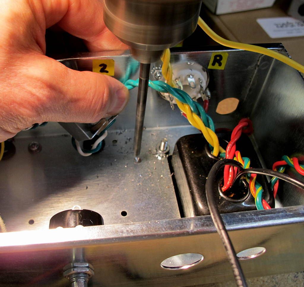

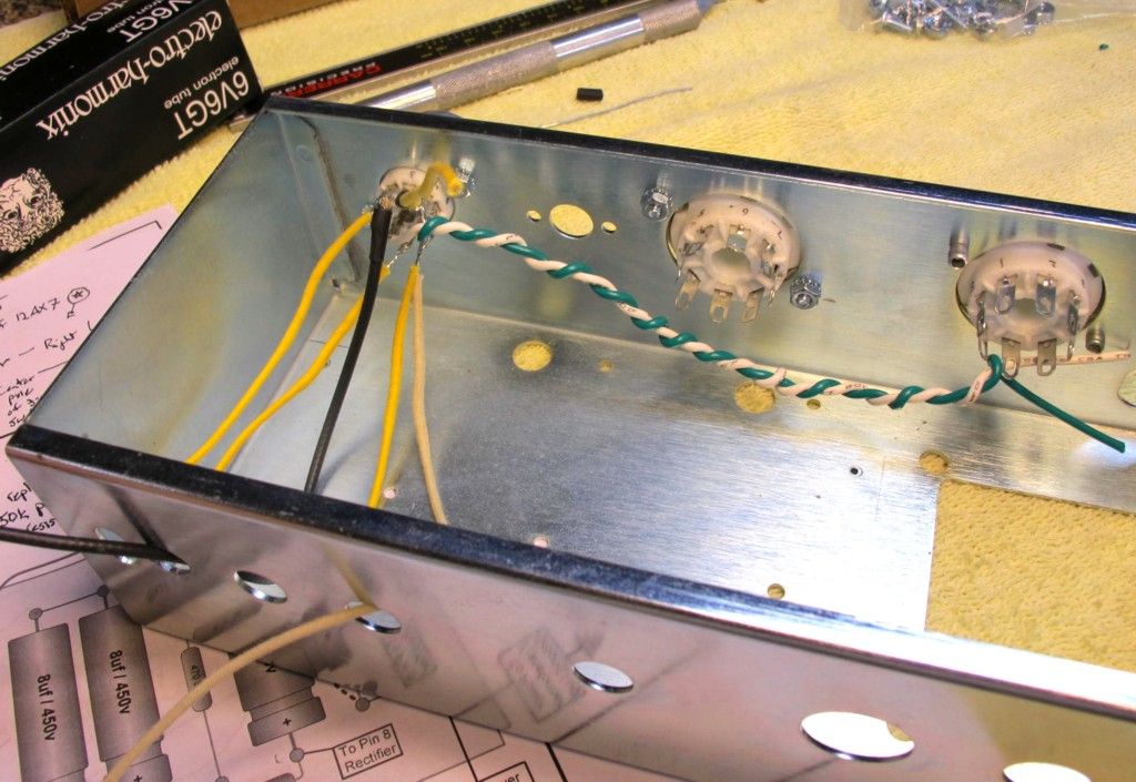

thanks comrades.  so with the bliss of ignorance as my shephard, I made minor progress last night.
first chore was to modify the chassis control face - I got the chassis off eBay, it's a nice product, but drilled for traditional Champ layout, which I'm going to tweak.
I only want one input jack, and i wanted the NFB pot on the front panel, sort of proxy for a tone pot.
the hole spacing didn't accommodate that config, so I decided to fabricate a faceplate with new hole spacing, then drill the chassis to match that.
Turns out that really only meant one new hole, just moving the input jack hole more towards the edge, and sticking the NFB pot in the (original) 2nd jack hole .
The face plate, which I'll paint and label later, of course then hides the abandoned original 1st input jack hole.
I think I'll spot mig weld the face plate onto the chassis before i put any components aboard.
The I did some ciphering on location of the the circuit board - there really isnt a whole lotta wiggle room there as most of you already know  - and drilled the board for its mounting hardware - and transferred those holes locations to the chassis.
Waitin to drill the chassis until I have transformers in hand & I'm positive I have needed clearance.

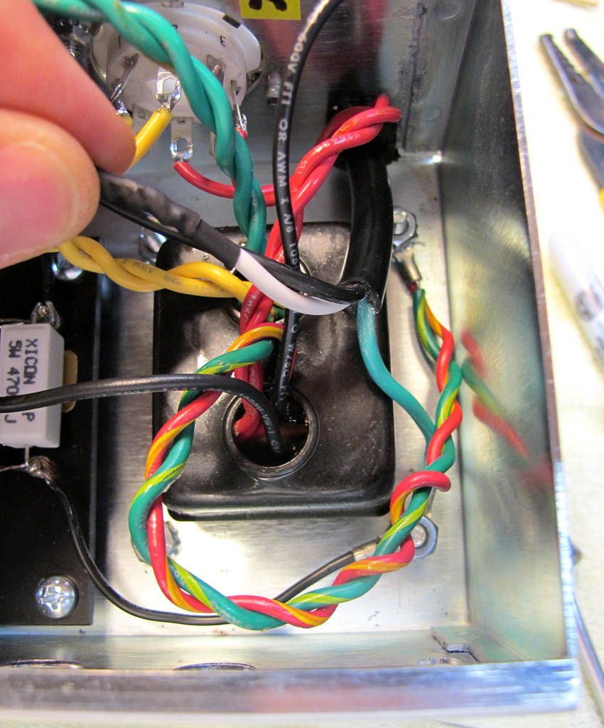

So then comes the hard part.  For me anyway.
Doug says, to keep things neat, wire up the chassis infrastructure first, before installing component board (which is 180 degrees from the way I woulda done it, so it has to be right).
Then install component board and patch it in.

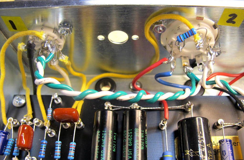

The sharp-eyed will note the 6V6 socket is riveted above but screwed below.  evidence of a mistake.
I needed to swap the orientation of the socket once I saw how the heater wires were going to run.
Drilled out rivets, learned a lesson about thinking ahead.

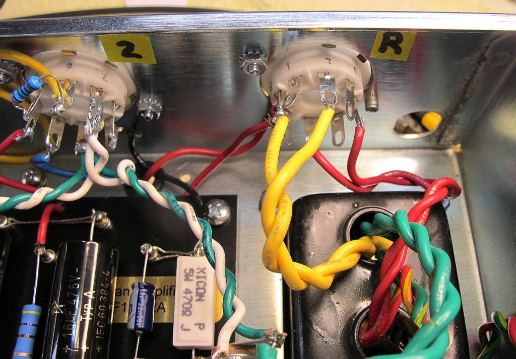

Started soldering the 12AX7 leads.
Fumbled around soldering with the socket installed in the chassis at first, until it dawned on me that I could just remove the socket and solder it up and then reinstall. Duh.
Confidence was sagging at this point.
The green white heater wires will go to center 6V6 socket, they just look like they're heading to the rectifier in this pic. ( I'm leaving leads long at first....)
The white and black go underboard to vol pot and input jack, respectively.
Yellows go to board.  The pushback cloth wasn't pushed back prior to these pics - I won't have those bare wires showing....  I hope.
Question #1 - can one carefully bend those tube socket solder tabs so they extend/radiate outward and separate a little ?  or must they stick straight out, like they do on a virgin socket ?
Question #2 - this will eventually go in a homemade amp head box, likely mounted horizontally with tubes sticking out back, as opposed to the tubes hanging down.
I'm assuming it would better to mount the chassis with transformers on top ?  They give off a lot of heat ?
thanks for any guidance,
/mike

« Reply #14 on: March 03, 2016, 09:18:18 am »
You can get away with bending those socket pins a little....don't do it in the future if you use the tan Belton sockets (very fragile pins on those)
Don't let the idea of transformer temps determine chassis orientation. The OT should not get hot and the PTs warmth is not an issue. Warm, yes, but not hot enough to make up your mind for you.
You're doing a GREAT job with pictures and you'll be happy when you can look back and have this all documented...it doesn't seem like much now, but it is YOUR first build and that makes it valuable.
Keep it up, won't be long until you fire it up and get that big grin that comes from electrons taking flight and moving a speaker cone.
« Reply #15 on: March 03, 2016, 09:37:38 am »
May I also suggest to redo the wires on that little socket? I would leave only about 1/16" of bare wire exposed. IOW, redo the wires so the insulation is almost touching the socket pins.

« Reply #16 on: March 03, 2016, 10:26:43 am »
yes thank you Sluckey - I hadn't pushed up the pushback cloth prior to the picture.
after i pushed the cloth back, no bare wires were showing.
but a good reminder nonetheless.
i think i might start employing more shrinktube to thoroughly isolate each pin connection.

Shrink tube is not really necessary if you are using cloth-covered wire where you can withdraw the insul, solder, then push it forward.
At some point beauty has to yield to practicality: If you really enclose "all" solder joints in ST, then you can't easily put a probe on them if you run into trouble. Of course you can probe the other end of any such wire. If you look at mil-grade wiring on some old tube gear, you may see shrink tube over all the tube socket connections. But you don't see it on old hp gear nor on old Tektronix gear. Shrink tube makes more sense if you are using *stranded* wire. But even then, not really necessary, IMO.

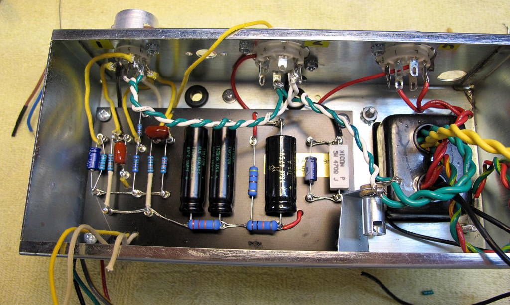

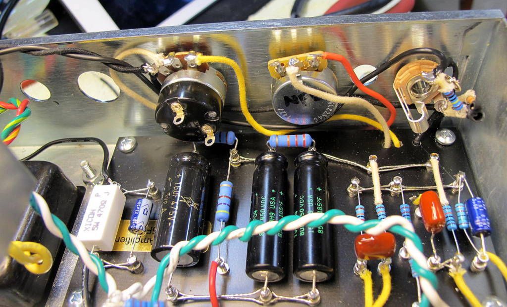

« Reply #19 on: March 05, 2016, 01:52:41 pm »

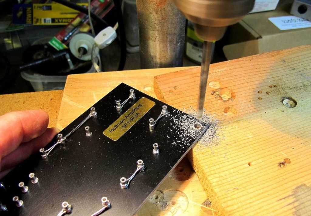

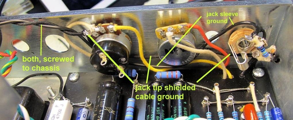

Classic Tone transformers came in from Dave at Boot Hill (thanks for quick ship Dave!), so I made same progress in last 48 hrs.
Mounted transformers., drilled chassis for circuit board mount, finished wiring up sockets and board leads.
Then mounted board and began knitting it all together.
just some random pics, mostly in sequence.
please yell if something looks amiss.
The resistors and shielded cable hook-up to the instrument jack input was pretty dang fiddly, complicated by having to do it inside the chassis - it may not be the prettiest, but I think/hope everything got soldered home and isolated.
Question #1: I'm running all my grounds to the PT mounting studs - is that correct ?
Question #2:  my speaker jack and 3-way 4/8/16ohm selector switch will not be mounted to the chassis - they will come out of the back of my homemade cabinet somewhere - I'm assuming they need their own ground wire coming back and hooked to the chassis ground ?
In the pic below, the gray(16ohm tap), green(8ohm tap), yellow(4ohm tap), black(common), and red wires coming out the back will lead out to the back of the cabinet to the 3-way ohm selector switch.
the red wire comes from the NFB pot.
Right now there's no ground wire headed that way - I need to add that for the jack?
thanks for any pointers,
/mike
OK, with the clarity of a new day, even I can see that was a dumb question... of course I need a ground from output jack.
Musta been breathing too much rosin flux smoke yesterday.
I was checking my connections with my meter's continuity beeper, and I see, with no tubes in,  that my heater wires are continuous with ground/the chassis.
I.e. the green leads coming out of the PT are each continuous with ground.  Is this right ?  Because they have a grounded center tap ?
The HV reds have a grounded center tap and they don't ring continuous with ground.
/m

right now I've think I've double grounded my input jack and vol pot, which might constitute a ground loop.
I'll post a picture soon and seek guidance.

The heater winding is less than 1 Ohm DC. It reads "zero" on most meters.
The 300V windings are several hundred Ohms each. Any meter will show this as non-zero.
Similar for the OT secondary and primary. The loudspeaker side reads "zero" on most meters. (A "16 Ohm" winding may properly read just over 1 Ohm DC. Some "8" may read an Ohm, the threshold for many meters.)
« Last Edit: March 06, 2016, 11:39:41 pm by PRR »

Here's my grounding question.
As it currently stands, I think i may have it wrong.
From my input jack, i have installed 2 ground wires - one from the jack sleeve and one from the tip's coax cable cable shielding.
The coax shielding ground wire (cloth) runs over to the vol pot ground tab, and from there, it runs to a bolt on the chassis on the PT side (the bolt that holds my face plate on).
The ground from the jack's  sleeve (PVC) runs over there too - on it's way past the vol pot you can see I twisted the two together on their way to the chassis bolt.
Given that the jack itself is grounded to the chassis, have I "double grounded" this assembly (via the jack itself and my wires) and created a ground loop ?
If this is a bad set-up, is the fix just to terminate both wires at vol pot tab?
thanks again,
/mike
« Reply #25 on: March 07, 2016, 08:34:55 am »
Yes and yes.
But what is the center/hot of the shielded cable that goes from the input jack to the volume pot hooked up to?
Read this on grounding if you haven't yet;
http://www.valvewizard.co.uk/Grounding.html
« Last Edit: March 07, 2016, 08:44:55 am by Willabe »
« Reply #26 on: March 07, 2016, 08:42:47 am »
The input jack will be the ground point for the preamp. Make sure it is tight. Use a star washer if you have one to ensure a good mechanical/electrical contact with the chassis. Now run a single black wire from the VOL pot ground lug to the sleeve (ground) lug on the input jack. Run a single black wire from the board ground to the sleeve lug on the input jack. If you are using shielded cable between the input jack and the tube, then connect the shield to the sleeve (ground) lug of the input jack. (If you are also using a shielded cable between the VOL pot and the tube, connect it's shield to the ground lug on the VOL pot.) Connect a short jumper between the sleeve and switch lugs on the input jack. This jumper can simply be the resistor lead bent around to connect the two lugs together. That's all. ***DO NOT RUN A WIRE FROM ANY OF THIS STUFF TO THE POWER TRANSFORMER GROUND BOLT!***
Another thought... Your NFB pot is in the worst possible place it could be. IOW, your speaker output is right next to your guitar input. This sets the stage for some squealing. Best to keep speaker output far away from guitar input. I would suggest to at least swap positions with the two pots. Even better, move the NFB pot to the tube side of the chassis, far away from any preamp circuit.

« Reply #27 on: March 07, 2016, 10:21:40 am »
Yes and yes.
thank you Willabe.
If i'm reading schematic correct, the hot center of the shielded cable goes between input jack tip and pin 2 (grid) of 12AX7 tube.
will look at that grounding material.
many thanks Sluckey -  looks like I have considerable re-configuring to do.
I greatly appreciate the eyes and wisdom of wiser builders.
/m

Would the hole between the pre-amp tube and the output tube be a better spot for the NFB pot?
There doesn't seem to be many other easy places for the NFB pot.
And would a switch in the NFB circuit make sense here?
A pot with an on/off switch to allow the NFB loop to be completely disabled, or adjusted to taste?
« Last Edit: March 07, 2016, 10:39:23 am by Paul1453 »
Offline Meteorman
  • Posts: 58
  • I make all my own mistakes
« Reply #29 on: March 07, 2016, 12:20:25 pm »
Good questions Paul.
The rear of my chassis will be somewhat accessible once the chassis is installed in my custom amp head cab, but it won't be real handy.
i know I need to be able to change tubes, but it won't be a good spot from which to easily tweak the NFB pot.
Of course my plans could change!  as they are already doing.
I'm going to swap the NFB pot with the vol pot and see how it sounds - if interference is unacceptable, I'll go to something more drastic on rear of head unit.
as is, the NFB circuit can go down to 10K currently (with pot at "zero").
Once I hear that, if it's not enuff, I guess I can tweak as needed.

spent last night swapping locations of VOL pot and NFB pot and rerouting grounding and output/NFB wires.
all input grounds on are now on input jack, and output/NFB wires run the other direction to PT side of chassis and out.
chopsticked the entire layout and all "looks" well.
throwing together a dim bulb tester tonight and may start putting some juice to the circuit.
For this simple circuit, is it strongly advisable to hook up an old beater speaker for initial tests ?
Is there really some significant chance that it could ruin my "good" cab speaker (a 12" HellaTone) ?
/mike

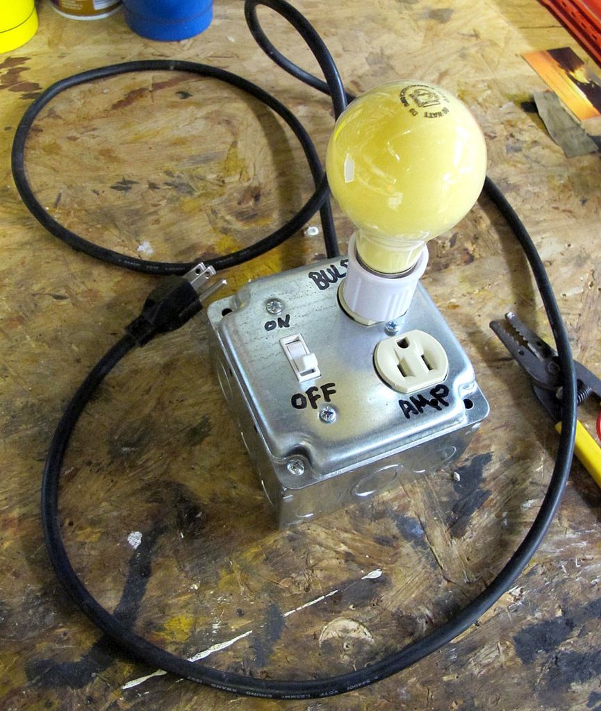

You need to build a light bulb current limiter when 1st powering on a new build, when you rebuild an amps power supply, change PT or change tube sockets.
http://sluckeyamps.com/misc/Amp_Scrapbook.pdf

« Reply #36 on: March 08, 2016, 07:39:04 pm »
Paul - roger all that.  I have the Classic Tone schematic for my 40-18031.  The red primary (8k) goes to pin 8 of rectifier.  The blue primary (common) goes to pin 3 of 6v6.
The 4,8, & 16 ohm and common secondaries are headed back to my 3-way selector switch.
Made dim bulb tester tonight.
 Tried it on a set of hair clippers (9w) - a 60w bulb glowed steady dim.  A 150w bulb did nothing.
What watt bulb is appropriate for this little Champ?
« Reply #37 on: March 08, 2016, 07:58:59 pm »
Use the 60w.
The bigger the bulb the LESS it will limit/protect the amp under test. You saw this for yourself when the bigger bulb didn't light up much.
I recently bought some 40w bulbs for small draw circuits, haven't tried them on a little Champ type amp yet, but I'm thinking it will be good for that amp.  :think1:

« Reply #38 on: March 09, 2016, 07:23:24 am »
thanks Willabe.
i can throw in a 40W first and see what happens.
Here's the obligatory pic of my dim bulb rig - I know people don't really need to see another pic of one, I just like saying "dim bulb rig" as many times as possible...
I won't use a yellow bug bulb when it gets serious.
I had parts layin' around, so the whole thing only cost me $3 for the box top and the plug-in bulb socket.
Then I'll consider the moment of truth
From what I can decipher, I should apply the juice:
1) without tubes
2) with rectifier only
3) with all tubes + speaker load
I need to study more about how, where and when to take diagnostic voltage readings.
/m

That B+ is really close to your pots, watch out for hum....  Been there myself

Not sure where the thread is but here is a picture of my fix.  Had to turn around the Filter caps.  After I did that it was complete silence.
Egads.  That would be significant surgery.  But so be it, if I have a hum issue.
Thanks for the tip.
I don't suppose there's such a thing as a "shield" that could be installed btw pots and filter caps ?
BTW, what is the red stuff you have at all your solder points ?  antioxidant ? byproduct of a QA/QC check-off system?
/mm
/mm
The Red Stuff is Dykem.  I use it sometimes as a personal QA procedure.  I have found solder points I needed to touch up in the past by going through this method.  However, lately I haven't done it as much.  It also tells me if someone has been inside the amp after it's sold.  Of course they could always re-dykem the solder point but most won't.
Everything Affects Everything
  • Posts: 3226
« Reply #45 on: March 09, 2016, 01:13:46 pm »
I've seen similar stuff recently in new Fender amps. Guess their warranty program is wising up a little.

That B+ is really close to your pots, watch out for hum....  Been there myself          No.. Mike , I have to disagree. There is never a problem with a Hoffman layout.. I'm thinking that your hum problem had to be a grounding issue.
