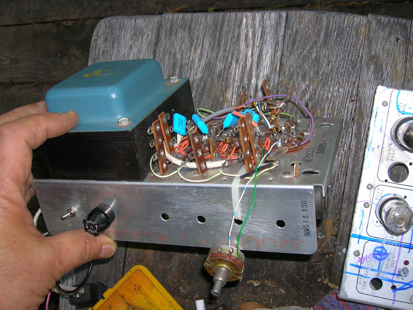

Hey guys, just had a client ask me if I could build him a Fender Reverb unit in this Old Philco radio cabinet.  I have on hand, a Marshall style chassis 12"W x 7"D x  2.5"H that fits in the bottom of the cabinet perfect.   Im thinking,  mount the tubes vertical and build a shelf in the upper part of the cabinet for a short type reverb tank. If I can swap positions with the input jack and the dwell control it would save me from cutting up the face of the cabinet.  I will install an IEC receptacle  on the back of the chassis along with a fuse holder and power switch.  The only concerns  I have is possible hum issues. Any comments or suggestion are much appreciated.

Do you have the glass dial plate and push button assembly? If so, I would mount those, put in a piece of old grill cloth, and use the existing four holes for a rotary power switch and the three pots, all with antique knobs. This keeps the look of the old radio. Then put all input/output jacks on rear of chassis.
Here's an old RCA that I did. It may give you some ideas...
     http://sluckeyamps.com/RCA/RCA.htm

I would simply bolt a 12" by approx. 6" plate to the front of your chassis. (Think faceplate but it would be about 6" high, not just 2.5" high.) May not need to be 6" high, but needs to be high enough to mount the upper pots so they align with the holes in your cab. You may need to build some shaft extensions like I did on my radio.
This front plate could actually be two 2" x 6" plates (one for each pot). These are just ideas to help keep the original 'radio' look. Use the glass plate even though the writing may be in bad shape. And since the holes for the push button switch assembly are round, you could just put some wooden dowels in the holes to simulate the look of pushbuttons.

For shaft extensions... I bought four 1/4" shaft couplers from eBay. They have two setscrews that lock on to the pot shaft and then the extension shaft. My extension shafts are about 2" long and were cut from a 1/4" x 36" aluminum rod I bought at Lowes.
Notice the two indicator lamps I mounted on each end of the brown dial back piece? You could probably do something similar. These lamps illuminate the dial but also serve as power on indicators.
I bet if you play around a bit with your dial assembly you can come up with a way to attach it to your new chassis. Hech, your pots may even mount to that bracket?
