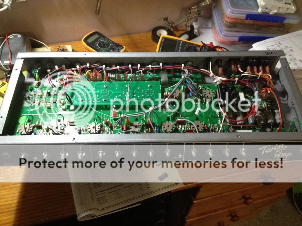

this is a gutshot of the one i sold...
I remember researching about modding this amp a few years ago and was told dont waste your time.

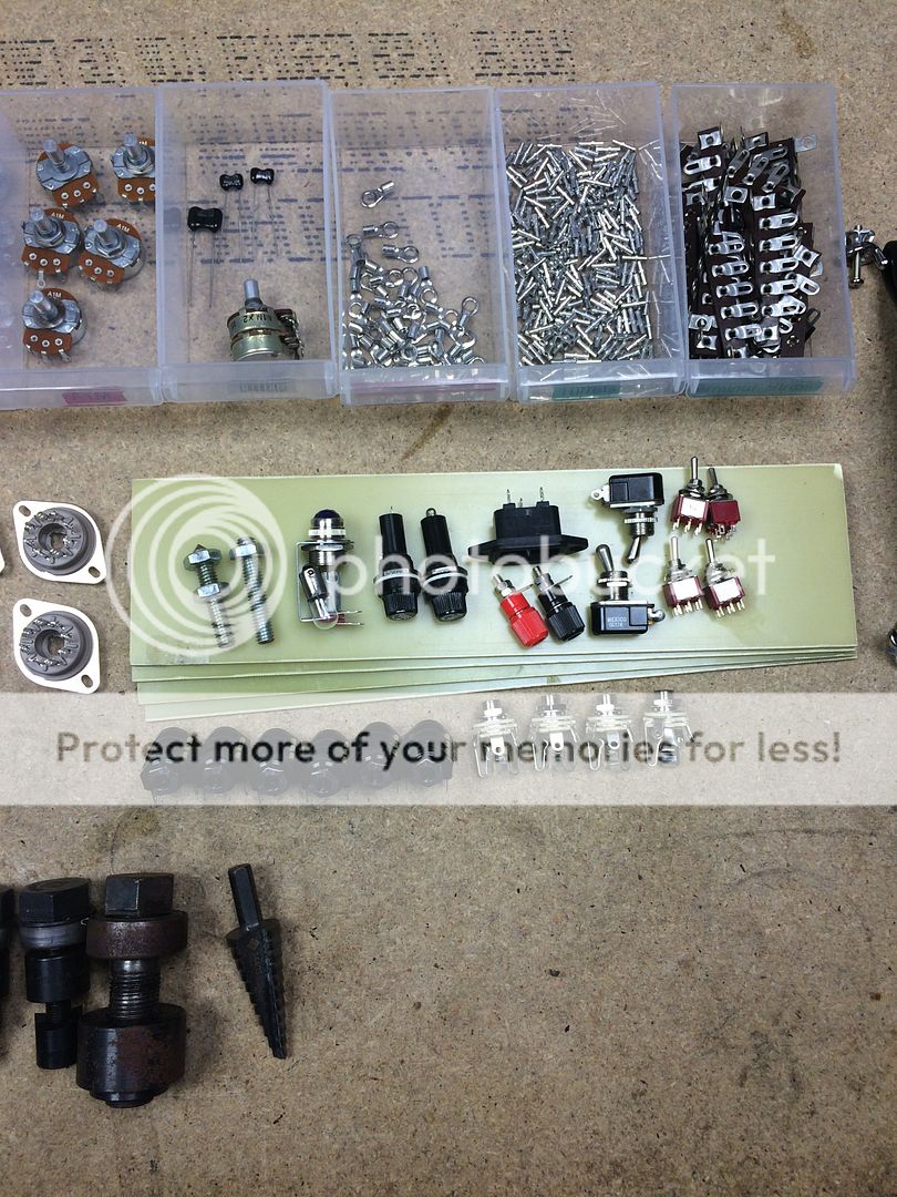

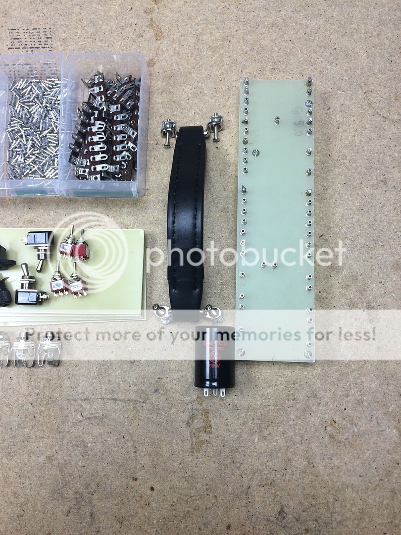

3) I have some unused Hoffman Turret boards and about 200 turrets and turret tool. I have 4, they are 12" long by 3.125 inch wide.
my question is i was going to use these to make a 2 channel deluxe hoffman layout
 http://hoffmanamps.com/MyStore/catalog/images/IMG_8481.jpg
which from my research has 121 turrets and is 15.63" long.(I cant find out how wide. is it ok to make the layout into 2 pieces so i can use 2 of my boards?
also Ive found it difficult to print out his board layout to correct size, does anyone have another template or something to use ,or if not what is the usually turret spacings ?

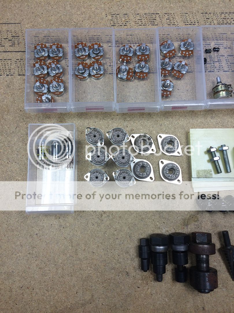

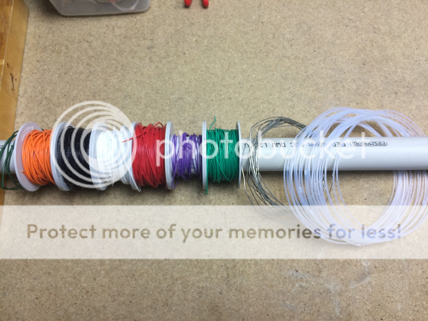

here are some pics of parts  ive already got

3) All of Hoffman's boards are 3.125" wide. You can split the layout onto two boards. But, for under $20 Hoffman will send you a predrilled board. That's a bargain IMO. When you print a pdf file, set the page scaling to NONE and it will print the correct size. You may need to go to Kinko's to get it printed unless you can tape a couple pieces of paper together and set up a custom page size for your printer. Like I said, Hoffman's $20 board is a bargain.
A distraction, but 2 of the 3 tubes in the drawer look like they have "milky getters".  That means the vacuum is compromised (probably a crack in the glass base, next to a pin) and they're no longer usable.
Re: Should I build a Hoffman ab763 Deluxe reverb? help advice needed
« Reply #8 on: September 02, 2016, 10:20:13 am »
HBP good eye. The leftmost tube is dead. The middle one, probably.

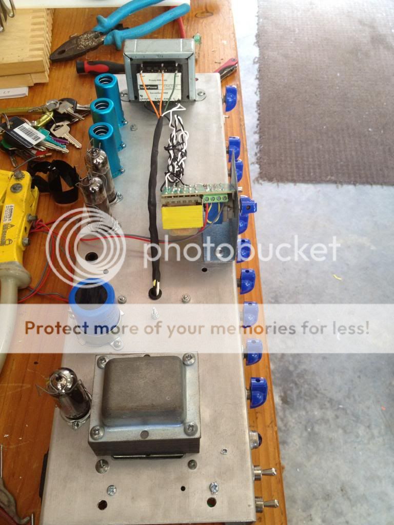

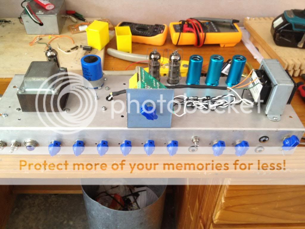

yeah , I know about the tubes, I just grabbed everything together, to make the point that ive already got stuff for the build.
I live in Australia, so i DONT KNOW WHAT kINKO'S IS,(WOOPS ACCIDENTLY PRESSED CAPS LOCK
c3 amps slo 50  is what i have.
i dont mind making my own board, helps me learn more about it, and since i have all these boards and turrets!

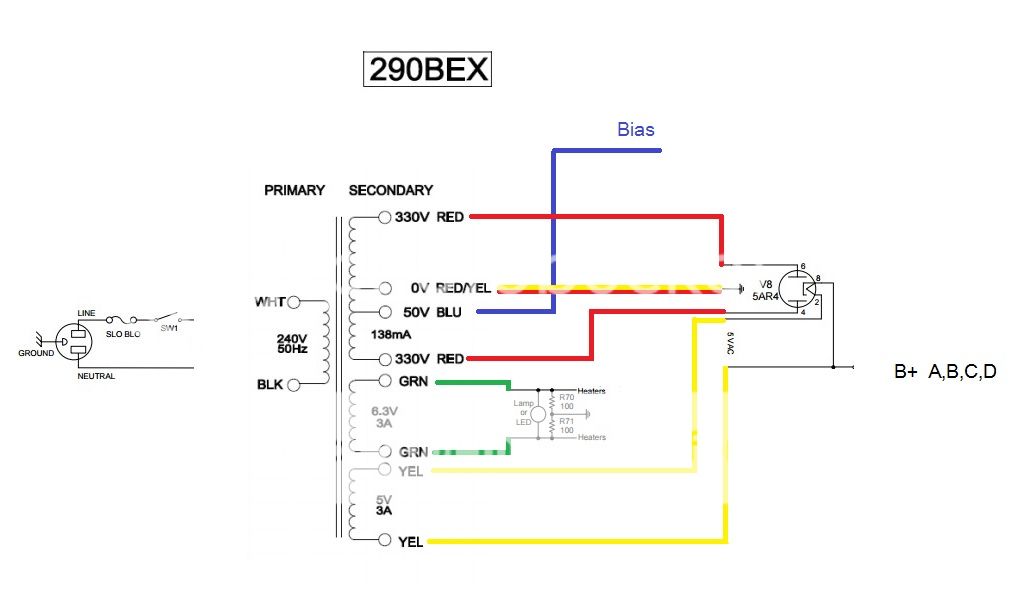

4) do you guys incorporate a bias test probe circuit? and what would the values of the 2 resistors be?
see pic below

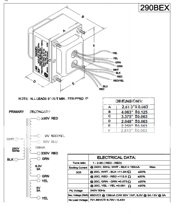

5)  Transformer selection??   240v primaries, however there appears to be some much "voodoo" in iron, and im on a Hoffman site, however is mercury magnetic just all marketing, is iron all iron? any suggestions, again im not trying to make a replica , just a great sounding amp.
6)

Usual values for those bias resistors is 1 ohm which causes the output to read out in millivolts which then translates directly into milliamps. Yes, exactly how you show it. Super clean work there. They need not be fat power resistors by the way. A tube pulling 100 ma = .1 amp (BIG) would cause those resistors to dissipate I*I*R = .1 * .1 * 1.0 = .01 watt.

^ but make sure you use 1% tolerance resistors there.

The Mercury Magnetics transformers are a very expensive proposition for one-off builders.  I would use whatever Fender-type units you can acquire locally at reasonable cost.

so the hoffman transformers and heyboer  are good to use?

^ yes, but check whether Doug stocks the power transformers that can be used with 240v power.

IVe decided to build a 1 channel DR    but instead of asking everyone's thoughts on mods, that i would build it stock on a home made chassis try some mods
then go from there, then once complete i can transfer into a proper chassis.
I just noticed that the parts list for the 1 channel DR uses a 40w  / 6L6 configuration Mojo762    354-0-354
  isnt a DR a 6V6? 041316 transformer  330-0-330??
Im from Australia (240v)   and noticed that Hoffmanamps doesnt carry a 240v primaries for this project, will the following do ? (from Ce distribution)
and would this (see link below) be a suitable multi output transformer? 4Ω, 8Ω, 16Ω
https://www.cedist.com/products/transformer-hammond-output-upgrade-fender-20w-66k
https://www.cedist.com/products/transformer-hammond-240v-deluxe-deluxe-reverb
also is  my wiring diagram correct that i did on paint????
  • Posts: 5282
« Reply #28 on: September 09, 2016, 08:17:47 am »
Transformers and your drawing are fine.

I just finished up with a Hoffman AB763 two channel build. I used a 290BX PT (120V 60Hz) without issue. If you use the Hammond transformer you will find the voltages on the original Fender schematic match very close.
The AB763 lends itself to many mods and I have have tried several. I changed all the caps to 715P series which I like the sound of but what I like may not be something you like.
I only tried a single 1m single pot style PPIMV which I did not like the sound of. I have some other dual gang pots on order to try.
The adjustable NFB was worth the effort to me.
None of any of the mods you mentioned are very time consuming to try and remove if you don't like them. I used 25uf electrolytic caps because I had them in stock. I think they were Sprague as I remember. I try to use F&T where I can and that is what I used on the filter caps.
I took the amp to my friends music store and tried out several speaker cabs. I liked the sound of several single 12" speakers we tried. I also like the Marshall quad cabinet I have.
The reverb sounds great on this amp. The tremolo also sounds good but different from the "roach". I own two other original Fender Deluxe Reverb amps and have always liked both of them. This Hoffman amp and the changes I made cause it to sound a bit cleaner than the originals.
I also ran some 5882 JJ tubes in the amp with the same transformers without issue. I am pretty sure doing that or running 6l6's will cause early failure of the PT. Mercury Magnetics makes some really high dollar transformers that will allow you to run both 6v6 or 6l6gt tubes and the output transformer has taps for both tubes. Pretty pricy stuff.
All in all the Hoffman schematic was a good basic schematic and a little easier to read the the original Fender schematic. I bought a turret board from Hoffman to save time which was worth it to me. I have a CNC mill and can drill the board with high precision but the programing time is not worth it to me.
These guys have been a good company to do business with and I feel comfortable recommending them to anyone.

BTW...I like the look of the heater wiring in sluckey's amp. I may remove mine and give that a try.
