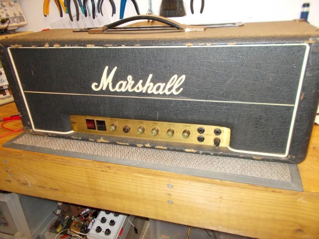

Hi guys, a mate has asked me to give this beast the once over.
It's suffering intermittent volume loss.  :think1:
I have not turned it on just yet as I would first investigate some mods added.
The ppimv is the first job.
As per this schem  http://el34world.com/charts/Schematics/files/marshall/Marshall_marshall1959m2.gif using 82k grid leak resistors.
These resistors have been replaced with a dual gang 100ka pot to make the PPIMV.
I am have done many PPIMV mods but used 250ka pots and these had 2.2m resistors added to the wiper.
This mod DOES NOT have these 2.2m resistors????
I am questioning this mod as there is a crusty 5.6k grid resistor on one of the power tubes.
Can any one supply a schem for the PPIMV used on this amp. Thanks

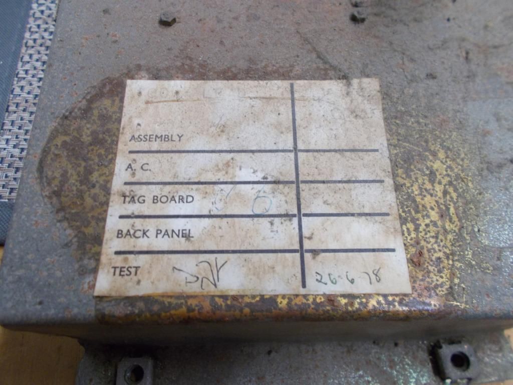

Thanks Jim, Test date is 78, makes the ecaps 38yo, are these ready for a rest. They seem the measure under their marked value.
