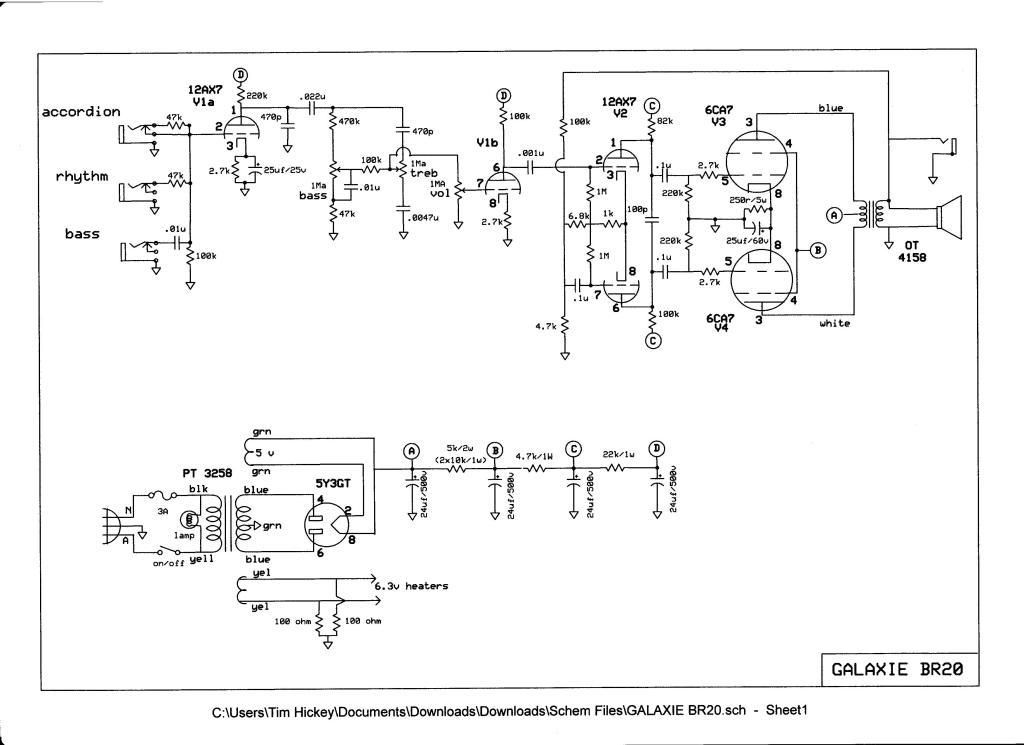

Hey mate, This is a local built amp that I bought as a chassis only.
The circuit had me a bit confused as to why it was only 20w from a pair of el34s.
http://el34world.com/Forum/index.php?topic=18639.msg190688#msg190688
Great sounding amp not too loud.
I'm running a pair of 34's in my cathode biased plexi-clubman, and it specs out at 26W.  Lot to do with B+, bias type, and how hot she runs(current).
but into a good 2X12 you bother EVERYBODY in the house, and some neighbors :laugh:
