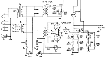

I have a couple of 816 tubes laying around and i would like to build my next Stout using them instead of the 5Y3. I swear i tried to study the Radiotron Designer's Handbook but found it to be too complicated for my age. What i came up with from the book though was that the B+ voltage of mercury vapor rectifiers, before filtering, can be calculated as 0.9 x AC input voltage - voltage drop.   So if i use the same power transformer with 300 VAC and assuming a voltage drop of 10V, would that mean 260VDC at B+ ?  The 5Y3 rectification provides 354VDC at that point. Further, i would like to keep the rest of the circuit exactly the same and only change the input AC voltage. By my calculations, that would mean a power transformer with 400VAC instead of 300VAC. Am i missing something or everything?

« Reply #1 on: November 08, 2016, 09:56:10 pm »
> 816 tubes
Wrap them and seal inside a TupperWare. Call your Toxic Waste office and find where they can be safely taken.
If you want to see Mercury Vapor, go stare at a streetlight. (An old streetlight; halide and LED are taking over.)
Well, no. What that is really saying is that the bottles are not suitable for a Capacitor Input filter. Like all guitar amps have. You need a BIG choke rated for AC on one end (not just a smoothing choke).
You "could" use a cap-input filter but the high peak currents would destroy the tube.
You also need a 2.5VAC heater winding.
You need a delay-relay so the Mercury is warm before current tries to flow.
You also need to pre-heat the Mercury when it is cold, and cool it when it is hot. The last Merc Rect box I had was as much thermal control as actual power.

« Reply #2 on: November 08, 2016, 11:15:30 pm »
You don't want to use those (could end the sentence there) until you have 800+ volts of B+ and several hundred mils of plate current. As PRR said, you'll need a 15+ pound 2.5 volt filament transformer good for nothing else in the amp, expensive unusual sockets, and various delay circuitry. I can't see the justification.

« Reply #3 on: November 09, 2016, 12:14:48 am »
Thanks guys! Good advice but still looks feasible to me. My power transformer supplier could easily produce a 400V , 6.3V , 2.5V secondaries, although i am not quite sure about the 2A needed for the heaters. With that done, next step will be to calculate the values for a suitable choke (or chokes). Last i will think of the delay in applying the anode voltage while the cathode heats. Also, why not fire the heaters with a separate, 2.5VDC source which is turned on before the main power? Looks like a big challenge for a beginner, but why not?
In my old life this was quite common, called it step-start.  There are also time-delay relays, hazmat suits and other things on the web :laugh:

  • Posts: 5377
Re: Help with Mercury Vapor Rectification on Hoffman Stout
« Reply #15 on: November 10, 2016, 12:27:58 pm »
You can run the filaments in series from a common 5VAC transformer.
I've been around for a long time and have never seen a mercury vapor recto in a guitar amp. It may have a certain "cool" effect but I just don't think is practical, especially on a Stout. You will need two 816s for a full wave supply. They may have been more practical in high voltage applications at some time, but better alternatives have been around for a long time.
You can find some examples on youtube. Here's one cool hifi amp...

Most of us would use PSUD2 to get a good understanding of how a draft power supply would perform.  I can highly recommend that as your design tool.  You may be able to identify a similar valve in the default list within psud2.  Perhaps if you try to get a simulation going, and put in the values you know, then it would be easier to get help, as answering your query properly is likely to take 1-2 hours of design effort from an experienced designer, as they would need to fully checkout the data sheet and the background advise articles on that rectifier, and work through what component values would make sense.
« Reply #20 on: November 10, 2016, 11:07:15 pm »
By hand, or with PSD using sand diodes, 350V (each side) into choke-input gives 315V DC. The merc arc will drop near 15V, giving 300V.
The hard bit is the nominal 500mA MAX peak current.
To avoid a one-cycle >500mA peak you need like 200 Ohms in PT and/or choke. This will not be a big problem for reasonable size irons. And I'm not sure a one-cycle peak really counts on old-old technology. (Triggered sweep was not that common.)
The full-wave pair should do 250mA which is a lot of guitar amp.
The choke MUST meet the standard requirements for ample Henries at the expect DC current and large AC voltage swing. RDH has that.
Of course if unloaded the output soars to 350VAC*1.414 or nearly 500V.
This is a free 10-minute design and may not be worth that much or last that long.

« Reply #21 on: November 11, 2016, 12:34:16 am »
Yeh, the 1-2 hrs was meant to cover selecting all the parts from modern stock items, and feeding back the DCR's  and henry, and going through what delays are needed, and whether to use old stock delay switch tubes and which ones, or new relays, and need for bias coordination, and go through peak diode current rating and voltage overshoot, and making up a diode model for posud2, and look at other high power protection issues such as fusing, and whatever else comes up along the path to enlightenment.
