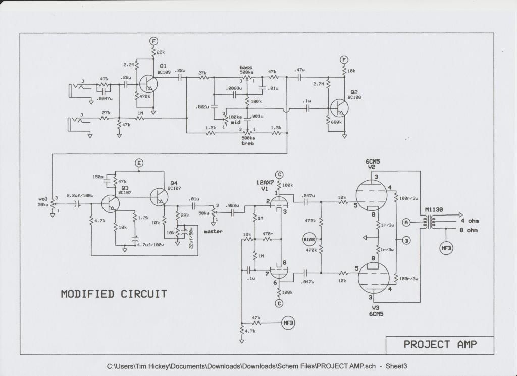

Hi guys, Dug out an old project that is not going to beat me..............
Top schematic is a working circuit.
Second schematic is a working circuit.
Bottom schematic is NOT working.
By elimination I have got it working to a point.
With the reverb "out" connect to the master volume pot as in bottom schematic, there is plenty of bong when touching the springs.
BUT with the reverb "in" connected as per the schem it passes some signal but just barely.
I have tried many options with all having a similar effect.
Could this be a PHASE CANCELING problem as it gives a loud squeal when powering down. :help:
If I counted correct, the output of the Verb circuit is outta phase with the input to the verb.

What does "NOT working" mean?
No reverb?
No dry signal?
Lays on the couch collecting unemployment dole?
Reverb is random phase. Won't cancel.

Hey PRR, What I am meaning by "not working"is that when the reverb"IN" is connected to the circuit as in the bottom schematic it kills the signal to the point that the master and volume are maxed before it is audible and there is both wet and dry signals.
BUT when the reverb"IN" is disconnected the amp works fine and touching the springs the noise is heard.
So this is why I can't understand where the problem is.
Re: Adding a SS Reverb
« Reply #4 on: February 06, 2017, 02:22:23 pm »
Then something is not connected as shown.
In/Out reversed? 47r instead of 47K? Can't tell from here.

Hey PRR, Tried more combinations but with no joy.
I have added two 1k mixing resistors before the volume pot, this has fixed the problem of the reverb circuit cancelling the signal.
I'm just left with the power down squeal. :think1:
« Reply #6 on: February 10, 2017, 06:40:56 pm »
Not mixing, splitting.
If that is a "fix", then the input to the reverb driver is not what you drew. The plan shows roughly 10K looking into the driver input. That a 1K resistor makes a big difference means the input is acting like much less than 1K. Can't see the plan versus reality difference from here.

My thoughts were, there was something not right.
I did the original circuit board some time ago and shelved the project as I was unable to fix the squealing.
Another SS reverb circuit presented itself and it was also a no go.
Rather than try to salvage the board and components I got a new lot.
On close look at the layout of the old board I noticed that the 2N2222a were facing the wrong way for a NPN.(emitter at the top of the board for B+ connection)
So I had a close look at the MPF102 as they also was facing the wrong way. (source at the top of the board for B+ connection)
The MPF102 were totally connected the wrong way :cussing: but were still working. :dontknow:
I'd have to go re-read books, but I think a common collector is kinda sorta like a cathode follower for tubes. :dontknow:
The MPF102 were totally connected the wrong way but were still working.
Drain and source are interchangeable.
« Reply #10 on: February 12, 2017, 02:14:08 pm »
This is why we take DC voltage checks. The wrong-connection would have been obvious. (If not from factory notes, or self-knowledge, by showing to others.)
Though in this case it might be hard to tell.
A BJT transistor "can" work backward. Just really bad. The "collector" won't go over 7V above the "emitter". And the current gain, typically 100, is more like 1.
The Darlington connection multiplies current gain. 1*1 is 1.
So the input impedance is roughly that 100r emitter resistor, times 1, or 100r.
This is too low for the tone stage to drive well. When you padded-out with 1K, now the tone stage can make some signal.
Note though that turning-down the Dwell should also have isolated your near-short reverb driver from the dry path. Was that tried?
On a JFET, Source and Drain are (as 2deaf says) interchangeable for all practical purpose, until you get to specific offset FETs working above 10MHz.
