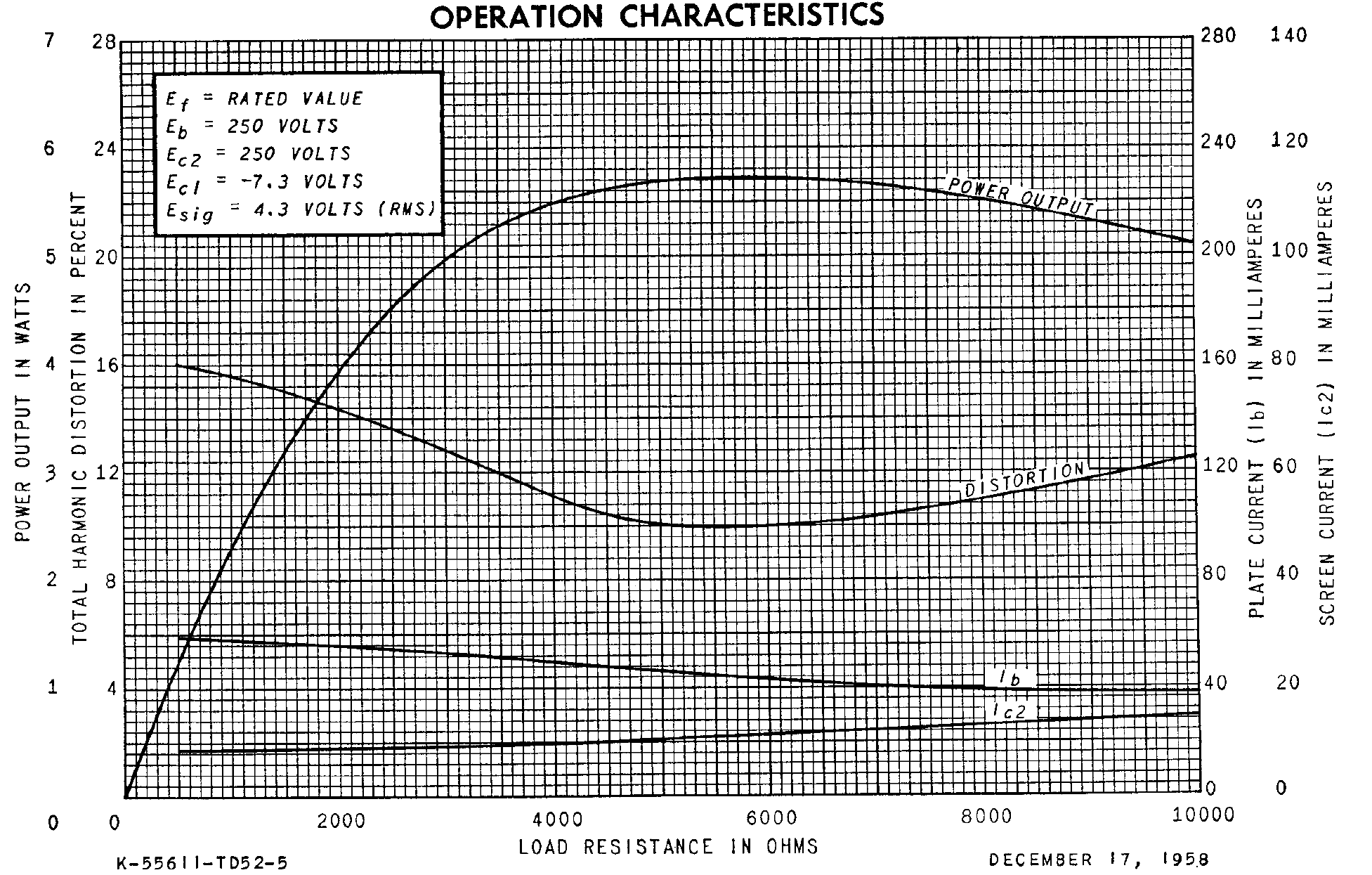

You could look at graphs like this one that plot different stuff vs load.

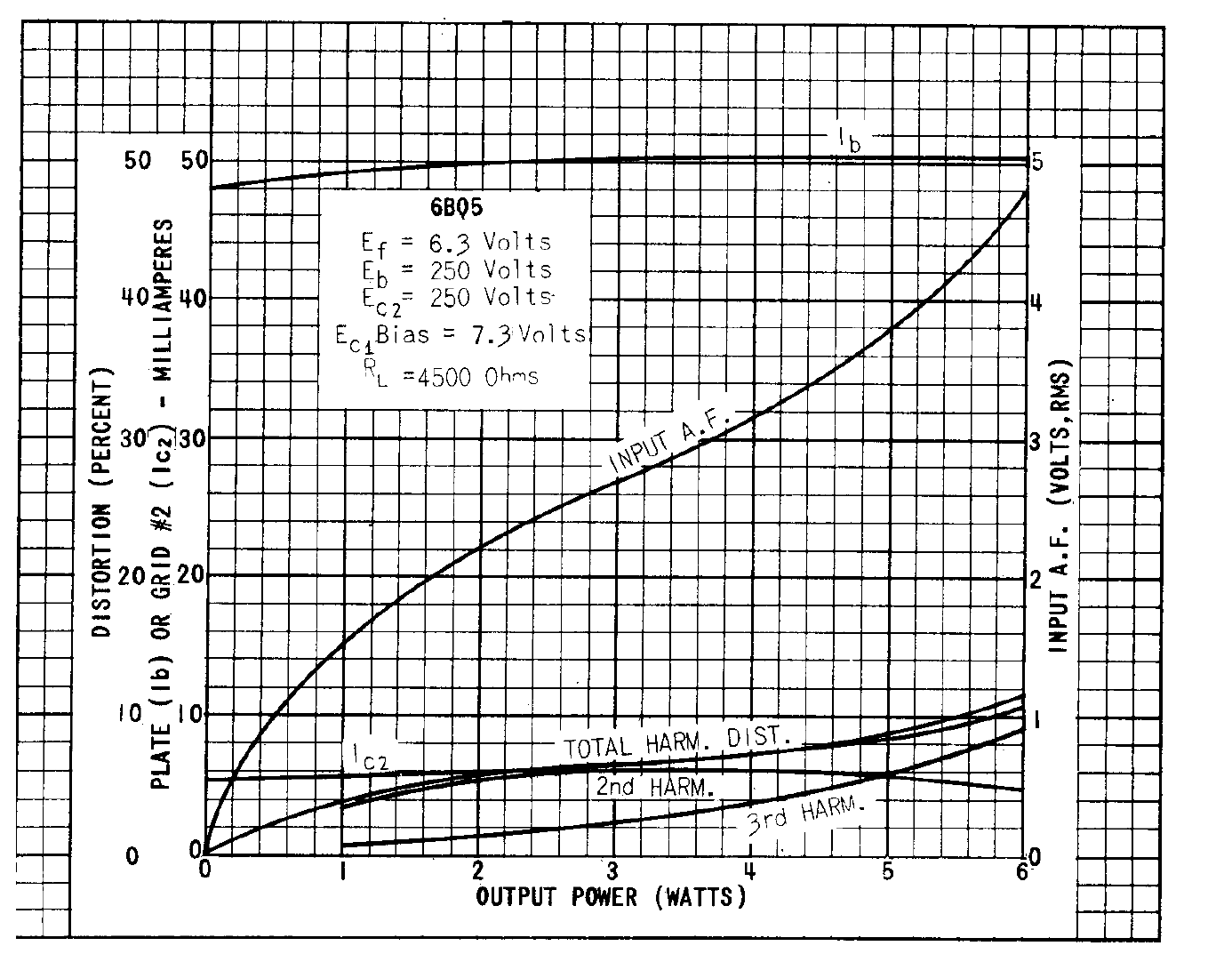

Or you could study graphs like these that plot other stuff vs output power. Each graph is for a different plate load.

> B+ around 350v
The EL84 and similar are 12W-14W Pdiss tubes.
You will lose 10% in OT DCR and cathode bias, 315V.
12W/315V is 0.038A. That's your plate current.
315V/0.038A is 8,269 Ohms. That is a first-guess load impedance for this tube and voltage. Wide variation is acceptable. 5K may bring-out the compressed plate curves under the knee. 10K may be cleaner up to a point and then clip abruptly.

Many thanks to all you friends
Seems that a commercial Champ OT (7K version, there are also 5K), will be a good choiche for this tube at this voltage
PRR, sometime you talk about curves under the knee, this thing is not so clear to me, can you give a brief explanation ?
  • Posts: 11539
Now that's a graph :laugh:
  • Posts: 7919
OK, nice pair of knees, however the difference on being under the knee, instead of being on the top side, escapes me  :w2:

  • Posts: 11539
the better part was over the knees
My understanding is you want to operate on the "long", basically horizontal portion rather than the sharp vertical portion.
  • Posts: 7919
  • Posts: 11539
I lifted this from Merlin's page, I sorta "visualize" a sin wave with zero crossing at the bias point, then see how much it can swing till it hits the "stops", where it begins to scrunch up.
I know, not as original as PRR :laugh:

  • Posts: 5290
If you continue to trace two curves above the knees you will come to a junction. That's the sweet spot!
Those are triode curves. Triodes curves generally don't have knees. Look again at the graphic that prr posted above. The one with the lower half of a woman. Look past the female legs at the curves behind them. The curves take a turn at low voltage. That curve is the knee that prr was originally referring too.
  • Posts: 11539
triode curves
I was lazy and didn't want to superimpose a sine wave, That graph is also about harmonic distortion, but it "illustrates" how a sine wave "operates" in relation to the linearish portion of the graph, (above the knee).
> nice pair of knees
