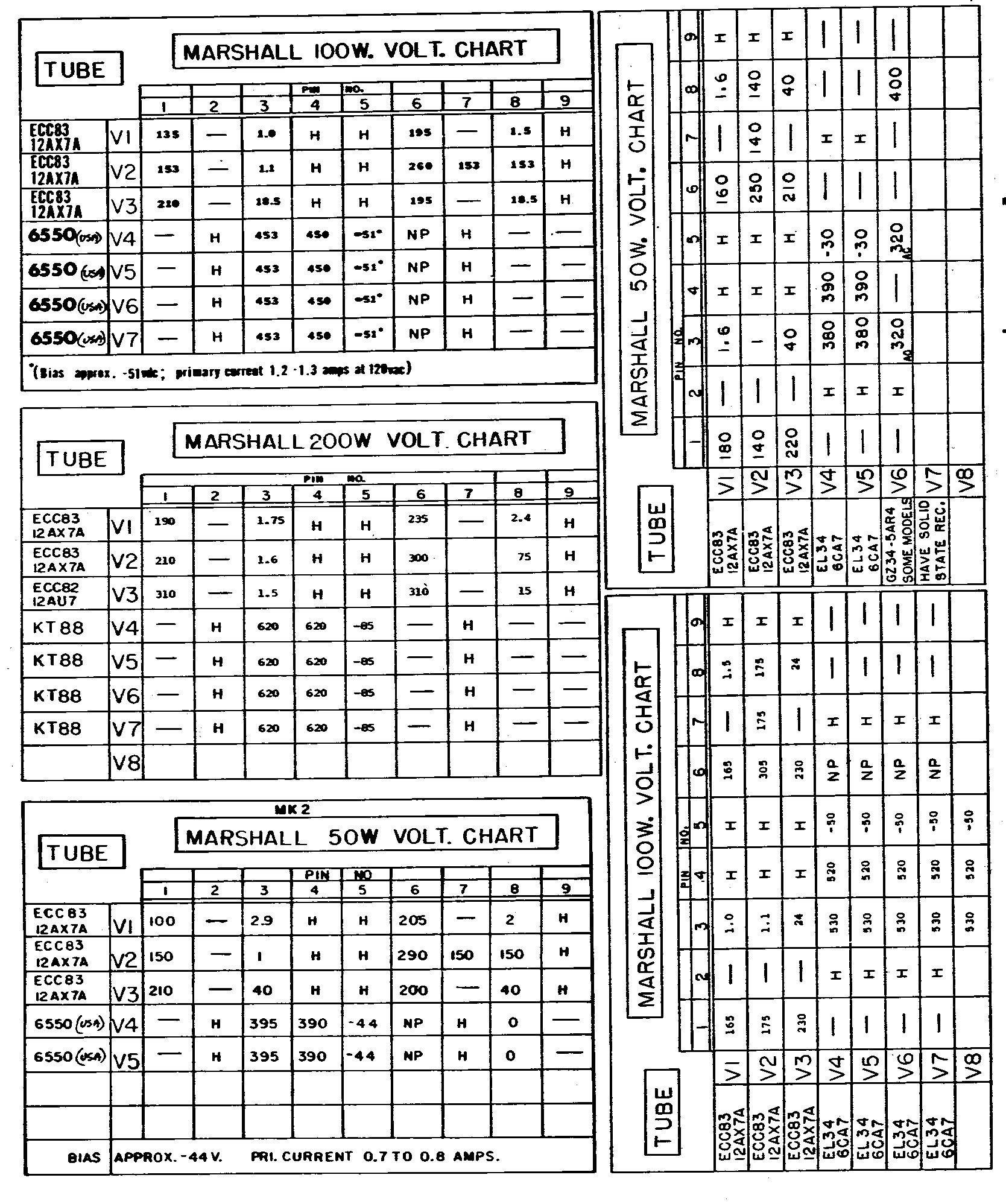

I'm looking at this chart as a reference;
http://el34world.com/charts/Schematics/files/marshall/Marshall_ampchart.gif
It shows 380-ish plate and -30 bias
your #'s look to me to indicate something is sucking voltage down more than it should.
has new/other tubes been tried?
