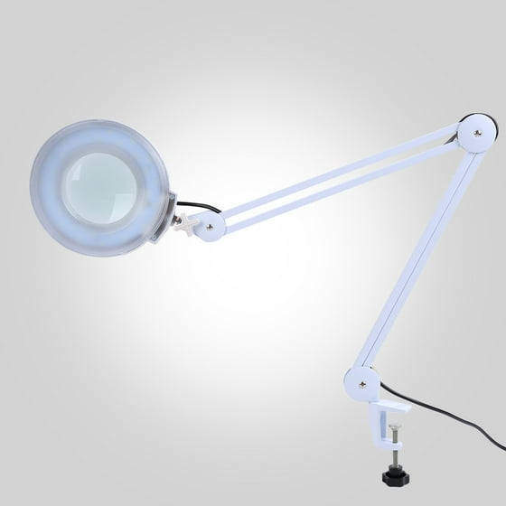

My real problem was making out the writing on the caps themselves.
Eyes ain't what they used to be you know.

I use reading glasses and even sometimes use a big handheld magnifying glass too.

Ya, i've had 40+ year old eyes for 15 years now, and i know the drill.
What i would be handy for work like this is one of those lighted magnifying porthole on a stand type of things, ala
And also, a 3rd hand would be super helpful.

I've had one of those magnifier/lights on my bench for over forty years. It was great when I was younger. I still use it for a light source, but rely more on reading peepers and a handheld magnifier. Plus I wear a LED headband light when working inside a chassis.
