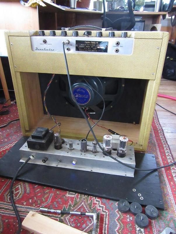

« on: March 11, 2018, 10:15:16 am »
This is an early 60s Dano model 299 Twin Twelve that I converted into a tweed single Fifteen.  It's been recapped and new tubes. I'm having trouble figuring out how to bias the two new JJ 6L6 tubes I just put in.  This is the only schematic I'm able to find, only mine is a Twin Twelve with two output tube instead of four.
http://el34world.com/charts/Schematics/files/danelectro/danelectro_twin15_1961.pdf]

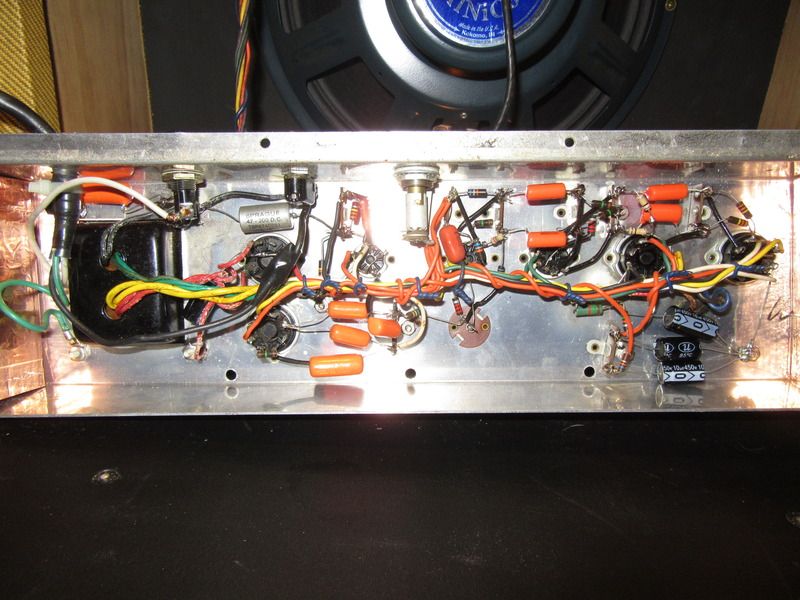

All of the other tubes are the same.  I measured 353v plate voltage then 76 and 75 amps from OT to plates.  That puts them too hot at around 26 watts for 6L6 at idle?  I can't figure out looking inside the amp where bias is adjusted.  Its a big harness of wires inside and it looks like all the pin 8 cathodes are linked from tube to tube.

I'm pretty sure this amp is cathode biased, but the 12AX7 filaments will probably be in the cathode circuit of the 6L6s so that really complicates changing the bias by manipulating resistor values.
I would be wary of that twin 15 schematic. Better to just draw your own schematic. But as a minimum, trace out the circuit from pin 8 of the 6L6s and report what you find. Also trace out the filaments for the 12AX7s and report what you find. If they connect to the filaments of all the other tubes, you're in luck. But I bet you will find they connect back to the 6L6 cathodes (maybe thru some resistors).
You may just have to accept the bias as is.

Please re-study the cathode system. The two 6L6 pin 8s connect to each other, but then surely go to 4,5/9 of the 12AX7s.
A cathode-bias amp WILL run near 100% of rated dissipation. 26W in new JJ should not be any problem.
As this is biased by heaters, and probably lacks the extra resistors used on the four-6L6 job, there's no simple way to change bias. The current MUST be enough to light the 12AX7s. If repeated power-bottle failures happen, then reduce the B+ somewhat.

I got some help finding a schematic that matches and confirmation the power tubes bias goes through preamp filaments.
Silvertone 1394
  • Posts: 5402
Re: Danelectro 299
« Reply #7 on: March 13, 2018, 10:54:03 am »
Good find! I had looked at the Silvertone 1394 Chassis 185.10300. I dismissed it because it used a 6SN7 for the PI.
Nothing to do about the bias. Just accept it. It'll be OK.  :wink:
