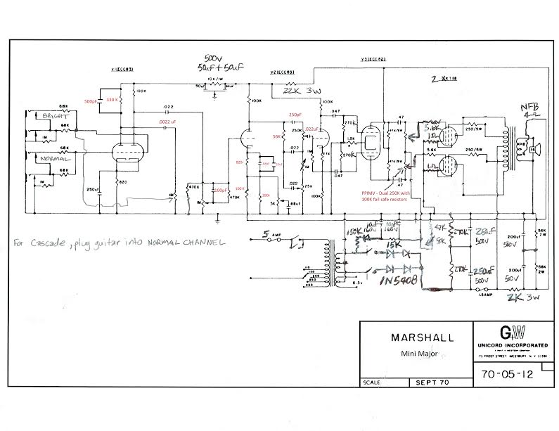

I am questioning the filter cap values     there a 2-seies  jj caps 390uf  with no ballanging resistors
The Major model 1967 uses two 375µF caps in series and they don't require balancing resistors because the HT center tap is connected to the junction of the two caps. This arrangement forces equal voltage across each cap. Those 390 caps are fine.

just got this schematic with new updates ,     as per micheal r/t . not  sure if  moratto used this on my build . no longer dealing with him because of this build .

Fizz often indicates instability, especially at higher frequencies.
The amp's design looks poor, as the tone controls are within the NFB loop, hence will introduce variable degrees of phase shift within the loop depending on the particular settings.
The shared, unbypassed cathode resistor at the driver stage may present opportunity for a local positive feedback path to manifest when the plate currents are not well balanced, eg during overdrive, poor balanced sections.
I suggest to fully bypass the driver stage cathode (eg 100uF), and to add grid stoppers (eg 10k), mounted at the socket terminal, to every stage where they're not currently present, and then re-appraise the issue.

dropped it off the church audio , getting the transformers  scoped , and checking  the circut l design build .    updates to follow in a few days
