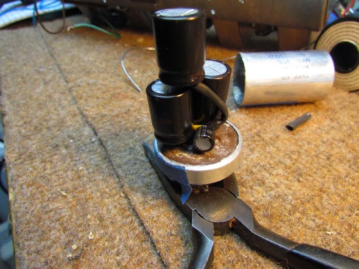

I have read several of the posts here on the GA-40 LP but I didn't see anything specific about replacing the Cap Cans. There are two cans on my 1954 LP. The 1st one has 2 caps in it 20uf/450v & 10uf/450v. The 2nd also has 2 caps, two 10uf/450v. The cans are rather tall & skinny and are riveted to the chassis. I cannot find identical replacements and am wondering how others here handled this. I have room for using single caps but will need to figure out their mounting. If I do that, I'll just leave the old ones in place & disconnected. Any thoughts/advice?

I'd just use individual axial caps.

Give a look here
http://metro706.hostmetro.com/~archradi/restoration/electrolytics.html
or use standard radial e-cap (less expensive than axial ones)
of course go to good quality capacitors with your choice

Rebuild the cap can. Cool idea! Thanks for the pics & link!

« Reply #4 on: August 24, 2018, 12:34:58 pm »
For a 1954 amp it can worth the effort

I rebuilt a GA-40 a few years ago. I disconnected the cans, left them in place, and found room for 4 axial caps. If I were to do it now I would likely use the F&T axial dual caps - 1 32x32 and 1 16x16 as there is limited space in the chassis.
