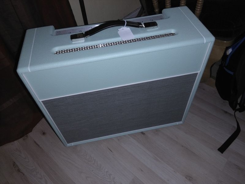

It comes with a beautiful brushed aluminum chassis, big contrast to the slightly homemade looking chassis on the 6M45 kit i built some years ago :grin:
The cabinet is very beautifully made too. But chassis only mounts to the thin backplate with 4 screws, there are no mounting points inside the cabinet :w2: is this normal on an 18watt cabinet.
Looks to me there shall be easy enough to add some wood blocks on each side of the cabinet interior and the chassis have already some holes drilled that on my view can only be for such mounting....
Possibly it can be intended for the 45 and 50 watters with heavy transformers.... The 18watt is not very heavy....

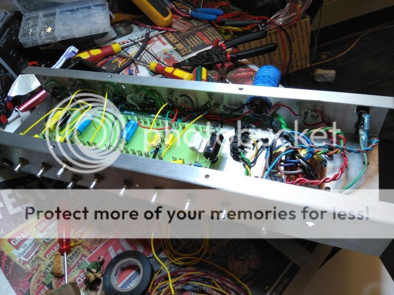

« Reply #5 on: January 10, 2019, 07:33:14 am »
Got started with the heater wiring now

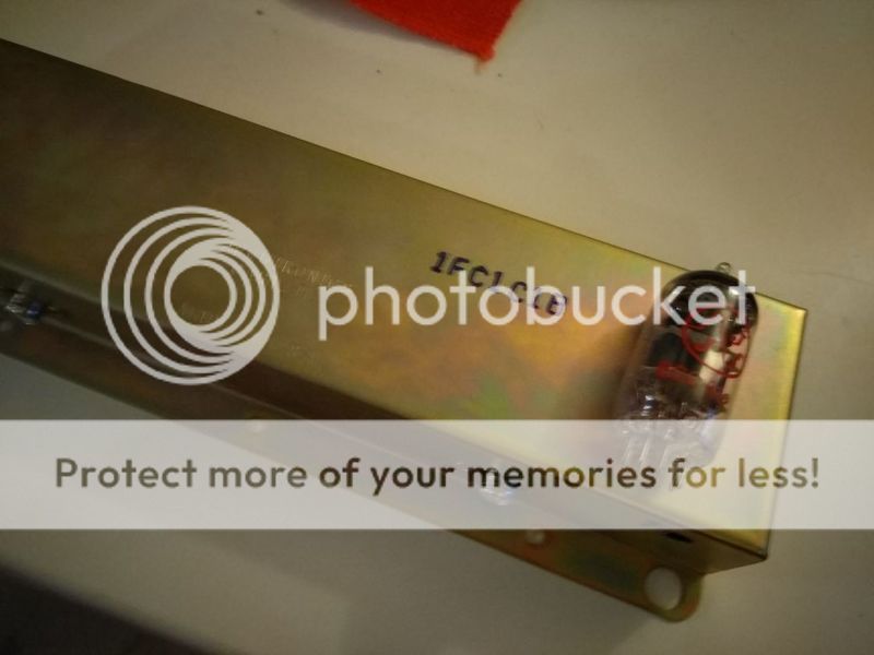

« Reply #6 on: January 10, 2019, 08:25:08 am »

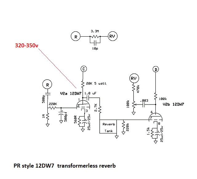

Found this in my stash of parts. An ecc 83/12dw7 and an made in usa accutronics reverb tank. It is a short 2 spring short decay. Will it be too wimpy for a  reverb on this amp. It have an imput impedance of 1975ohm and and output impedance of 10k. Will the 10k output impedance make the output signal too weak to be useful....
  • Posts: 5397
Re: Weber 6M18 kit
« Reply #7 on: January 10, 2019, 09:13:48 am »
The 10K output is not a problem but the 1975 input will not work with the typical transformer driven circuit as found in most Fender amps. Probably gonna need a cap driven circuit. Look at some Ampeg schematics.

Yes i was planning on a cap driven reverb. Will a 1.0uF cap be good for this..?
  • Posts: 5397
Re: Weber 6M18 kit
« Reply #9 on: January 10, 2019, 02:02:05 pm »
I've only had two cap driven reverb pans. One used a .47, the other used a 1.0.

I was thinking of using this circuit. Only change the input capacitor to 1.0 uF and the resistor between R and RV to 150k. Any thoughts about this....?

« Reply #14 on: January 22, 2019, 04:27:55 am »
Reverb application have so far been a complete fiasco :help:
But amp actually sounds good on both channels. I have to fix some noise and hum though.
I think i will make a new turret board for this because of some layout issues. Mainly having the PI tube between the two preamp tubes. On a TMB circuit on my view it make no sense, but on a trem circuit i may look some more natural...
I will then implement some room for the reverb circuit components as well on the turret board...
