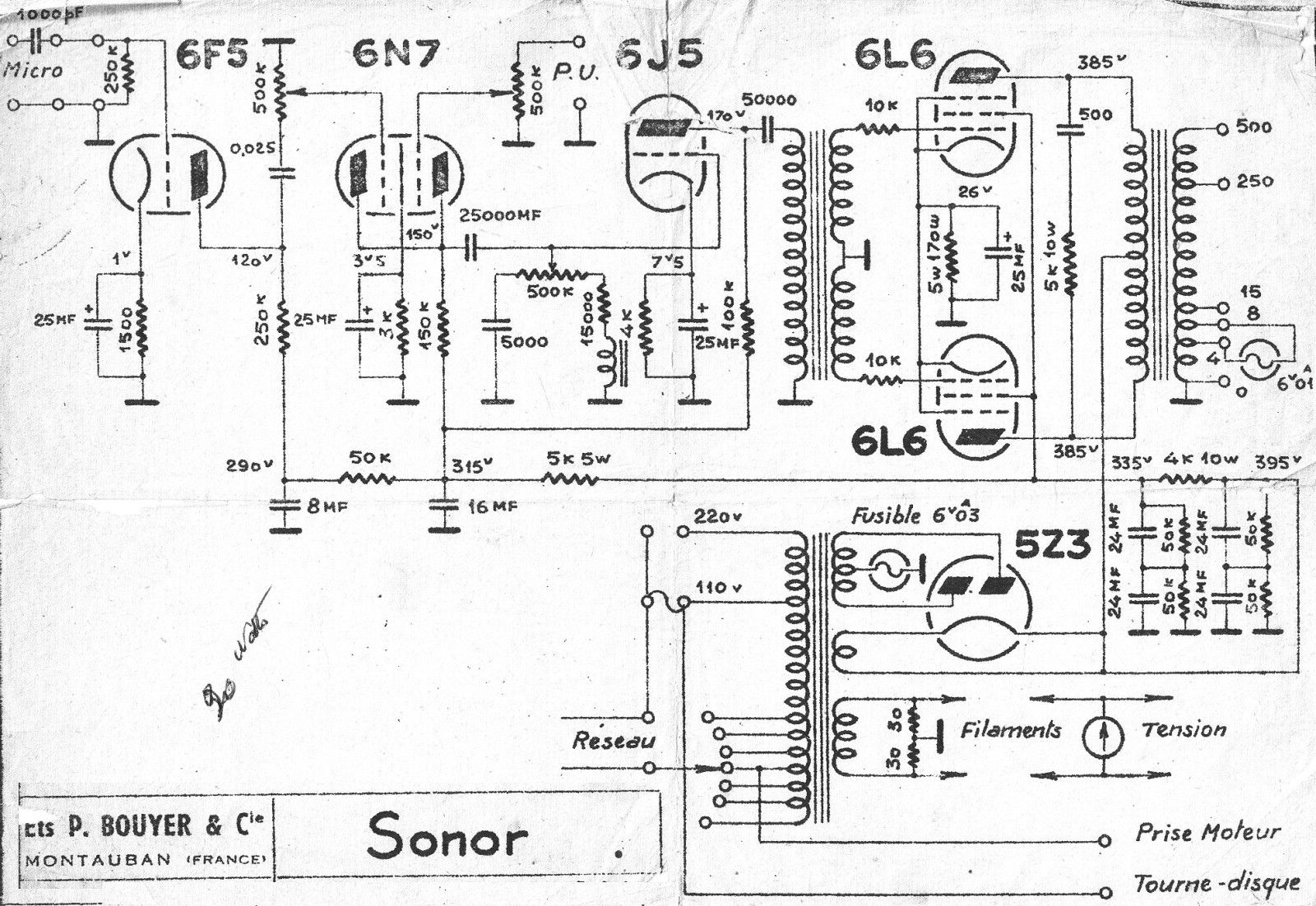

> draw an as is schematic. .... How the heck do you draw a 6F5? ...How do you show wires to the top and bottom?
Normally a schematic is NOT about mere mechanical details like whether a wire goes in the bottom, top, side, or up the backside.
https://www.radiomuseum.org/images/tubeenvdiag_klein/6f5.png
http://a53.idata.over-blog.com/3/44/57/30/AMPLIFICATEURS-MONOPHONIQUES/AMPLI-20W-BOUYER-SONOR-1952-6F5-6N7-5J5-6L6x2-5Z3.jpg

The image showing "pin 9 of Octal" is from some folks who "need" to number EVERYthing. I'd just call it "cap".
