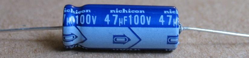

BTW, those 50V bias caps are in danger. I would replace them with a single 47µF rated for 100V.

Are there any considerations when choosing a cap for this job regarding the voltage? I have found a few that are pretty high voltage (350, 450 etc). Other than size and cost are these suitable replacements?
Look at the voltages in your reply #6.
  • Posts: 5397
Also, I knew it was underrated.... just didn't fully realize what would happen if they ever failed. Now I'm a lot more worried and anxious to replace them. hah. Are there any considerations when choosing a cap for this job regarding the voltage? I have found a few that are pretty high voltage (350, 450 etc). Other than size and cost are these suitable replacements? Thanks again!
You don't need a 350 or 450 volt cap. Sure they'll work just fine but may be too big to mount on the bias board.
Click on the capacitors link at the bottom of this page. Buy this one...
Surprisingly, Fender used a 25µF @ 50V cap in that amp when it was built!   :huh:

The ELEPHANT here is 63V on 50V caps. *Don't talk about it, fix it!!* When these caps fail they may go SHORT. Then the power tubes have NO bias. Their current will go up about *ten times.* It is July 31st 1970 all over again. NObody wants that. 63V caps are OK for a weekend. 100V caps are the better plan.
5881 was a heavy-duty 6L6G. 6L6GC has even higher ratings than 5881. While I suspect the 5881 made by Tung-Sol in the 60s were at least equal of G.E.'s 6L6GC, this amp was MADE for 6L6GC and worked them hard. I hesitate to agree with the original tech, but can't say he was wrong. After a major blow-up it would be quite right to use the tubes *Fender* specified. The Tung-Sol 5881 is an upgrade for the OLDER 6L6G in older amps, and was stock in the 5F6a, but Fender moved to 6L6GC for some reason. Yes, maybe price! But 48 years on this is all moot. We can't go back to the prelims of Jim Morrison's trial (10 Aug 1970).
Replace those caps!!
IMHO this was the original failure. Fender probably used the right-Volt caps but had a random failure (caps or solder joint). Like my Bogen with a bad joint, things finally go wrong with spectacular smoke. At this date there is NO way to discover the original problem. And no real use, because other problems will happen.
Thank you, it had slipped my mind entirely to check the store here haha
Yeah it's a mystery to me as to why that was in there from the factory.... doesn't the layout notate -51 volts even back in the 60's with their lower wall voltages that's still above the rating  :dontknow: ?
