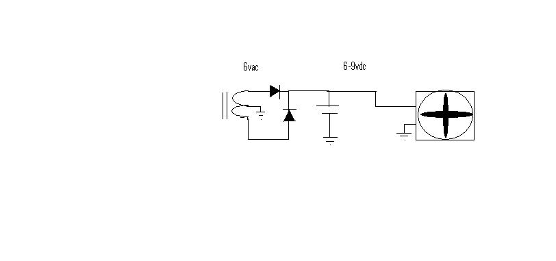

Try this, maybe only 6 or 7 volts to fan but quite and works fine, have fan suck air from tubes, use a 220uf/10 to 20v cap.  1N007 diodes
You would need a 6.3-0-6.3 (12V w/CT) PT for that circuit.
The voltage wouldn't be 12 vdc to the fan, but normal common heater circuit with CT would supply around 7 maybe 8 vdc, enough to run that 12vdc fan.  The voltage might not be high enough to kick the fan on but my experience is that it is, and it runs slower, quite but enough air flow to keep tubes cooler, true...?
Does he has a 5V rectifier tube tap:
« Last Edit: January 06, 2020, 04:59:33 pm by dude »
  • Posts: 5282
Re: Voltage doubler putting out 3 to 4 times input voltage
« Reply #22 on: January 06, 2020, 05:32:14 pm »
Not with that 2 diode conventional rectifier circuit you posted. That circuit will only give about 4.5VDC.
