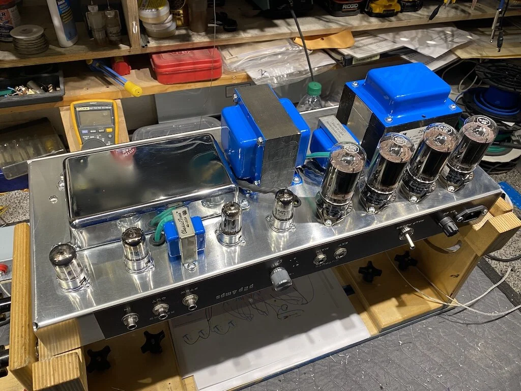

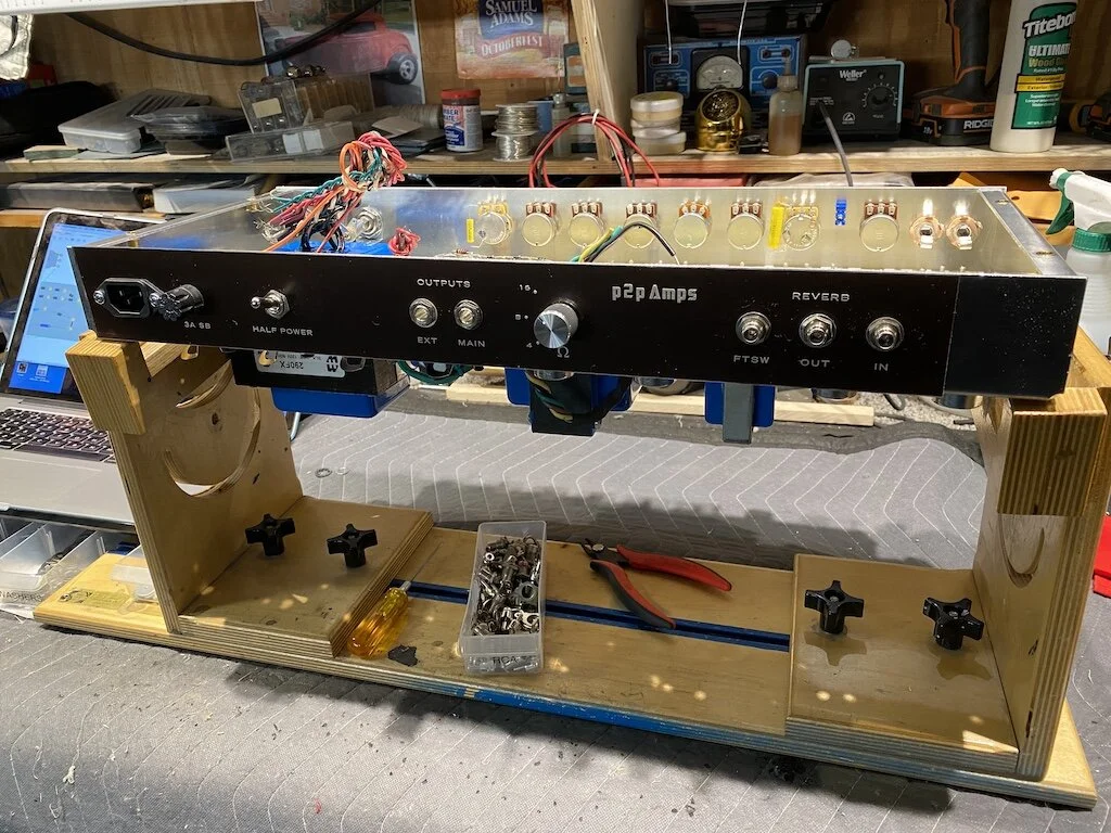

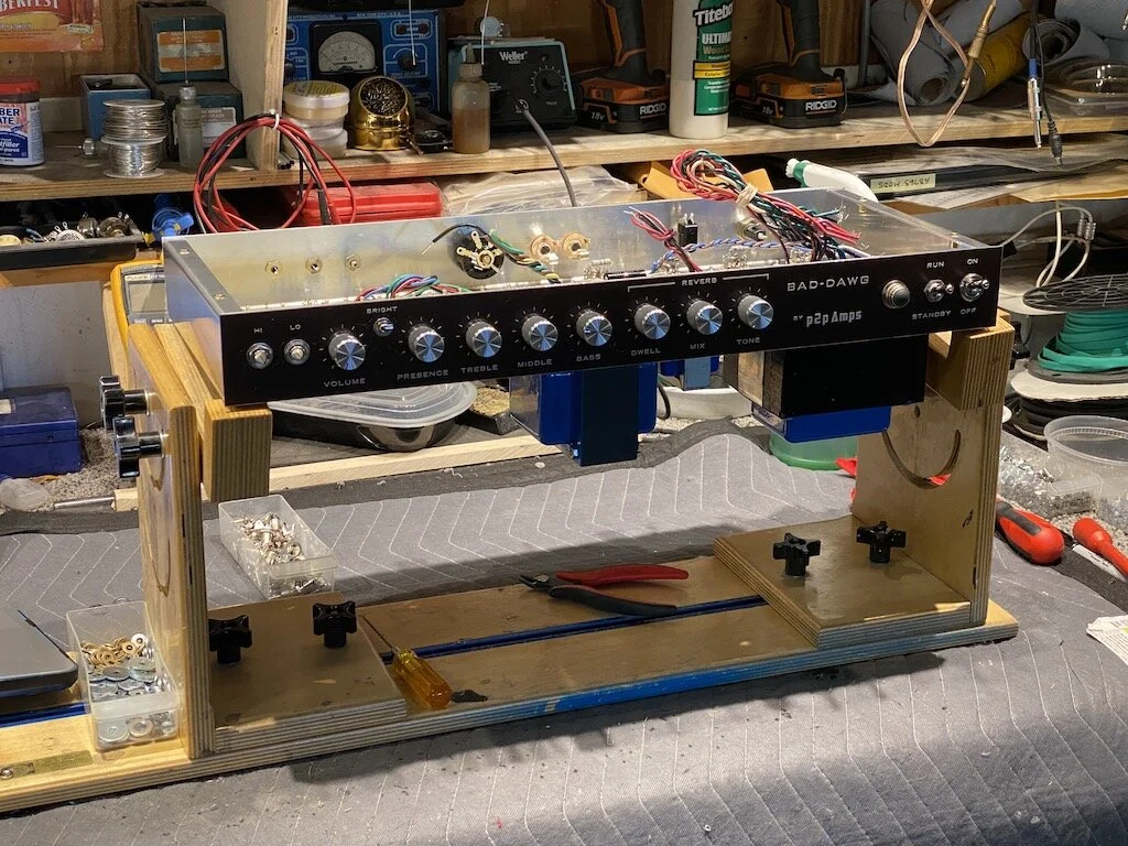

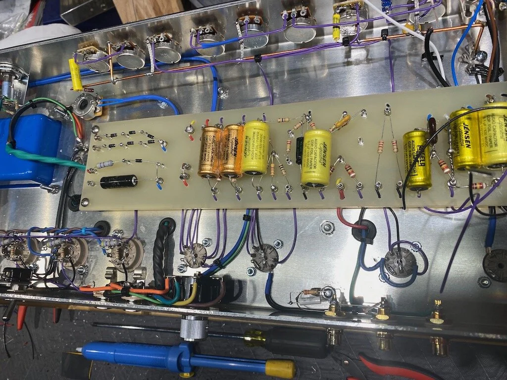

Hey There Amp builders,
Here is a little Diddy I'm playing around with.  It's a single channel AB763, no tremolo, 3 knob reverb, 1/2 power switch, Presence control, 4-8-16Ω, 4 6L6GC just for fun :)
Thanks to Doug for a great turret board.  I am hoping for loud / clean amp for steel guitar players or players that dig using pedals etc.  Thinking this will need to be a 2x12.
Anyway, here is a link to see all the pics so far if you like that sort of thing.
http://www.p2pamps.com/bad-dawg

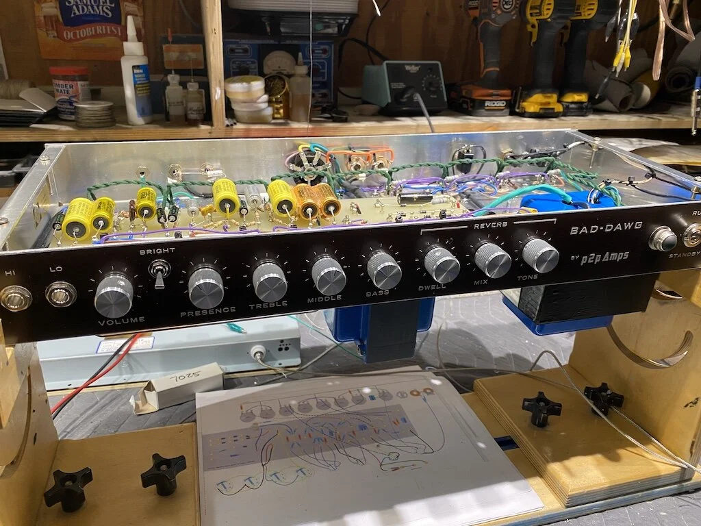

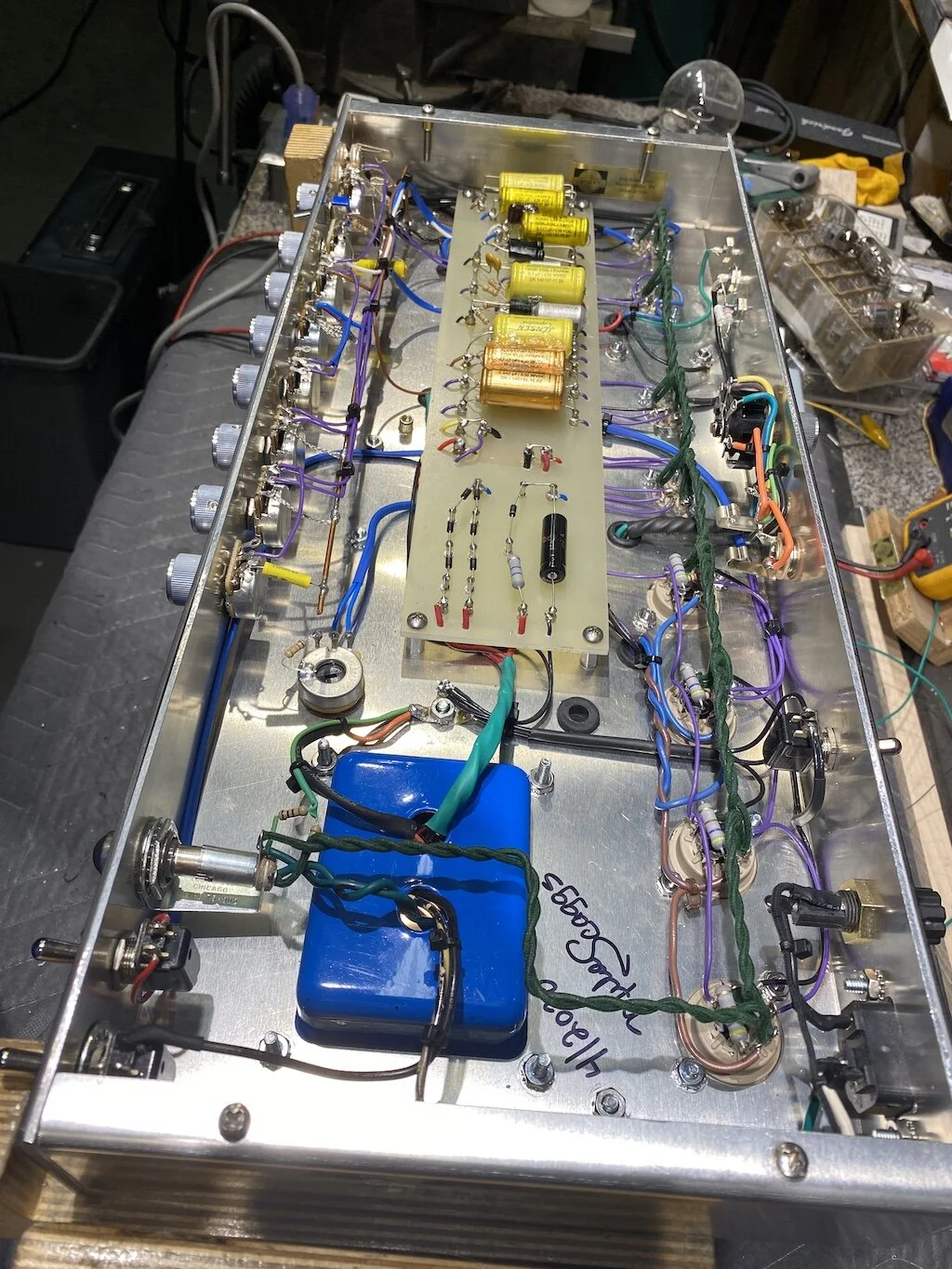

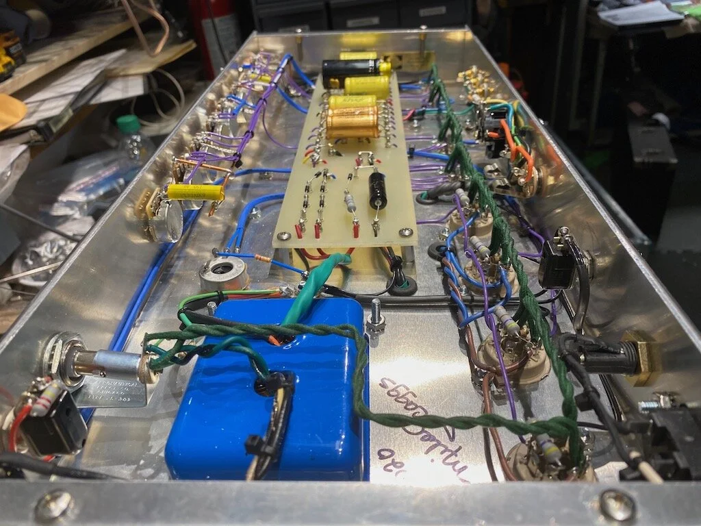

Is there an instructional out there on how to do a similar ground buss?  I looks amazing.  I don't love the idea of grounding to the back of the pot.   I'm at that stage in rebuilding an amp as we speak!
SW
Offline p2pAmps
  • Posts: 930
    • p2pAmps
Re: Single Channel AB763 project
« Reply #6 on: April 28, 2020, 09:11:02 am »
Check out the Aiken's site on grounding.  Basically that bus connects with a bolt through the chassis directly in front of the inputs.  The only thing I ground on the bus are the pots.  There are also other tabs at that point where the bus is connected for other things like Cathode caps, reverb transformer, filter caps (except #1).  At the other side of the chassis next to your PT is where I ground #1 filter cap, power tube cathodes, artificial center tap, transformer, bias supply.  I ground the AC mains by itself.
So far (knock on wood) it's worked out well for me but I am WIDE open for other thoughts and improvements.

  • Posts: 3227
« Reply #7 on: April 28, 2020, 05:08:53 pm »
Very nice..  I did one of these single channel AB763s (DR) too, fun. Mine was flipped upright like a Marshall   I did mine from scratch.   I really like the blue paint on the endbells..   very nice touch.

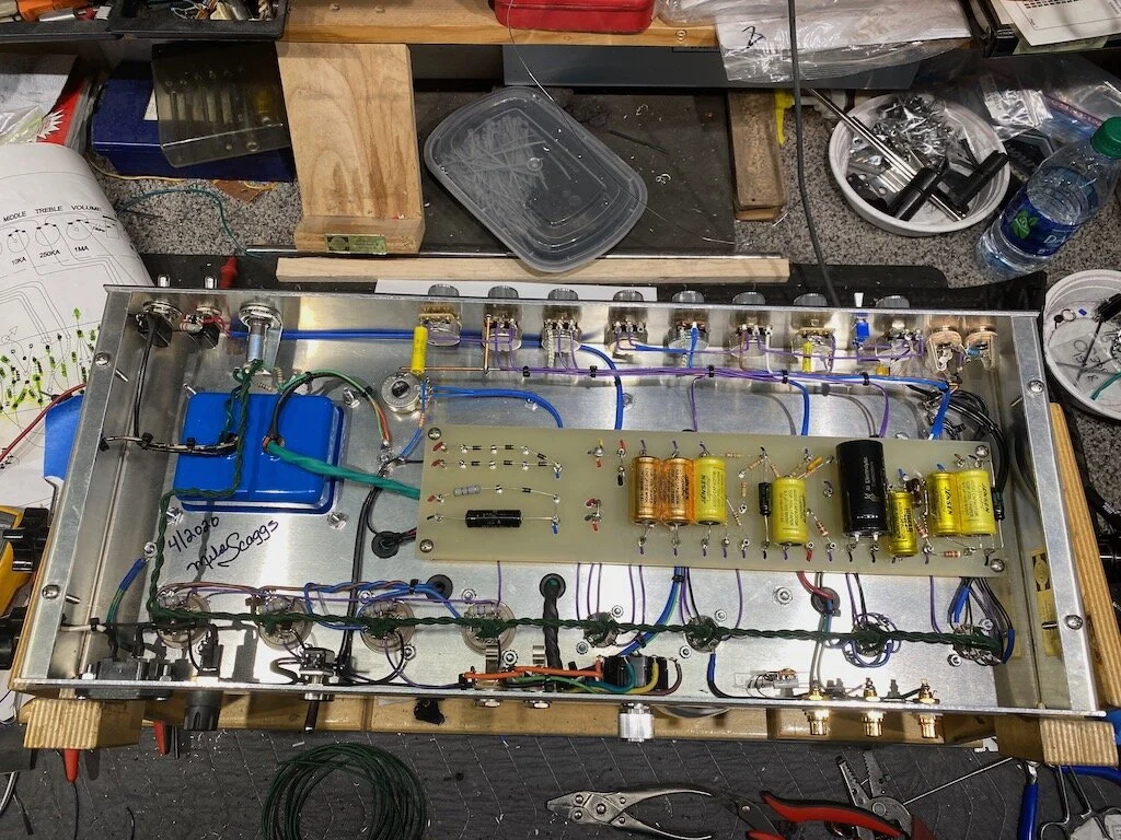

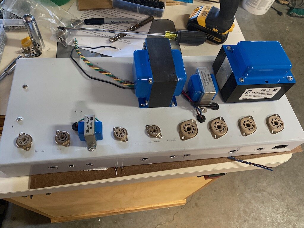

there is probably a reason the reverb transformer is turned 45deg. offset from parallel/perpendicular planes on all the blackface and silver face fender combo amps with reverb.  :dontknow:
my thoughts are by rotating the transformer 45deg., fender is keeping the winding window eddy currents from firing directly into the driver tube and recovery tube.
  • Posts: 3227
« Reply #9 on: April 28, 2020, 08:29:50 pm »
Interesting Pete  now I will look at mine to note orientiation of the reverb transformer
Hey Pete,
I thought about that aspect but thought I would try it this way and see what happens, kind of an experiment.  When I did research on the subject of verb transformers the consensus was Fender did the angled tranny for space reasons.  Others say they have done what I did without any issues at all.  I think some Marshalls did the same but not 100% sure on that.  This is a sort of journey for me to see what I can and can't do and what is fact and what is speculation.  At the end I want a killer sounding amp for both Steel guitar and standard guitar too.  Filling her full of Jensens is also an experiment as I have to know LOL...

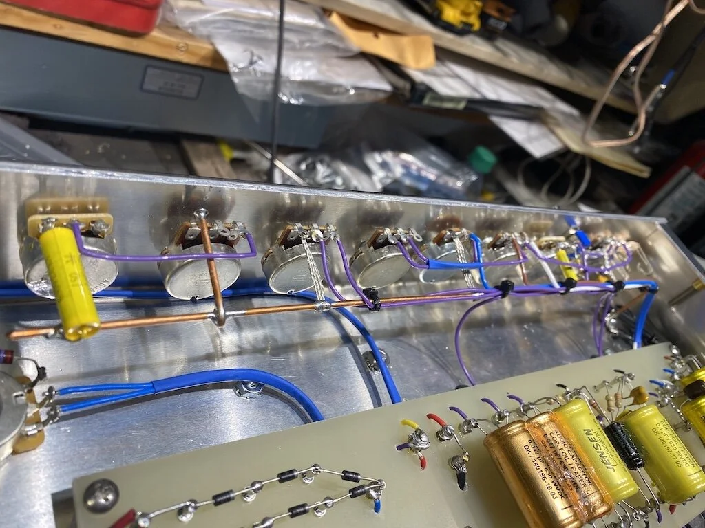

I couldn't help noticing the solid copper connecting your Reverb Mix pot to the ground bus.  I assume you did that for structural reasons, i.e. to keep the wobbly end of the bus from wobbling?
Ed
Offline p2pAmps
  • Posts: 930
    • p2pAmps
« Reply #12 on: April 29, 2020, 09:56:14 am »
Ed
BINGO, looking to keep the bus from moving around...

Waiting to hear what you think of the Jensen paper/oil caps.
(Sent you a PM.)
« Reply #15 on: April 29, 2020, 03:00:18 pm »
Cheers,
Hi Mike!
I've always paid close attention with my grounding schemes. It really is a learned part of building that people only learn about once they deal with their issues from not understanding it. I draw an analogy to boating (in the ocean, not lakes or rivers) where people just want to focus on the sailing and destination aspects. But once there, they realize that they have to find a way to securely stay somewhere, lol and there's no mooring or docking available nearby. So they need to anchor. There's many books that focus on just this one aspect. I think proper grounding, along with layout, is like a dirty little secret to success most just don't quite get? It's not sexy, doesn't have gain stages and special switching...so with most it's who cares? With all this I'll just say don't mix signal grounds with chassis grounds. Signal grounds are a return path for the signal and leave it at that.
Did you or do you ever use the listening device test when you place your iron (the OT at least)? If I don't place my OT on the other side of the chassis (usually the case) then I always do this before drilling any holes...

wondering if insulated terminals/standoffs would do a better job of support for you than the lugs of potentiometers.
https://www.dropbox.com/s/lv69ay14j95rt56/20200429_150017.jpg?dl=0
keystone electronics & cambion mfg. them. available from mouser, et-al. prices range from $4 to $12+
Offline p2pAmps
  • Posts: 930
    • p2pAmps
« Reply #18 on: April 30, 2020, 07:09:48 am »
Thanks Pete!  I like those stand offs but a little short for my project.  I can certainly make some however.  Good tip - Thanks!

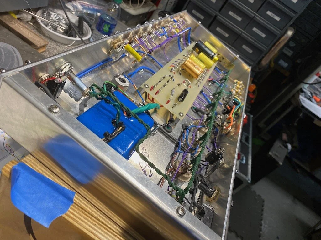

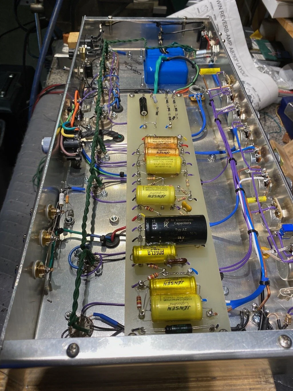

This is the completed chassis for my latest beast. This amp is based on the famous AB763 with some twists.  One Channel, No Tremolo Circuit, Presence Control, Modified Tone Stack, Reverb (Dwell, Mix, and Tone Controls) 1/2 Power switch, and Multi Impedance.  POI Jensen coupling caps throughout and F&T filter caps.
First tests are great!  Very quiet and powerful.  The tone through my shop test 12" is big and bold.  I can't wait to hear this through a set of 12" quality speakers.
Next, I will get started on a 2x12 combo cabinet for her.
As always, thank for the interest and thanks to all the great folks on this forum.

Looks great Mike.  :icon_biggrin:
Did you polish/buff the B+ filter caps dog house?
Offline echuta13

Assuming that the presence control is of the standard type, ie in the power amp NFB loop, I'd advise against putting it back there by the vol control. As output circuits close by inputs/early stages can give rise to stability problems.
Hopefully you'll get away with it  :icon_biggrin:
I did because I am basically insane LOL
Everything Affects Everything
Thank you.  Yes it is in the NBF loop and apparently I did get away with it as it works perfectly and the amp is VERY quiet (so far).  I appreciate your feedback and I will take a deeper look at what you are suggesting.
Cheers!
I was reminded about RG Keen’s excellent page on the topic (thanks shooter!) http://www.geofex.com/Article_Folders/lead_dress/lead_dress_in_tube_amps.htm

I like the ground buss.  I’ve never seen (or noticed) the signal wires being tied to the ground bus.
I am working (painfully slowly) on build where I used a vertical terminal strip to hold the far end of the bus.
Nice work Brewdude and good idea on your ground bus for sure.
