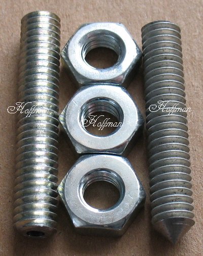

Ciao Doug
If I can permit me to suggest
When you finished the Pick & Place Machine plus the Feeding Machine
I think it will be useful you arrange your Pick & Place Machine Board "Bed" with an Under Plate (Bottom Plate) with installed a whole set of Pointy Tools (number corresponding to the max number of turret holes you can have in a board)
and
a Counter Board with a whole set of Hole Tools (number corresponding to the max number of turret holes you can have in a board) to be placed on the Top of the Pick & Place Machine Board "Bed" (and bloked in some way, like Threaded Rod that engases holes on the perifery of the Hole Tools Board or other way you think will perform better)
The Under Plate (Bottom Plate) will be moved UP (and down) with a small Hydraulic Piston (or perhaps Pneumatic Piston)
Something like this
Hidraulic
Pneumatic
This way you'll be able to lock (block) all the Turrets present on the board at the same time
Alternatively, to avoid secondary problems (how to leave spikes marks on places where there are no turrets), may be you must mount on the Under Plate (Bottom Plate) only the Pointy Tools corresponding to the Turrets placed for the specific Board you are building
I hope I explained what I mean in a comprehnsible way

That would be a very different and separate machine
It has to do the same thing as my manual machine does
X & Y axis holds the board level and moves it over the tools
Two powerful motors bring the tools together to swage the lugs
Do you think it will worth the effort to implement a logic movement to press one turret at a time
instead to press it all together ?
I think that if the Under and Upper Boards holding the Point and Hole Tools are build enough strenght you can be quicker on your job and press all Turrets in one time
If you prefer you can build a stand alone unit to perform this job instead to integrate it on your Pick & Place Machine
Of course they are only ideas and must be compared with your experience and preferences of realization

Turret lugs have to go up inside the top tool
They are held firm at their basses, not their tops
They are soft brass, not steel
