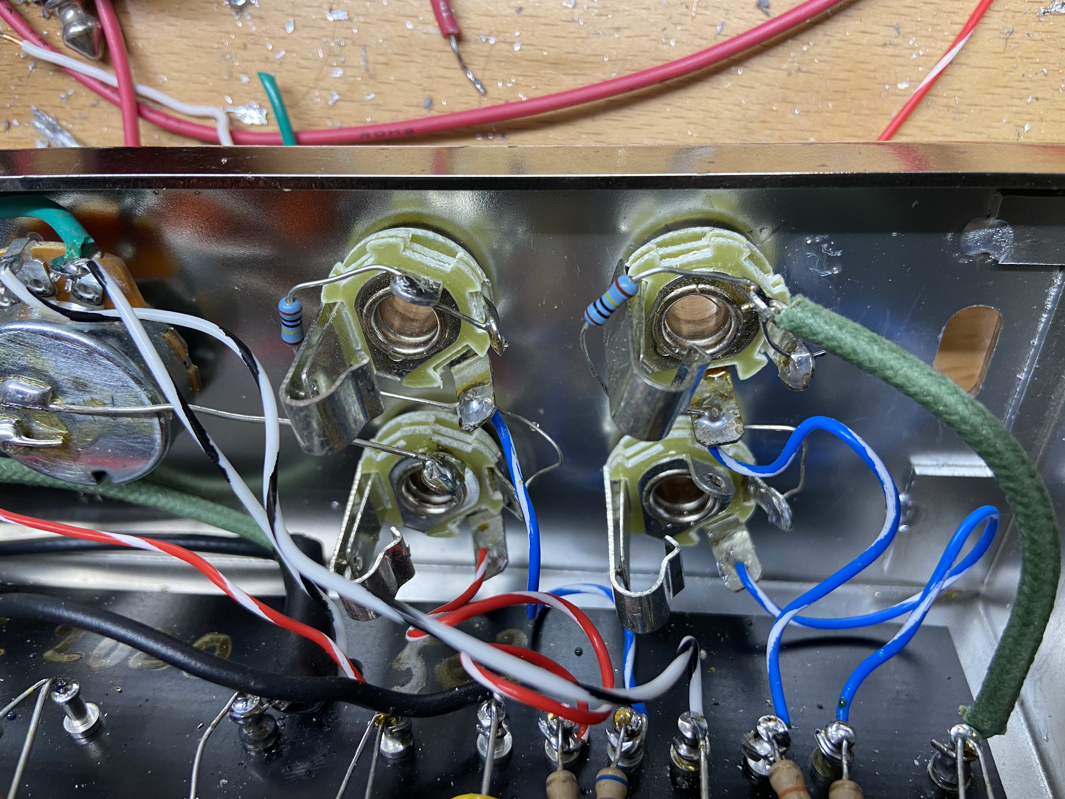

Sorry, I originally added this to my turretboard thread, but I don’t think anyone had a way of knowing it was there. I can't thank you guys enough for helping with those issues. Doug's board soldered easily and powered up working the first time. Doug is the best and I've learned my lesson about other shops.  :worthy1:
I've finally had a chance to play the amp. The tones are great, and holy heck it’s loud! Standard layout but added RobRob’s PrePI MV (wired w/ RG174 grounded at one end) and his 3-way feedback switch.
I have a few problems that feel related to me. Fingers crossed:
There's a really bad hum. Hum is changed by the volume knobs and present on both channels. If I hover my hand about 1” in front of the pots, the hum gets a lot worse. If I touch the chassis the hum gets a little bit quieter. If I tap the chassis with my fingertip, I hear that thud through the speaker. It sounds like 120 cycle hum with the volume at 0. As soon as I turn the knob, it’s a different tone. Almost like static on a TV. That tonal change only happens on the Bright Channel, on the Normal channel it just stays a regular old hum. But loud.
Around volume 3 I think I start to hear a VERY faint and slow oscillation, almost like a Phaser at it's lowest settings. Around volume 7 it sounds like there’s a helicopter in my speaker cabinet. This happens on both channels, and only happens with no instrument connected. If an instrument is connected I can crank it to 10, I still have the loud hum I mentioned before, but no helicopter noises.
Heater CT, PA ground, and HT CT grounds all go to a PT bolt. Power cord ground to it's own PT bolt. Everything else goes to the Preamp Ground. I probably have a couple of leads that are a tad longer than they need to be. I’ll try to shorten them. I could see that causing some hum, but I can’t imagine that causing this extreme hum and oscillation. Tried all new tubes. All the wires are bent around to make sure nothing is touching. I've seen lots of issues where the V1 and V2 wires are touching causing hum, but all mine are airborn and not making contact.
I don’t know if I damaged a component following AES’s advice to use the “highest heat possible.” Not sure what the most likely damaged component would be in that case? Grateful for any advice on where to start looking. I’m assuming it’s ground related based on how it sounds and the position of my body changing things but I’m no expert.

" There's a really bad hum. Hum is changed by the volume knobs and present on both channels. If I hover my hand about 1” in front of the pots, the hum gets a lot worse. If I touch the chassis the hum gets a little bit quieter. If I tap the chassis with my fingertip, I hear that thud through the speaker. :
-choosebronze
Something is not grounded, a ground is missing somewhere.
Good pictures of the amp may help.

Perhaps the shorting contacts on the #1 input jacks aren’t wired up properly?

Do you have a meter  ? Can you check how many ohms you read between input jack external nut and chassis ground.
And to chassis metal
Input jack must be a metal one, not plastic.

Yes, open metal jacks. Resistance from the outer nut are:
To chassis metal: 1.2 ohm
To preamp ground bus: 0.9 - 1.5 ohm (it was different every time I measured)
To power amp/CT/HT ground screw: 0.2 ohm

You should be measuring from the grounded terminal (tab connected to the innermost metal pad on the amp side of the input jack. Its really easy to mess this up on a 5E3 4 input build. Do you have pictures of it?

Measured from the ground terminal of the jacks, all other ground points in the amp, and the chassis itself are all 0-0.5 ohms. Here are some pictures. Some of the solder joints look gooey, but it's reflections from the chassis and overhear light. In person everything is smooth and shiny. I've matched it to the drawings over and over and it looks right to me. I'm off to explore Geofex for a bit.

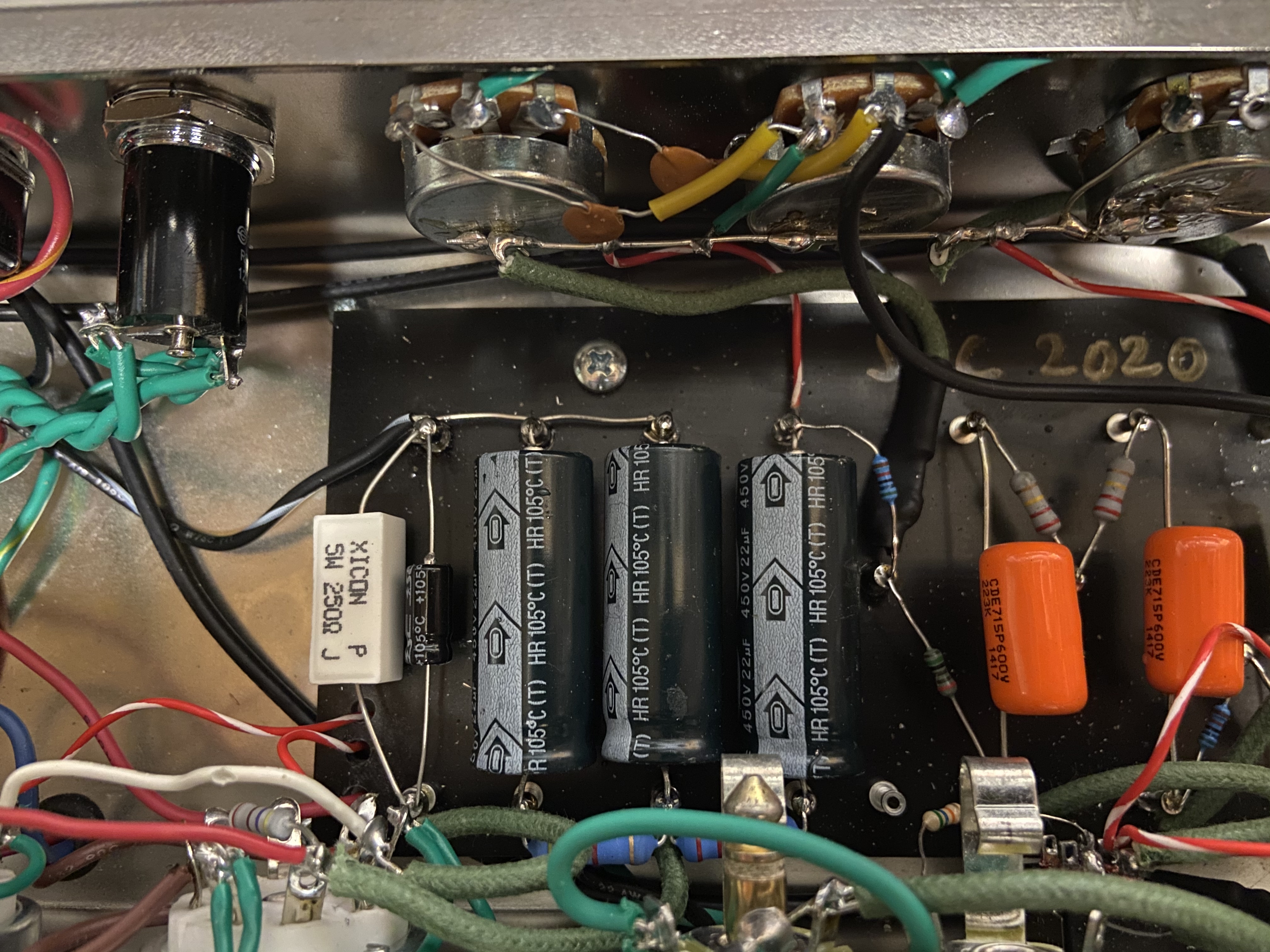

You should make sure that the solders on the ground are also strong; those with body pots for example.
Try to pull them towards you with long nose pliers. They must resist.
Amps building problems always come from only 2 things;
Assembly error or bad welding.

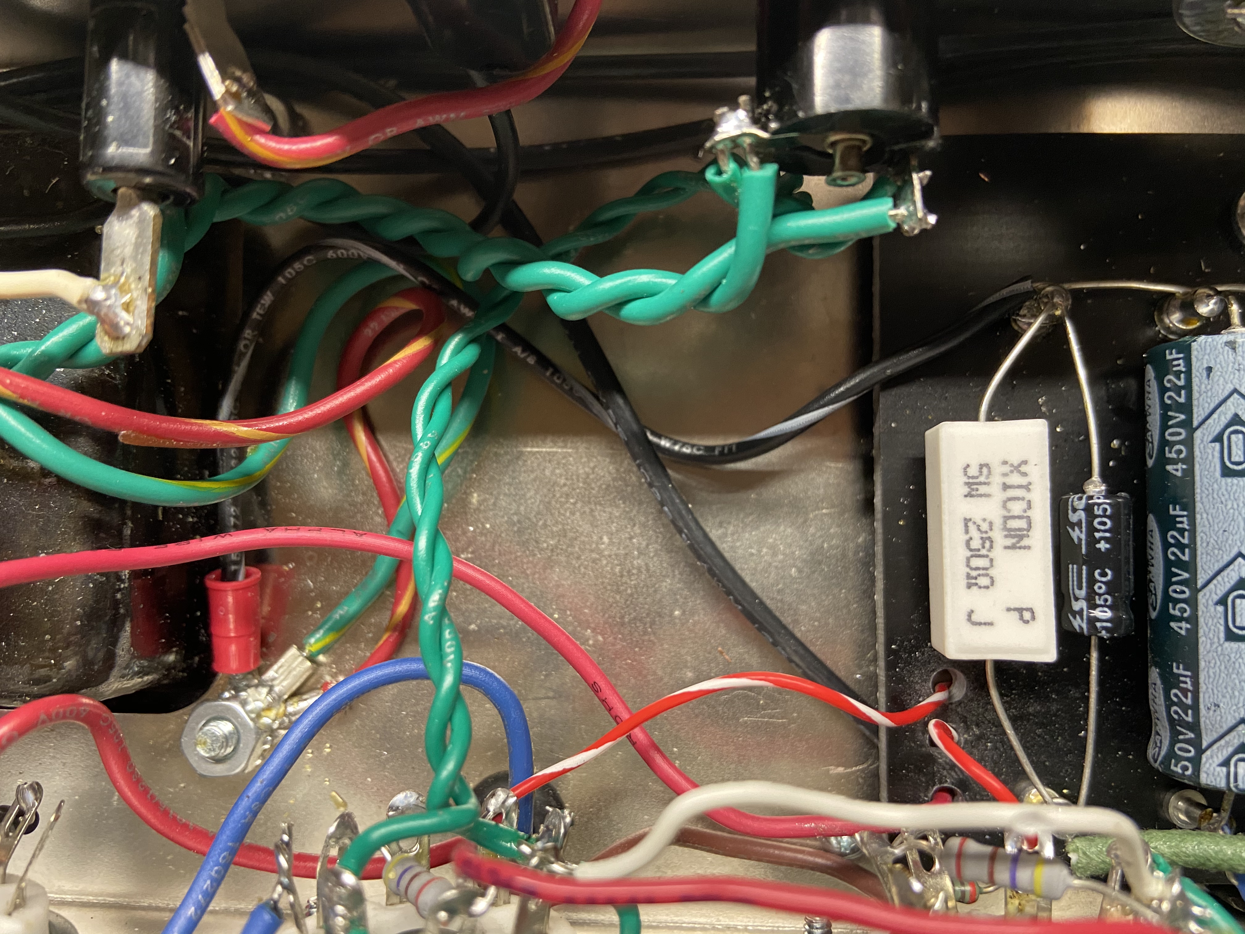

Something else that is unrelated but will be a future problem; many of your wires are too long or badly installed. For example the blue wires coming from input jacks should run along the metal chassis and be as short as possible.
Look at my photo
These wires act like an antenna and will bring noise in amp
Same for all the wires.
The wires that need to cross must do so in 90 degrees. And no parallel wires.
« Last Edit: July 22, 2020, 03:57:13 am by Latole »

Motor boating may come from bad wring dress and /or power supply. Not from filter caps.
Power supply include power supply rail, not only where are the filter caps.

Is this cap polarity is right ?

questions about your layout - see marked-up pic. green wire seems redundant and what's under the heatshrink attached to the green wire?

Thanks Pete. That green wire is the shield ground heatshrinked to RG174 for the MV. Same reason the component you listed is missing. So hidden under that green wire is a run of RG174 that goes to MV lug 1.
The resistor where you put question marks is for his 3-way feedback switch.
Robinettes stuff is used by a lot of people and I consider it to be known-good, but maybe I should undo the mods, go back to the stock Fender circuit, and get that working. Then add the MV and feedback switch back in.
Thanks, I'll tidy up the lead dress. The cap looks right to me.

From the pictures the soldering on the back of the pots looks beaded meaning it doesn't look like its soldered properly. I usually never solder to the back of pots for risk of applying too much heat to the pots and potentially damaging it. And it takes alot of heat to solder well to it. I use a buss but its along the turret board. From there all the grounds are connected to it.
But if you plan on soldering to the back you should reflow the solder between the buss and the pot. Both the contacts (back of pot and buss) should be heated enough for the solder to flow onto it. Never try to transfer the solder from the iron to the contacts to make it stick. Heat the contacts first and apply solder onto the contacts when it gets hot enough. Also tin the iron and apply some solder flux to the contacts to help it flow better.
All the other solder joints look good.
Another thing to mention is the green ground wire at the input. The mechanical connection to the turret is good but it doesn't look soldered.

Dumb mistake... I had the B+ wired to the next lug over, at the second filter cap. I went over the back before installation and then once it was in the chassis I couldn't see it anymore and forgot about it. That's an embarrassing one. The voltages are now appropriate (B+1 367v, B+2 326v, B+3 241v).
That airy noise persists and I think is actually worse now. I'll try another 500p cap once I have one.

Solders and wire dress
Seond that. Lead dress is VERY important.
I never heard about choosebronze about what he do to have a better lead dress. Or I'm  wrong ?
Offline Champ_49
  • Posts: 195
Re: 5e3 New Build Troubleshooting Hum/Oscillation
« Reply #33 on: July 26, 2020, 08:36:15 am »
I don't think so either. Choose bronze, from the looks of it it seems like you rushed your build to get a "working" amp. You really have to take your time when building these. From the pictures your wires are all curled up, too long, the pots and solder on it dont look like its properly soldered and messy, you are now realizing you wired things in wrong.  You REALLY have to take your time with these builds and do everything very carefully. Check and double check. Start in small segments. Do one part first for day 1. For instance day one do heater wiring, day 2 power tubes, etc.  Do each part and do it WELL the FIRST time so you dont have to or at least minimize the "fixing" after.
From the looks of it it just seems like you wanted this thing to magically make great tone by just wiring it up with messy wires and without checking and double checking. Yeah you get sound but you have hum and oscillations.
I would either
1) Gut the whole thing and start over OR
2) clean up your wires, make sure the joints where it connects dont expose too much lead, make sure all solder joints are smooth and shiny, make sure the eyelets holes are covered up with solder, i can go on and on.  Heater wires are pushed up close to the chassis and twisted all the way up to the pins. Make sure the wires are not too long and curled twisted up near the inputs, make mechanical connections to ALL your joints before soldering (the input solid wires look like its just poking through the eyelets).
I suggest you research and read up on how each part of the amp should be wired up such as the heater wires which can be a source of hum.  Go to valve wizard. Look at how you can improve grounding etc.
Now you are just doing a shotgun approach to to fix the issues you are having (changing the tubes for example). It's most likely not the tube's fault it's your lead dress and wiring based on your photos you provided.
Any monkey can just look at a diagram and solder a bunch if wires but if you want a good sounding amp that has no isssues you have to really do this slowly and carefully with much thought, consideration and some research.
The 5e3 is a good place to start a simple enough build but its not simple if you rush everything and think it will just magically have great tone with no issues.
« Last Edit: July 26, 2020, 08:47:42 am by Champ_49 »

Where is your ground bus grounded?
Offline BrassElephant
  • Posts: 18
  • You have no idea how high I can fly
« Reply #35 on: August 04, 2020, 06:02:20 pm »
Try un-soldering the ground buss from the back of the pots. Leave it connected to chassis at only one place. Right now you have multiple circuit ground connections to chassis thru each pot.
