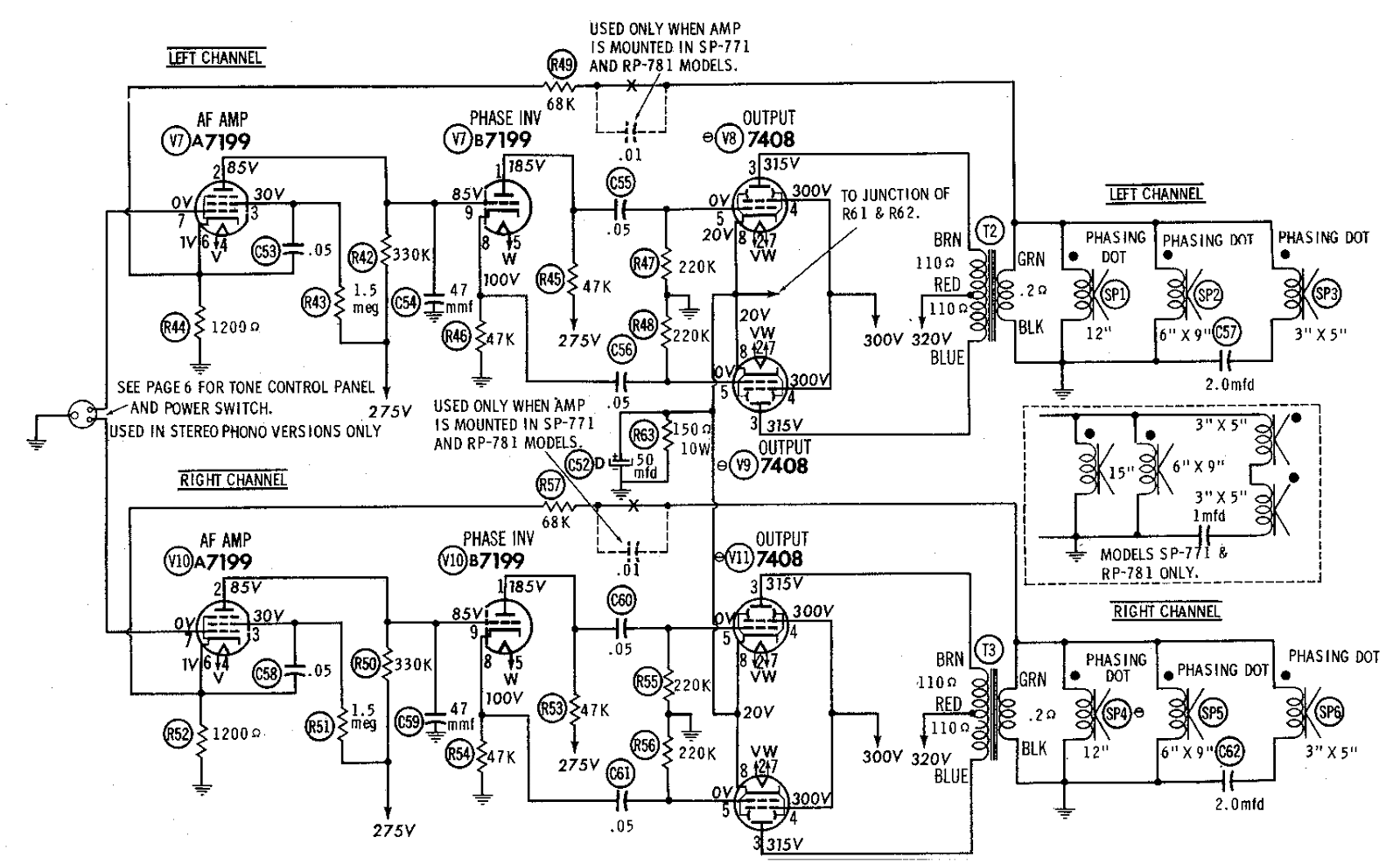

About the speaker ohms: thanks Shooter, and my apologies txtune - I think I gave you bad advice, because I misread the schematic at the link below:
https://1.bp.blogspot.com/-UcEyD24KcAw/Xod0QhIPUjI/AAAAAAAADio/oxWl4JnNprYqR9nZbanNHWbbG-vRfVHygCLcBGAsYHQ/s1600/ASR-120Audio.gif
I saw "2 ohms" noted on the secondary side of each transformer.  But when I took another look after Shooter's post, I now think it may actually say ".2 ohms" with a decimal.  Either way, I see now that it also specifies "110 ohms" on each half of the primary side of the transformers too, so I'm guessing now they were just specifying normal resistance readings for trouble-shooting, so you can test to see if the transformer windings are blown.  In other words, that "2 ohms" or ".2 ohms" I see on the schematic was not specifying the appropriate speaker load, it was telling you what your meter would read for resistance, if the transformer is in good working order.
About the caps in your picture, based on the power supply schematic at the link below, they should work.  You have to install each one in the right part of the circuit, and not mix them up.  But they will work.
Power supply schematic:
https://1.bp.blogspot.com/-lGXMf-1Cew4/Xod0ekJn5DI/AAAAAAAADis/3nMcauGiPVwDt18GE2wM65Lsgw933ql5ACLcBGAsYHQ/s1600/ASR-120Power.gif

C52A – 40/350 will be replaced with 47uF
later you posed the cap spec sheet for the amp showing 450vdc
I just want to be sure there isn't a typo, OR wrong value cap in your "kit" before you learn what an exploding cap looks, smells and sounds like  :icon_biggrin:
I also ordered the larger JJ cap from this site's store. In someways it seems more straightforward to me, as a beginner, to use the JJ. It *seems* like less chance to mess something up as far as wiring, what do you think?

While you are waiting for parts to arrive, there are a few things I'll point out now, that you'll want to come back to later.
The smallest cap from your kit, is marked Nichicon (that is the brand) and 47uf, 100v.  My recommendation (more on this below) would be to use that one regardless of the choice you make above.  The 47uF 100v cap was to be used as the cathode bypass capacitor for the power tubes, and is not part of the power supply filtering we have been talking about so far.  But you might as well replace the old part that corresponds to this one too, while you are replacing the power supply filter capacitors housed in the can.  We can come back to this later, but I'm just bringing it to your attention.  If you go with my recommendation below, you'll want to use this small one, regardless.
Second, if you decide to use the JJ cap, note that it has four capacitor sections: 40uf, 20uf, 20uf, and 20uf, all at 500v, right?  You need three high-voltage caps, with the original being specified as 40uf 450v, 30uf 350v, 15uf 350v.  There is also a 50uf 25v cap specified on the schematic and parts list - that could be replaced with the Nichicon 47uf 100v mentioned above (from your kit).
So my recommendation would be to use your new JJ cap in the following way to best meet the need: wire up two of the 20uf sections in parallel.  This will make your JJ cap have 40uf at 500v (to replace C52A, 40uf 450v on the schematic in the parts list), 20+20 = 40uf at 500v (to replace C52B, 30uf at 350v on the schematic in the parts list), and 20uf at 500v (to replace C52C, 15uf at 350v on the schematic in the parts list).  This will meet or exceed all of the specs of the original power supply filter caps in the can.  Finally, to replace C52D from the parts list, you can use that small Nichicon 47uf 100v, that came in your kit.  That can be handled separately; we can come back to it later.
There are other ways to proceed, but this is my advice right now anyway.

That depends on a few things.  First, for reference, here again is the schematic:
http://www.audiophool.com/Schem_A/S-C_ASR-120_schem.gif
From your pics, the smaller ones that look like striped brown tubes are small-wattage (1/2 watt, I think) carbon composition resistors.  The one with red-red-red-silver is a 2.2k-ohm 1/2 watt resistor, and I think it corresponds to R60 on the schematic.  The two with yellow-purple-brown-silver are each 47-ohm 1/2 watt, corresponding to R61 and R62 on the schematic.  Carbon comp resistors are relatively delicate, compared to other types of resistor formats - they are more prone to damage from overheating, and more prone to simply break from jerking them around by the leads during installation or removal.
The three bigger ones that look like rectangular bricks of cement are higher-wattage cement power resistors.  They tend to be more durable physically, but they also tend to see a lot of power / heat from the circuit, so they can degrade over time regardless (definitely not always, but it happens).  For these, you have a 100-ohm at 10 watts (R58), a 2.2k-ohm at 5 watts (R59) and a 150-ohm at 10 watts (R63).
In all cases, it looks like their wire leads got clipped a bit during removal, as opposed to heating up the connections and working the leads out with pliers.  Both approaches are valid, but if you choose to clip the leads short rather than work the leads out of the connections to preserve the length, it means you might have to replace rather than re-use.  Alternatively, you can extend the shortened leads with new wire that is substantial enough to take the current.
Do you have a meter?  If yes, you can measure the resistance of each.  If they measure within 10%-20% of the specified resistance, they are probably OK from a circuit-functionality standpoint.  But there is still the question of whether the leads are now clipped too short to work with.
If you choose to buy replacements, see above for your parts list.  Remember you need to specify both the resistance (ohms) and the power handling (watts) when ordering.
