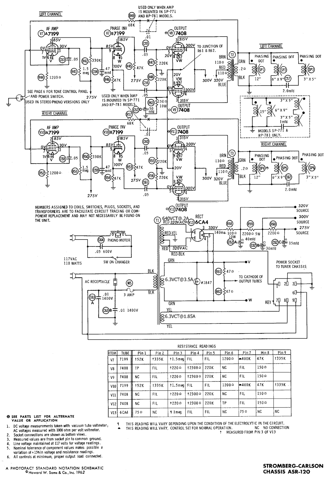

I am trying to find this cap. What exactly am I looking at, circled in red. Thx!
  • Posts: 5377
Re: Cap ID
« Reply #1 on: November 05, 2020, 11:54:07 am »
Looks like you found it already.   :icon_biggrin:
It's a .1µF 400V cap. Any .1µF cap that's rated for 400V (or higher) will work. Plenty to chose from. Just click the capacitors link below this message.

I have the exact same amp as the one in the picture, which I am trying to mod in a similar fashion. The description (that accompanied the photo) was given as a  1uF DC-blocking cap. Being new to all of this, I wanted to make sure I was getting the correct type.
Offline Latole
  • Posts: 2522
Re: Cap ID
« Reply #11 on: November 05, 2020, 02:55:50 pm »
It is not a 1 mfd it is a 0.1 mfd.
 I show you the correct replacement.
Short answer ; a 0.1 mfd 400 volts is same as any a 0.1 mdf 400 volts ( or more volts )

I have a tube power amp from a Stromberg-Carlson ASR-120 Stereo. I am in the process of learning, restoring, and modifying this amp. This is my first attempt working on any real electronics. While searching the internet for information I came across a recent blog of an individual who was working on the exact same amp. The amp he started with was already modified by someone, it was an estate sale find. The author of the blog did describe the cap in question (which was not original equipment) as a ".1uF DC-blocking cap". I posted the picture here and asked for further information.

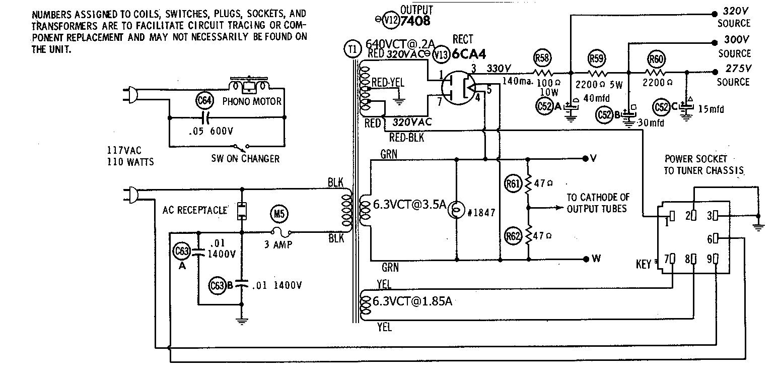

One more question about this. The cap in the picture *appears* to be polarized, but none of the ones I purchased *appear* to be. Am I looking at that correctly?
  • Posts: 5377
Re: Cap ID
« Reply #23 on: November 06, 2020, 01:32:54 pm »
It is not polarized. If you are referring to the black stripe at one end, that simply indicates that lead is connected to the outer foil.

OK, question:  What is the purpose of the cap in question?   Looks like it dumps AC from pin 7 of a tube to ground.
Am I reading this wrong?
  • Posts: 11581
Re: Cap ID
« Reply #26 on: November 06, 2020, 06:41:20 pm »
look at the right side, again
Hint: tab is give-a-way

I googled up some of the info provided throughout the thread: "Stromberg-Carlson ASR-120 Stereo" and ".1 cap" and "mod".  I got several apparently relevant results, including the following:
http://origaminightlamp.blogspot.com/2020/04/stromberg-carlson-asr-120-stereo-tube.html
If you scroll down about 2/3rds of the way through that page, you'll see what's up.  It looks to me like they're caps added as part of the mod.  The mod includes adding RCA-style inputs to the power amp. Since a person could then theoretically connect any audio source "output" to these newly-added RCA "inputs" - even an audio source that also has DC riding along with it's audio output - the DC-blocking caps were added to stop any such DC from getting in.  So the caps are in series with these newly-added inputs (and despite initial appearances, not tied to ground).
It seems likely to me that for the original, unmodified version of this stereo system, DC-blocking caps were present too, but maybe in another chassis housing the preceding preamp stage or stages (like the output of the phono preamp circuit, or whatever preceded this poweramp in the original home-stereo setup).
Cap loog plug to RCA jack
Should I the tabs on the RCA 'inputs' have a wire going to the chassis ground?

  • Posts: 5377
Re: Cap ID
« Reply #33 on: November 08, 2020, 01:54:39 pm »
They are electrically connected to the chassis simply through the mechanical contact with the chassis. Just like a screw and nut are electrically connected to the chassis through the mechanical contact. This is not a difficult concept.

Here is the general, abbreviated idea behind those tabs, why you do not need to connect them to anything to make your amp work as it is currently set up, and some examples of why other amps would need the tab.
The standard method to get audio signals from one place to another, is to use two wires (we can set aside shielded cable for a moment, but the idea is the same there is well).  One wire is "hot", carrying the audio signal, and the other serves as "ground".
In your setup, your RCA jacks each have two connections, inside your amp.  One makes the connection to the wire carrying the audio signal from your source - that connection is the one in the middle of your RCA jack, to which you connected the .1 uF cap. That is how the audio signal from your source gets to the circuitry inside the amp.
The other connection, is to ground.  In this case, the RCA jacks can connect to ground in more than one way.  The method you are currently using, though it was not apparent to you, is through direct contact to your amp chassis.  If you study the RCA jack, the tab, and the amp chassis, you will see that all three are already in contact with one another. So you do not need to make a wire connection from the RCA tab, to your amp chassis / amp ground.  It is already made, through direct contact.  You could make a the connection using a wire, but it would be redundant.
If you had a plastic chassis, or the amp was otherwise set up in a different way, where chassis was not the circuit ground, then you would need to run a wire from that tab, to wherever ground was set up.
Another example where you might need that tab, is for an amp where the amp input grounds are intentionally isolated from direct connection to chassis ground at input, but get connected to ground through an intermediate point later in the circuit.  This is more complicated, and beyond my knowledge to teach effectively, but you can look up "star grounding for guitar amps" or some combo of those keywords using your google machine if you are interested.
So there are times when that tab connection would be needed.  In your case, it is not needed because the ground connection is made through direct contact.

I suggest following up on one of Shooter's questions, before rushing to shop for new or different parts.  I think you might be OK with what you have, but let's verify.
You gave all specs for the original caps, but only some specs for the new caps that came in your kit.  To clarify, you indicated 47uf, 47uf, 22uf, 47uf for the replacement caps.  That is the capacitance of each capacitor in your kit - it means 47 micro farads, 22 micro farads, etc.  Those specs seem fine.
But what about the voltage of each?  Please take a look at each of the caps in your replacement kit, and let us know the voltage on each. In particular, we're curious about the big 47uF caps.
The schematic of the power supply found at the link below, indicates that C52 - the first filter cap after the 6CA4 rectifier tube - normally sees 320 volts DC.  It probably sees more than that at startup, and given today's higher household AC compared to the past, it might see more than that throughout regular use.  So a 350 volt capacitor in that position might be OK, or it might be cutting it a little close.
https://1.bp.blogspot.com/-lGXMf-1Cew4/Xod0ekJn5DI/AAAAAAAADis/3nMcauGiPVwDt18GE2wM65Lsgw933ql5ACLcBGAsYHQ/s1600/ASR-120Power.gif
It would be nice - maybe not even a deal breaker, but nice to know - that the replacement cap for the first position, is at a higher spec than 350 volts.  Please let us know what you see for voltage specs, on the replacement caps themselves.
About stuffing the can versus getting the amp working, I think Shooter means that you could probably get the amp in good working order first using what you have - including replacing these filter caps - before eventually deciding whether you want to stuff new caps into that old can, or shell out the additional possibly unnecessary money to buy an original-spec can.
As we have been discussing, there are several ways to do this right, from a functional standpoint.  But there are choices you can make based on preference.  Among your choices: (1) You can pull the can right out of the chassis, which takes some time and effort, and leaves a hole in the chassis which you probably have to plug up.  Then you can install the new caps, using a few possible approaches.  (2) You can leave the can in place, which gives you the same look from the outside view, up top.  The amp looks the same from the exterior, in other words, because you're leaving the can and it's internal caps, in place.  But then underneath, you install the new caps, using a few possible approaches.  (3) You can do all the work to empty the can, stuff the new caps in, and wire them up.
I like choice 2, myself.  It lets me preserve the amp's original look from the outside, and tends to be less work than the other two options.
You could try choice 2 to see if you get the amp working well.  You already have the parts that should likely work.  Then if you start feeling fussy later and really want to hollow out the can, or shop for a similar can with close to original specs, you could.
I use terminal strips, when implementing option 2.  You mount them under the chassis, often somewhere near the bottom of the can caps you are updating.  Then you can appropriately solder the new caps and existing wiring that went to the can cap, to the new terminal strips you have installed.
Hoffman (sponsor of this forum) sells terminal strips - scan this page:
https://hoffmanamps.com/MyStore/perlshop.cgi?ACTION=enter&template&thispage=BoardBuilding&ORDER_ID=!ORDERID!
Take a look at the 5-terminal options.  Without thinking about it too much, or verifying for sure, I would think if you came up with two of those, you could install the caps in your kit just fine.
« Last Edit: November 08, 2020, 06:41:29 pm by Joel in Texas »

the 1st tap needs to be 450vdc
I know you already spent $$, but your 4 cap can, can be replaced by;
https://hoffmanamps.com/MyStore/perlshop.cgi?ACTION=enter&template&thispage=Capacitors&ORDER_ID=!ORDERID!
look at the JJ can at the bottom.
If you opt for that option, get the clamp
otherwise on that page find a single 47uf 450vdc or more to use for tap A, then use yours for B-D
IN the power supply VDC takes priority over uF

Separate topic, but something to keep in mind.  When I look at the schematic below, it seems this amp is happiest with a 2-ohm speaker load:
https://1.bp.blogspot.com/-E_0PnHJqYQ8/XoZqOM3NCNI/AAAAAAAADg8/Ml04hE7wf8E3Py8O9NTxBheEk3z7Tk4UACLcBGAsYHQ/s1600/ASR-120.gif
After each output transformer (labeled T2 and T3 on the schematic), the diagram shows a 12" speaker and a 6x9" speaker in parallel (we can ignore for now the bass-blocking 2.0 micro farad capacitor in series with the final 3x5" tweeter).  So my guess is, those 12" and 6x9" speakers are each 4-ohm speakers; once in parallel they present a nominal 2-ohm load to the transformers.
You mentioned testing with some bookshelf speakers.  Take a look at the back - does it say they are 8-ohms?  If yes, you might consider figuring out a way to get together a 2-ohm speaker load, or even 4-ohm which would probably be OK.  For example, you could wire up two 4-ohm speakers in parallel to get 2 ohms, or two 8-ohmers to get 4 ohms.  If you have to continue testing with 8-ohm speakers, it might be alright but I recommend testing at low volume; don't go crazy cranking the volume with a speaker load mis-matched by 4 times the original spec.
Finally, as you may have heard, you should not feed a tube amp a signal, without speakers connected.  That is bad news.
