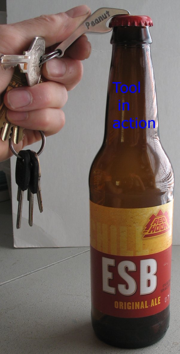

 I'm glad to see you have your priorities straight in making useful tools. :D
http://www.el34world.com/Misc/Cnc/images/IMG_0623.jpg
 [smiley=gluck.gif]
Regards,
Dyna
« Last Edit: January 30, 2008, 12:24:02 am by Dynaflow »
  • Posts: 10672
Re: Making a new CNC machine
« Reply #3 on: January 30, 2008, 05:55:18 am »
Yes, the beer tool, maybe the best tool in the shop.
That one was for my girlfriend, it has her nickname on it.
Mine has a very tiny engraving of a bicycle.

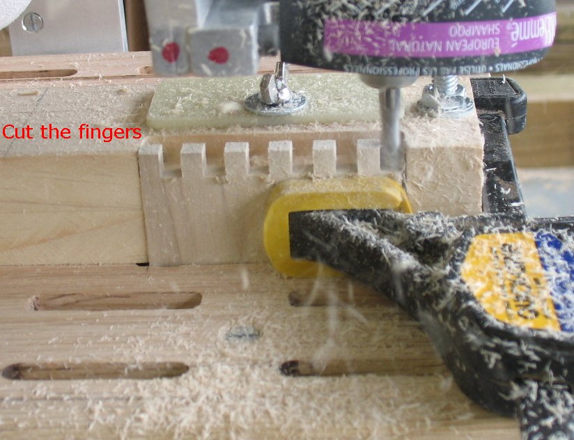

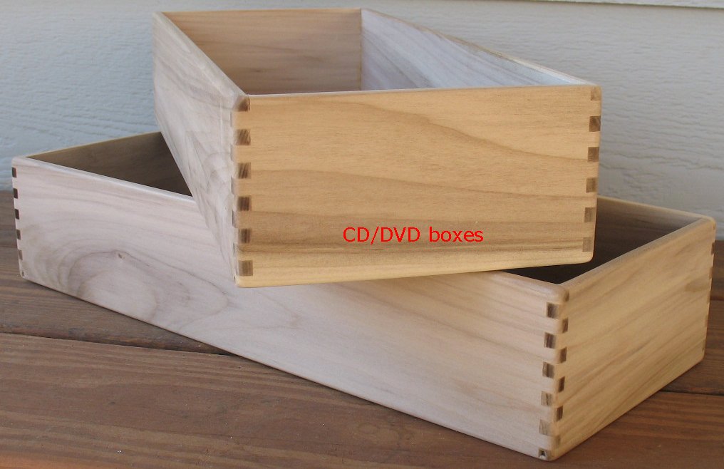

« Reply #13 on: February 21, 2008, 07:45:53 am »
No music yet, just a loud whine that is muffled through ear plugs.
I made a finger joint jig for the CNC and made a couple CD/DVD boxes.
http://www.el34world.com/Misc/Cnc/CNCproject5.htm
